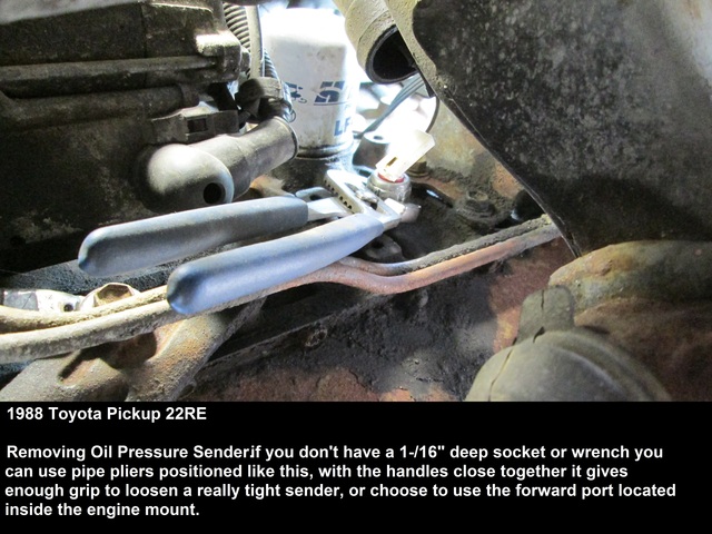

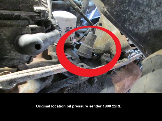

Original oil pressure switch on the 88 22RE is located on the right side of the engine below the oil
filter, it interrupts the ground which shuts off the dash light, if your installing a mechanical guage
you'll need a "T" fitting if you choose to keep the dash light operational.

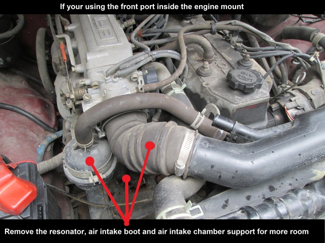

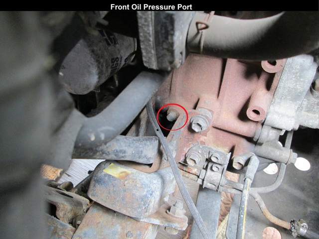

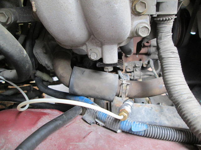

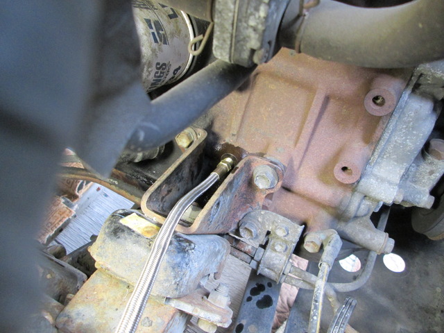

If your using the rear port under the oil filter
