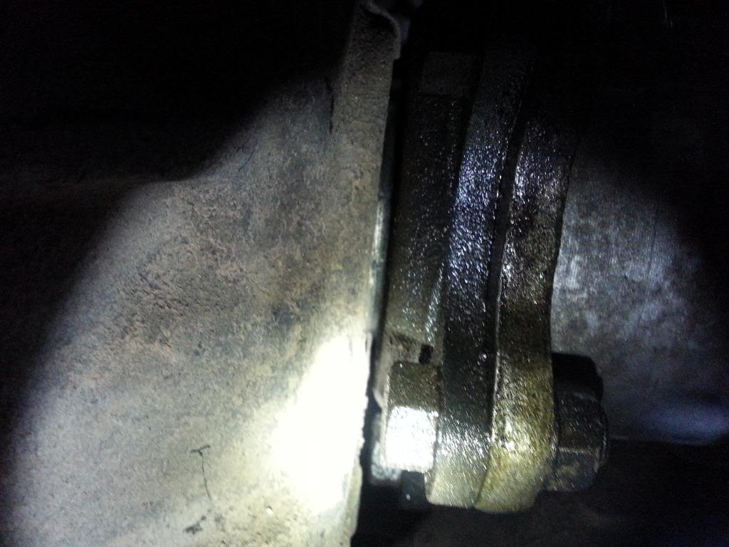

1990 4runner 3.0 auto
leak at connection between front diff and passenger side cv axle
I have been trying to figure this out for a while, I am not sure what can be leaking in that area, maybe a leak from about it and the fluid just like to collect there.
It looks a little greenish, texture of oil, not a specific odor. I have toyota red coolant.
Thanks for the help. Here are some pics:

It could be the side oil seal http://personal.utulsa.edu/~nathan-b...le/22repla.pdf but even in your picture it doesn't look like SAE 75W90. So I'd go with your first idea; it's coolant leaking from somewhere else.
So get it sparkling clean (use spray degreaser, a garden hose, and brush), roll it around a bit, and look carefully.

That would be your inner diff axle seal leaking. I have the same problem marlin crawler has the seals ive got two from him sitting oj my shop I need to replace the same one as you passenger side. Just gotta undo the Cv n pop out the shaft from the diff held in by a cclip n change seal.

Just out of curiosity, what do plan to do for SST 09554–14010? I've never tried this replacement, but it doesn't look like you could fake it with a big socket.

Do you happen to have a link? There is a lot of stuff on Marlin crawler and is a bit overwhelming at times haha.
So that goes in the area between where the axel bolts up to the diff?
