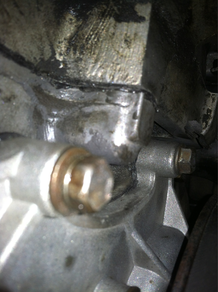

Oh and don't forget the lil nub that sticks out of the front timing cover at the top these are known to crack on each side of the nub it the bolt trough the head into the timing cover was over tightened during pulling a head or pulling the timing cover.i found mine cracked so I ground it out with a dremel tool and jb welded it as others have done With theirs and so far it's held up fine no oil leaks.you would be surprised how much oil can leak out of there had oil from the front of the block all the way to the back a few months after degreasing it.a little inspection mirror makes it easy to see if its cracked pretty hard to see without one .it also helps to spray the area down with brake cleaner since the recessed area is hard to get at with degreaser

Here's the area I was talking about on each side off this nub I don't have a pic of the crack just the jb welded spot .i know it's still dirty but too cold here for a serious degreasing.but as you can tell in the 2nd pic it is pretty clean

It very well could be your 1/2 moon plug in the front.I replace my 1/2 moon and valve cover gasket then degreased my engine and it was a grease ball again in 2 months and my alternator was soaked again.But i replaced my dist. o-ring the same time I repaired the nub that was cracked so I cant say for sure which one was soaking the alternator.hopefully you can figure it out for everyone.Oh and there wasn't anything special about the dist o-ring it could be matched up at a local hardware store instead of the dealer if the dealer is too far away for you.
