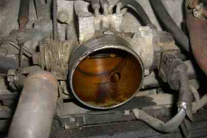

just took the air cleaner off my 3.0 and found quite abit of oil in the bottom chamber. not sure whats going on.
Attached Thumbnails oil in the air cleaner-cimg5726a.jpg   oil in the air cleaner-cimg5723a.jpg

Could be blow by, thus letting oil into intake as well as pressure.

Its often pretty dirty behind the plenum. Have you ever rolled the truck? When upside-down, oil can gravity drain into the intake. Check your PCV valve, see if it rattles, if not, it could be stuck open.

if the PCV valve is plugged, it's possible for blowby to find it's way into the air cleaner area

if the PCV valve is plugged, the oil mist may travel through the fresh air hose into the throttle body or air filter housing (depending on where the fresh air into the valve cover is sourced from) then run down through the duct or other path to the filter
for instance, on a 22re, there is the hose from the plenum which the PCV valve is connected to and then there is a second hose (early 22re's had it in front of the throttle plates, later 22re's have it from the plenum) which allows filtered air into the valve cover to replace air drawn out throuth the PCV valve. if the valve plugs, positive pressure could blow oil up the other hose.
I'm not sure of the hose routing on the v6 though, but I've seen other engines that supply fresh air to the crankcase system directly after the air filter.

On the 3.0, the PCV has a hose that goes to the plenum right above it.
It's the "U" shaped hose here.
On my friends 5.0 bronco, the hose ran to the other side of the air filter, so as air came in, the oil would ruin his air filter.

the PCV valve may be on the U shaped hose, but there should be another hose from a valve cover to the intake somewhere.
