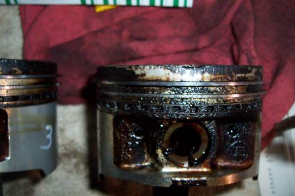

Here's what it looks like:
I had 160psi + on every cylinder, but a terrible case of blow by. It was offensive. And.....no smoke on start up or during operation.

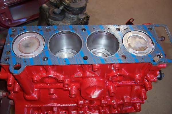

Here's a genuine Fel-pro headgasket:
If you look closely enough, you can see the metal around the oil and coolant passages. Not nearly $40, either. It's not entirely necessary for the metal rings to be as heavy duty around anything but the cylinders. They see a lot of heavy compression and combustion. However, if I'd had the budget, I would have gone OEM, too.
I'm inclined to believe a lot of headgasket failures may be due to insufficient and unequal clamping force. I really had to work at getting the HB threads in the block to come clean and smooth. I don't how many people or mechanics would go to that much trouble.

I think that the gasket was a Fel-pro, because there was blue crap all over the block surface. After a google seach, I found a PCV valve called the "EN-Valve" that claims all sorts of stuff. Has anyone heard anything about this?? It sounds legit, but afterall, it's off of the net.
