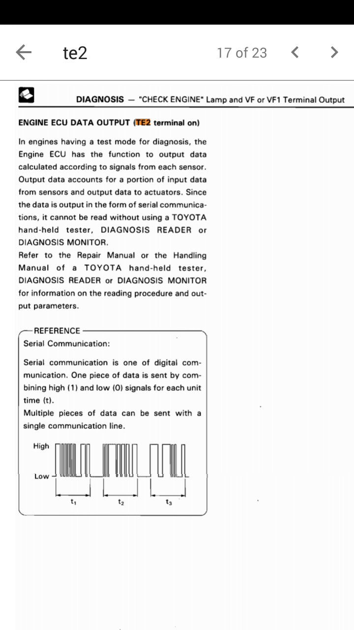

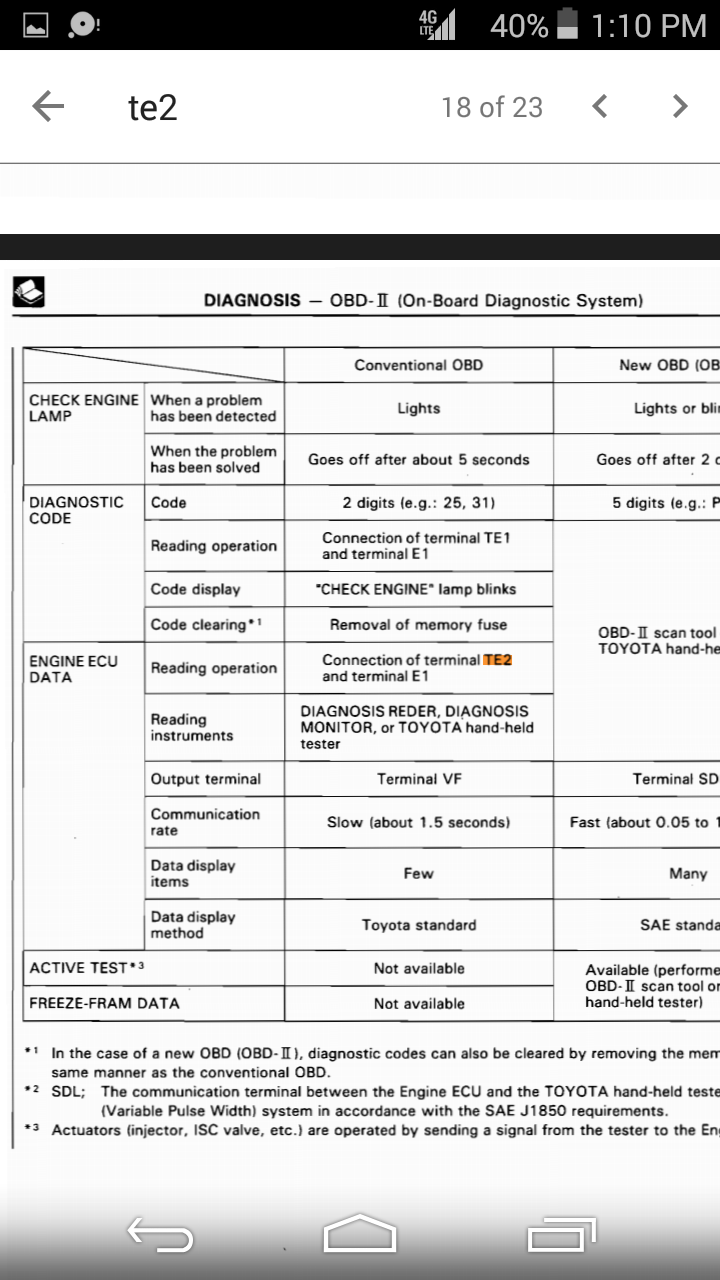

You could force open loop by putting a fixed resistor in the engine coolant temperature senders place.
You could force limp mode, or at least fixed valve VTA, by unplugging the throttle sensor.
There are also TE1 and TE2 which are used in some of the drive mode tests. Without digging through the FSM and TCCS hand book I don't recall which is for what tests off hand.
What ever happened with your ox sensor tests? Is it possible these plugs/signals got reversed such that your pre-cat sensor is sending to post catalytic? This will make the ECU max out its adjustment for fuel and not store a code because the engine stops abruptly I think.

Not a lot of details, maybe it's helpful.

Superb, I could not find that on my Service Manual.
I screen copy and will do right now, was ready to give up.
Thanks a lot.

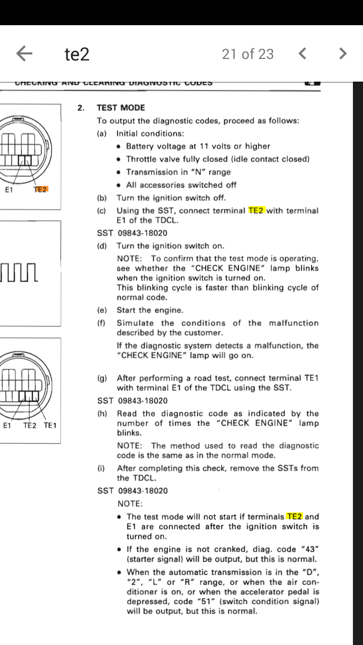

Thanks CO_94_PU; I tried one trip with that yesterday and but the time I quit did not get any MIL light. SO I figure it may take at least two trip for it to show up.
Early this morning i m taking advantage that it runs well while cold and take across the street to his owner. There I will run a couple more trips but it will be on his driveway and if no results i am giving up.

Today, a sad day, the car is going across the street and he will try to sale it on Craigslist. On more test I will do is the "Test Mode" as suggested by someone yesterday I cannot remember where. Using T2 and E1 jumped for enhanced diagnostics. I did one run yesterday and as always the engine run well, no misses, no lights. But It may take more than one "Trip" to pop up the light.
