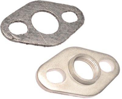

THis is for a Celica, but as long as the hole size is the same, it should be pretty easy to ad it to the exhaust you have now.
You have 2 O2 sensors because you truck has the CALI emissions. I dont know about getting rid of the second one.
http://www.carparts.com/details/Toyo...FS1p7Aod7mgAGA
That looks like it might work, but I wonder if it can be welded to a curved exhaust pipe or not.

Well, I just cut the old o2 sensor and mount off the tail pipe with my cutting torch. I've removed the tailpipe steel from the flange with a chisel and will then grind the edge, drill a hole in the new pipe and weld it on. Hopefully I didn't hurt the o2 sensor none when I cut it off. Why is it that some of the easiest jobs always turn out to be difficult?

Well, I tested the o2 sensor with my volt meter and it tested good so I welded it on and now ready to install. I feel better keeping it on since I have found that one thing is usually tied to another. Pull a link out and the chain falls apart.
