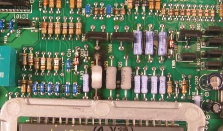

Same problem here. I have a '93 pickup, 22RE 2x4 CA emissions, and after years of frustration getting it past smog I decided to do something about the CEL that just wouldn't die last weekend. Ran the diagnostics for the O2 sensors and they were operating as they should but still had the code 21. After reading this post I decided to pull the ECU and have a look:
So here's my question: Does anyone know the rating of my blown resistor? The other two resistors appear to be 0.43 and 0.15 ohms (I believe the 'K' indicates the rating tolerance); and since they are both different ratings It's kind of a crapshoot as to what the blown resistor's real rating is.
Thanks!

1. I don't know the resistance of your resistor
2. I can't see much from your photo, but just because a resistor looks "toasted" does NOT mean it is toast. These are power resistors; they are supposed to be very warm. What do you get when you put an ohmmeter on it?
3. I really doubt you have a "0.43" or a "0.15" ohm resistor. (And you won't be able to measure that with any ordinary ohmmeter). You might have a 0.43K (430ohm) resistor, but I've never seen one marked that way. But: see #1.

Man I love this site. @scope: exactly the kind of direction I needed given that I know very little about electronics. Here's a pic of the new module:
Plugged it in and it worked like a champ. I spent years dealing with this problem and it only took an $80 used part and a few minutes to fix it!
