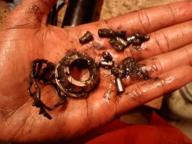

Afternoon of wheeling crippled my rig for 4 days. I never payed much attention to my steering stops when i sas'd so the knuckle was stopping by it's own accord.. ie the inside of the rear of the knuckle was hitting the back of the ball on the axle. How much more stress this put on the trunion bearings? I'm not exactly sure but couldnt be good =)..
But ultimately the upper bearing cap nuts came loose... I re-used the original lock washers which were mistakened for.. that.. washers. they were FLAT.. which the bottom cap used washers not lock washers.. rookie SAS mistake.
Thats a Trail-Gear chinese trunion bearing, BOOM.
The hi-steer arm suffered damage as well but not life ending (phew!) .. I would like Marlins 25mm bearing and arm upgrades tho! .. $400 bones tho ouch
New SKF bearings installed, Pass side bearings are fine, and all new lock washers and loc tite applied with 80ft lbs of torque (yea 72 is spec)
NOTE* The TG trunion vs the SKF .. sorry no picture... the difference in the bearings is NIGHT AND DAY. I'm curious what a real OEM trunion looks like (didnt toyota use Koyo?) ... But the TG had a much steeper grade and many smaller roller bearings.. vs the SKF which have a very STEEP grade almost vertical bearing to race... with like HALF the bearings which were all 2-3x as large.
To me this seems stronger for a bearing that only acts as a hinge and doesnt actually ever spin.

Sorry for your misfortune as those are not fun to fix.
Yet it seems hard to blame the bearing for improper installation and setup. I have mic'd OEM bearings side by side to TG bearings, trunnion, wheel, all of them I have used, and not one is different or out of spec.
No bearing would survive improper install and setup.
Sold hundreds of these bearings and I have seen them run in dozens of vehicles from street queens to hard core competition rigs and I have not noted one single failure in a properly installed bearing.
Trunnion bearings suffer damage from improperly torqued steering arms or not rechecking them between wheeling trips, or improperly set steering stops.
At least it wasn't too expensive of a lesson.
Good luck with getting it fixed.
Both of which were in my case =)
Screwed at least halfway out.
Well, that's a bit to vague. Im my case my axle "stops" the triangulated metal tabs off the axle that the screws actually hit were bent in.. like punched in, the PO of the axle had hit them pretty dang hard! I reinforced them ie capped all the stops.. but in my case you need to unscrew them out real far.
So in other words, screw them out so that the knuckle isnt stopping itself (the knuckle turning so far its hitting the ball) .. which bent two of the small knuckle felt bolts which i had to replace since they were contacting the axle housing!
Good times =)
its all fixed now.
