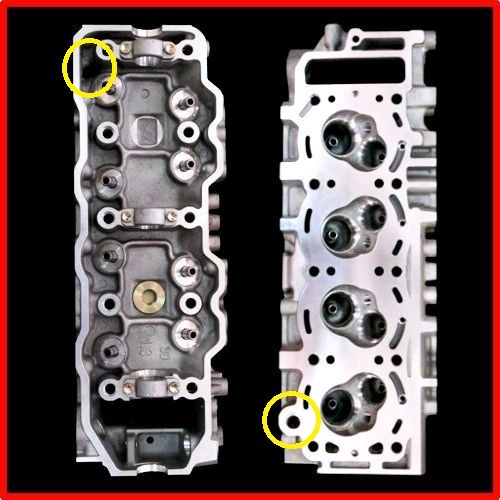

In this pic below the area circled in yellow is where the oil ENTERS the top end and then drains down the front over the timing chain...
AM I correct or is it the other way around??

No oil does not enter there. Oil enters through the hole circled in red on passenger front side of engine. The hole in the rear is your drain.
Oil runs through this port and through the front of rocker arm assembly. Did you happen to disassemble rocker shaft assembly during rebuild?
Could be stopped up depending on water mixing with oil (sludge) you have ports that run through assembly and if stopped up will not allow oil

tj884Rdlx- Thanks for the pic it all makes better sense now.
87hoerunner- Had the head decked and both the head rocker assembly hot tanked but I didn't disassemble the rocker assembly...DAMN!! I bet it is plugged. Gonna tear that down first then replace the oil pump with an OEM pump. The ENGNBLDR oil pump just doesn't look like a high quality piece to me. I would have peace of mind knowing I had an OEM pump.

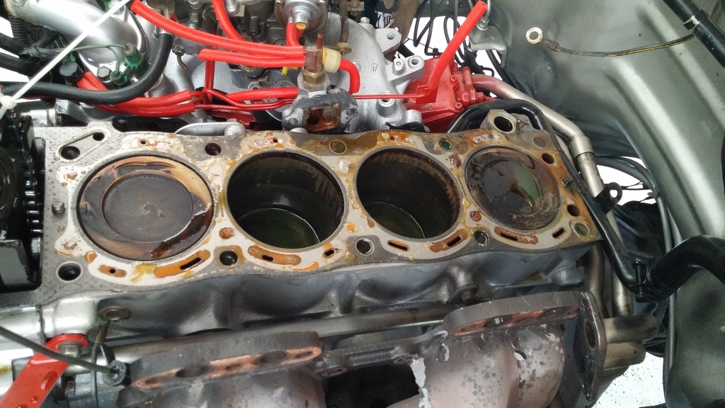

First Day off in 7 days.
Removed the head bolts to remove rocker arm assembly.
Head Gasket will need to be replaced as coolant and a little oil is on the garage floor.
Rocker Assembly Rails are clean but the tiny holes in the arms and rails must be plugged.
Looks like this is gonna take a little while longer than expected as the head needs to be pulled so I can put in a new gasket.

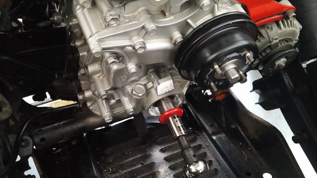

Ok guys gonna turn the oil pump by hand and see if she sucks and pushes oil up through the little hole next to the front passenger side head bolt slot.
That is about the only way I can figure out to check to see if the oil pump is working.

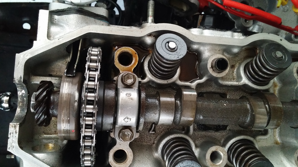

So I finally got the crankshaft pully off and checked the pressure relief valve all looked well there.
put the head back on and bolted the camshaft and top gear together.
Even took off the oil pump seal to see if I had placed the gear on correctly..I DID.
I started cranking the crankshaft by hand and oil came thru the hole where the oil filter goes.
Put the oil filter back on.
Started cranking again without pausing just kept cranking that sucker.
Oil finally came up thru the head so WE ARE GOOD THERE!!
Looks like my mistake was not taking apart the rocker arm assembly and cleaning it all out very carefully and very thoroughly when I had it all taken apart the first time for the head gasket job.
I assumed it was gonna be clean enough since it was hot tanked with the head but I guess not...
LESSON LEARNED >>> DO IT THE RIGHT WAY THE FIRST TIME BY NOT RUSHING!!
