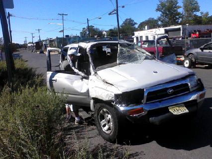

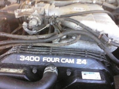

Looks like I'll be picking this up for the cost of salvage/storage. Time to start reading up.

This is one of my favorite threads man nice work on everything Can't wait to see what happens with the 3.4

Might not be happening. Sounds like he might have sold it out from under me. From what I heard he beat on his vehicles anyway so it could be a tired engine. Also from my research going from the 22re to the 3.4 is a lot more parts and work needed than from the 3.0 to 3.4. Dunno might still happen.

damn dude that sucks, but im not really partial to the 3.0 or the 3.4, My runner is running the 3.0 and its at 200k. As soon as the hg gives up or anything on it Im gonna start looking for the 1uzfe. That in my opinion is the ideal motor
