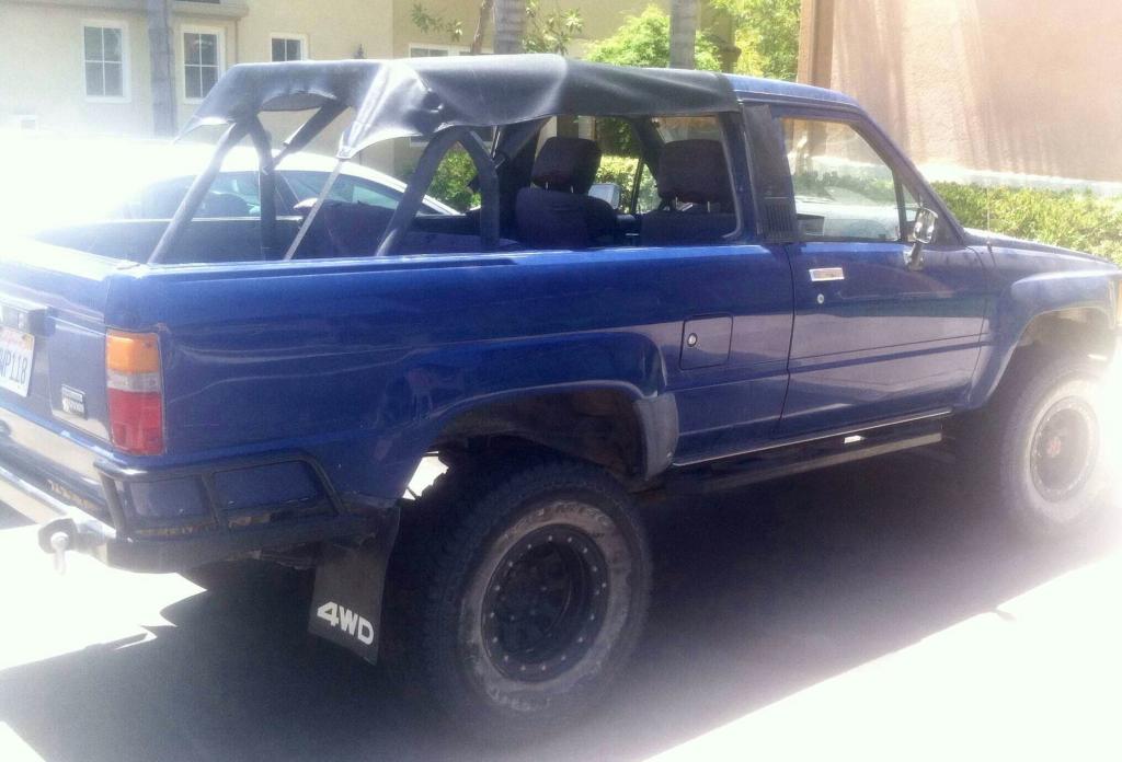

I decided to take a chance and went with 125lb 13" springs to level out my sunken booty. Here is what my truck looked like before:
I did the super easy install with rented spring compressors from autozone (free).

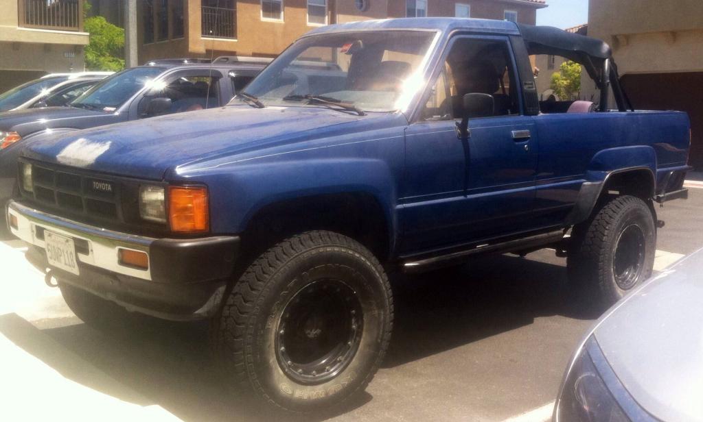

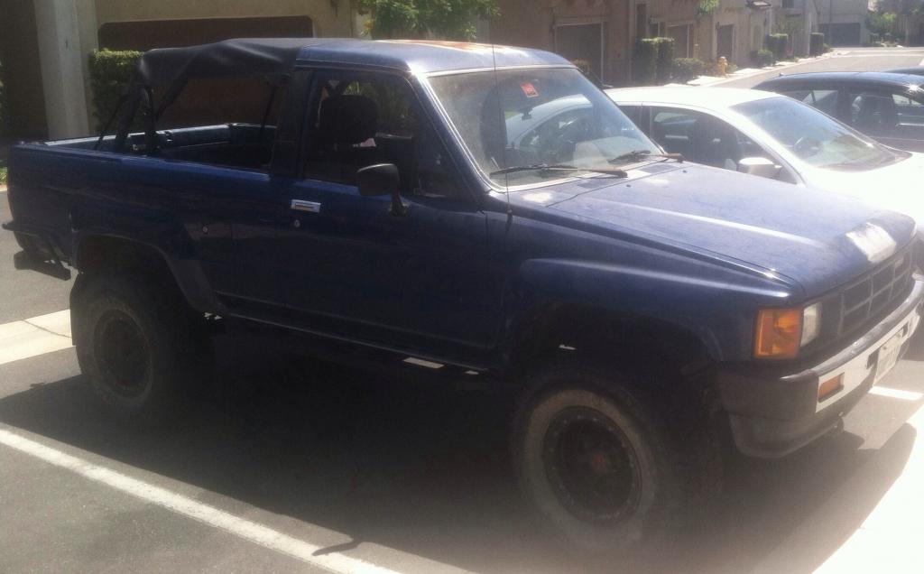

Here's the truck after the install. I didn't do exact measurements but it is about a quarter inch higher than the front and looks great now. I don't know how flex is because my truck is living in the garage while I work on it this summer.

The ride is waaaay better and now it is level with the front. I don't know how much rear lift I'll lose when I put the top back on but well see!!
