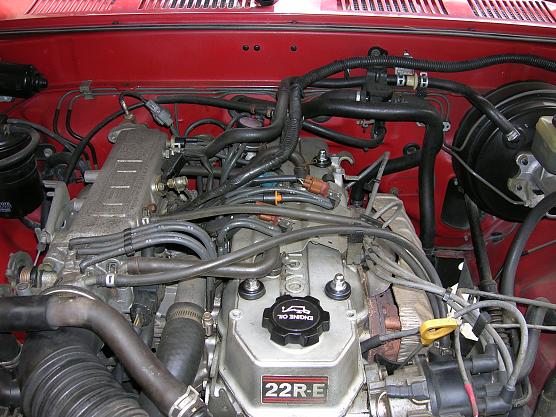

also i got another question, while i was looking for the sending unit i noticed a wire that was not connected to anything, i could not find what it might plug into here are some pictures of it.
can anyone tell me where this wire plugs into?

The plug is for the knock sensor, IIRC.
You have 3 coolant temp sensors: one on top of the manifold, between #2 and #3 intake runners and two at the front of the intake manifold- one with a green plug and one with a black plug (IIRC) (actually right above the orphaned plug in your last photo). One is the cold start injector time switch (black plug, controls when the cold start injector operates when starting the vehicle) and the other is the ECU's coolant temp sensor (green plug IIRC).

ok so what does the knock sensor IIRC do? since it is not plugged in would that make a difference in the way the engine runs?
The thing is i dont know where it should be plugged into, i looked around for a while and couldnt find a home for it.

If you had a knock sensor, it would be plugged in. It would be a sensor on that side of the engine. What it does is "listen" to the engine and cause the ECU to alter the ignition timing if it "hears" detonation or pinging.

hmm i thought that it was.. sorry for the wrong info. my 91 doesnt have ac either and i have that same wire not plugged in to anything.
abe, so your saying he doesnt have a knock sensor? is it a model/year thing? im confused lol.

I'm confused too. Neither Sin91's 91 truck nor my 88 4Runner have the knock sensor, and we're both Cali trucks.....
I'd have to look to make sure that connector is not for the a/c compressor (I have a/c on my 88)....

i think it is the ac connector, and im pretty sure that my 91 has a KS but im not sure(cant remember). i know this guy has one https://www.yotatech.com/forums/f120...e-nuts-183199/
and they list them for all efi years

I'm fairly certain its just a "random" plug you found. I remember when I went looking through the engine compartment in my truck and there were 5 or 6 plugs that didnt go anywhere.
That thing is CLEAN :O. I bought my '93 in '05 with 87K original and already had the metal timing chain guides done heh.I'm fairly certain its just a "random" plug you found. I remember when I went looking through the engine compartment in my truck and there were 5 or 6 plugs that didnt go anywhere.

ive kinda come to the conclusion that it is probably a random plug also, it seems like ive looked everywhere and cant find a home for it.
