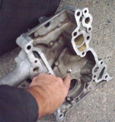

did you replace the bolts correctly ? this bolt goes directly threw the cover , and will contact the chain tensioner stopping it from doing its job

I thought the same thing that the metal guides do make at least a different sound than plastic ones
After removing the timing cover for the 6th time getting to a no leak place.
I think, I know all the right length bolts were in the right spot, and put some fipg over the end of the bolt inside the cover to keep it from seeping oil... good info though and I could see how that could happen
Maybe I'm just super/ hyper sensitive and hearing stuff that it's always made but, I'm just now hearing it... heck I'm so old in thankful I can still hear.
