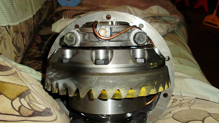

so I was just dropping my new arb TG third in the rear and it wont fit on the sides where the air plumbing wraps around. TG is closed right now so I cant call, but Im wondering if they fit tight...should I hammer on it? its a v6 on a 94, the inspection tag on the unit says v6 and pattern fit checked so Im not sure what the deal is. isnt the 4 cyc the one that is smaller, so its not like i could have been sent the wrong one because then it would be too small right??
anybody familiar with trail gear thirds have any thoughts...this sas has already seen way too many setbacks.

it seems like there is no where to bend it out of the way, and even if I did I dont even know if it would do anything.
Im going to try an upload some pics.

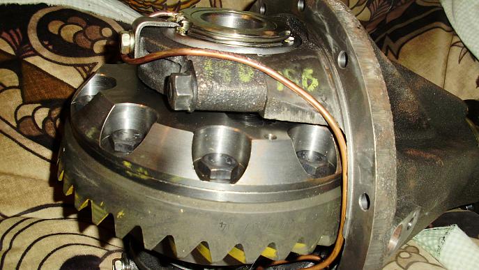

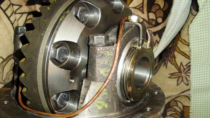

I still havnt got the learn on how to get these pics on here from flicker but here are the links
http://www.flickr.com/photos/38148500@N05/3512182346/
http://www.flickr.com/photos/38148500@N05/3512182790/
http://www.flickr.com/photos/38148500@N05/3512183164/
Attached Thumbnails new TG rear 3rd wont fit!!! is it tight?-p4250144.jpg   new TG rear 3rd wont fit!!! is it tight?-p4250145.jpg   new TG rear 3rd wont fit!!! is it tight?-p4250146.jpg

maybe take a round file to the housing to remove some of the interference? It doesn't look like you'd have to remove much and there's still plenty of surface to seal . . .

Does it seem like its hanging up on the air line? corax is on to somthing with the filing on the housing to make clearance for the air line I would not mess with the air line itself.
When I attempt to roll in my 4cyl 529's it is very tight fit through the gap in the housing where the ring gear passes threw and takes a little rocking of the pinion flange to find the sweet spot before it will drop in.

as i looked a little closer at my unit and where it was scraping, it seems like the cap that bolts the adjustable rings down sits out too much. I dont remember the names of these parts...cap and thrust washer? first time Ive fiddled around with the thirds so that why im asking about all this.
I think a little grinding on the housing might help, but it might need more than a little. the gears fit through fine.

I can see what your talking about by looking at the picture the air bearing assembly sticks way out. typically the adjuster wheels are flush, but you have a retainer clip and teh air bearing to add on to the mess.
Not sure what to do for you on that one
seems if clearance the housing could be needed you would get some sort of literature on that procedure.
