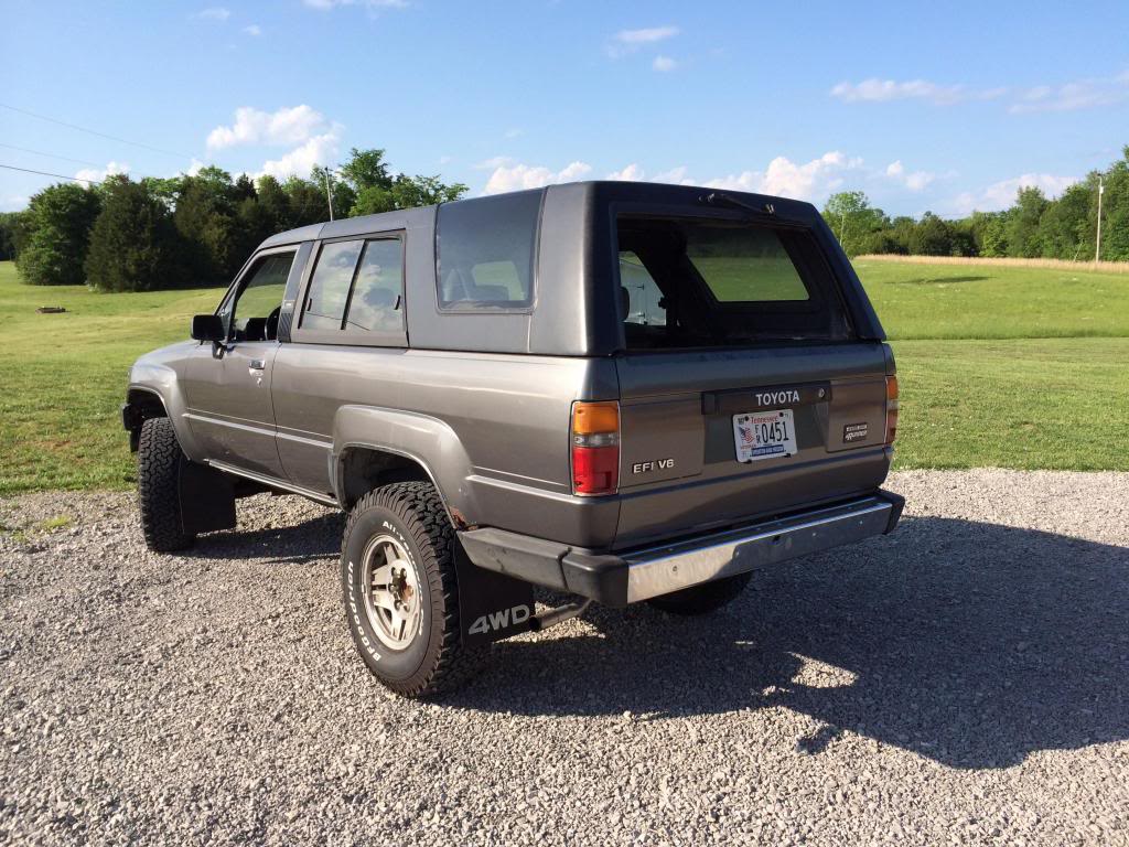

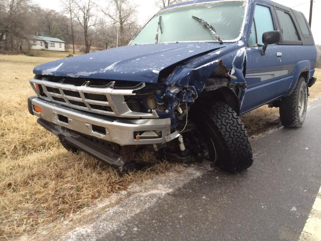

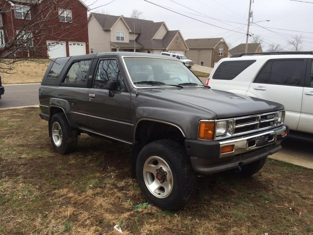

I lost my current 86 4runner in a head on collision with a vw jetta on Monday during ice storm. Last month I rebuilt the 22re, installed new clutch and complete brand new exhaust. Due to the fact that it was totaled out before and this time is not covered I have chosen to find a good doner vehicle for the engine, trans, and all. I also have a complete sr5 interior that's in great shape too so I don't want that to go to waste. I found a 89 v6 auto in great shape for 1100. The engine had low compression and was taken out and torn down. I plan on removing the trans, tcase, wire harness, computer, and all other unneeded items and swapping the good stuff out of my wrecked 4runner. I know I have to cut the motor mounts off the frame and swap them to the v 6 frame but that's not a big deal to me. I should be able to come out of this with a pretty good truck with all the stuff I want on it.

11 hun???
like to find one that nice for that price too.
i'd sell the other engine and do a 3.4 swap.
looks sharp

Well I finally got the truck put together the way I want it and I love what I ended up with. I did have to do way more than I initially thought I would. Cutting out and swapping the motor mounts on the frame was pretty easy. I had to swap every bit of the wiring harness except for the tail gate harness as it was the same. I also had no idea how much of a pain to swap fuel lines would be but once I realized how easy the body bolts came out I just lifted the right side up and got the line off. I took it for its first road test and everything seems to be good except for a few small issues. All in all I'm pretty happy to have a drivable 4runner again. Here's a few pics of finished project. I still have to wash her up and clean interior good.
