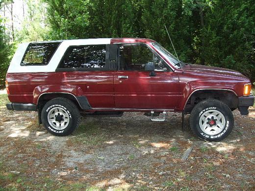

Hey Guys,
Here's a pic of my newly acquired '87 4Runner from my in-laws divorce!
Have a transmission problem that has just started. I have a four speed auto tranny that on cold mornings or cold nights when I start to drive it, it wants to stay in third gear a long time and wind out; finally, it will change into fourth and everything's fine. After this, any time I stop, cut it off and start it up to drive again, it shifts fine. I changed the tranny fluid and filter after it started doing this. Drove it today; it was warmer and had no problem. Anyone have any suggestions?
