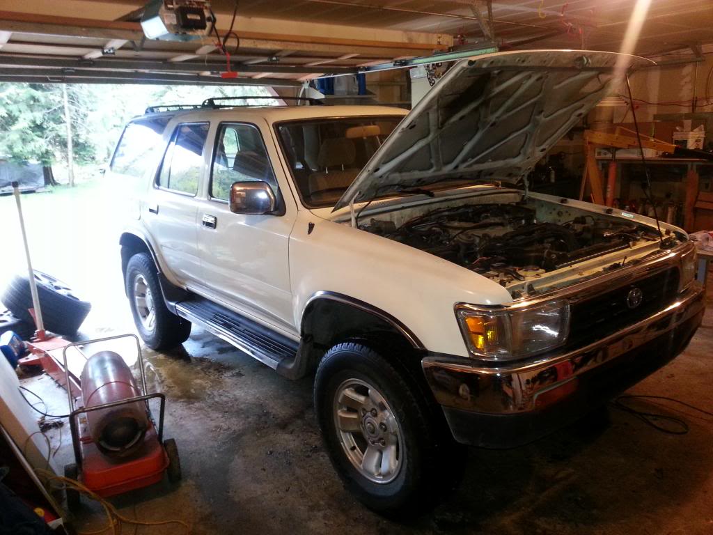

I'm Dave, and I've just picked up a '95 4Runner. I'm new to Toyota trucks (well trucks in general, really), but I've been a gear-head my whole life and am no stranger to turning wrenches. This is why I picked up a pretty clean 4Runner with a few issues - not the least of which is a blown head gasket. So, I'll be digging into that over the next couple of weeks, and hope to have her up and running well very soon. Here she is now:
