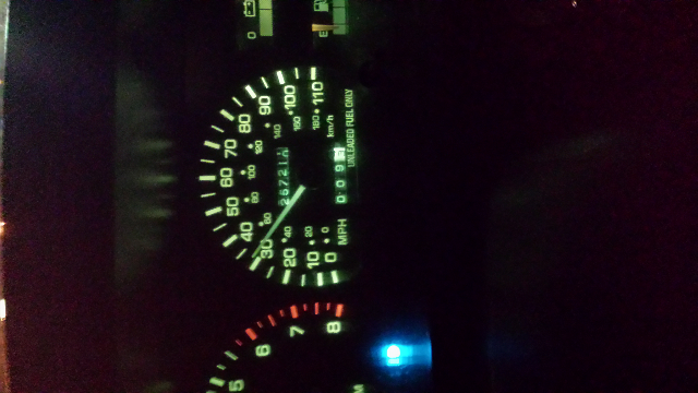

I think one of these Is the vid

None of those seem to be videos just pictures.

Cap. ... it don't think it will let me load one then:/ does anyone have any other specific questions?
