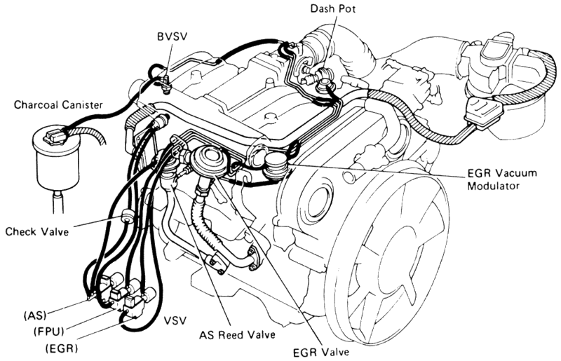

Here is a quote i did early into my build thread when I had tons of problems with all those vacuum hoses. This will show you where to route all your lines.
To everyone who has struggled or is struggling with the ton of vacuum hoses on your 3.0 motors this post is for you. Don't do the same mistake I did. Make sure all your lines are connected correctly!
this first picture below was given to me directly from the Toyota Dealership. so rest assured these are the correct locations:

This next picture is off another thread which I found most helpfulto finding out names to parts and a more detailed look at where some vacuum lines go.
Hope this post is helpful to those of you that need it.
After we routed all the lines correctly we vacuum tested the metal lines and found that one of the metal lines that travels under the intake plenum was clogged. So I just bypassed that line and connected one longer rubber hose and that fixed my problem. Dont remember what code I had though. Good luck and I hope this helps.
