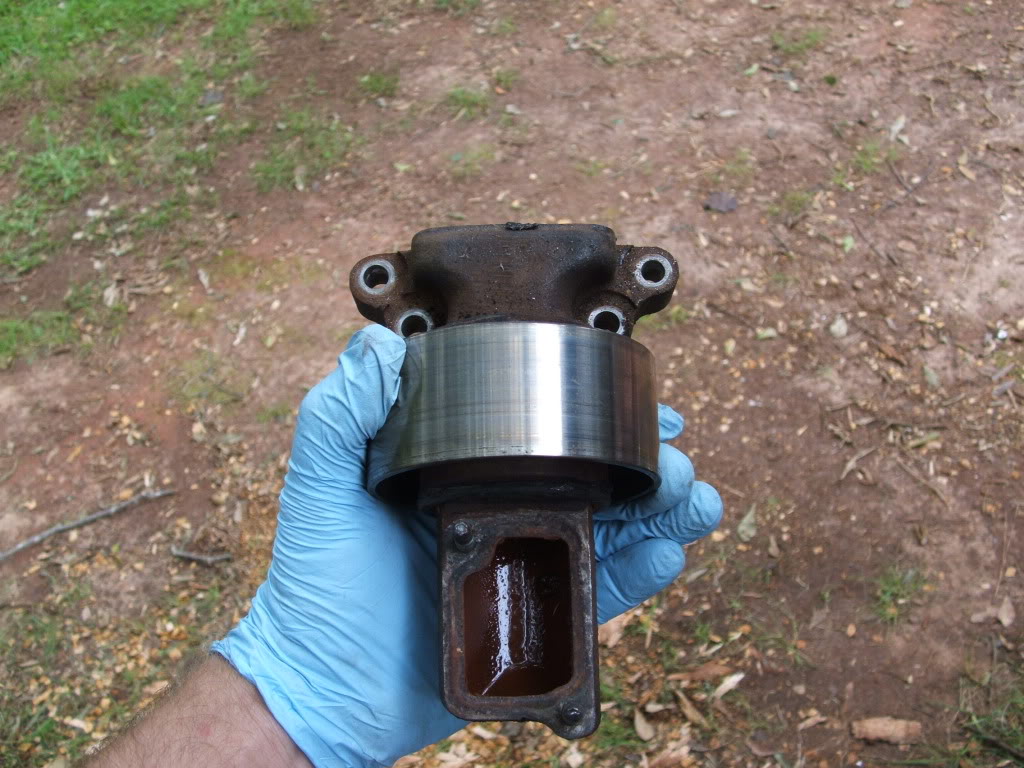

Getting a lot of vibrations from the upper idler pulley. When i put my finger on it i can feel instense vibrations. Name:  476_zps5195bad3.jpg
