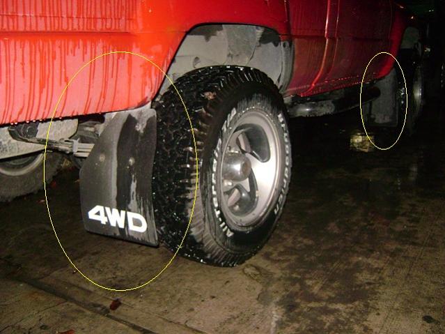

- Don't you also need these?

Originally Posted by morena67
...I do like'm...Very Nice Truck...
Yep! Those are next on the list...
