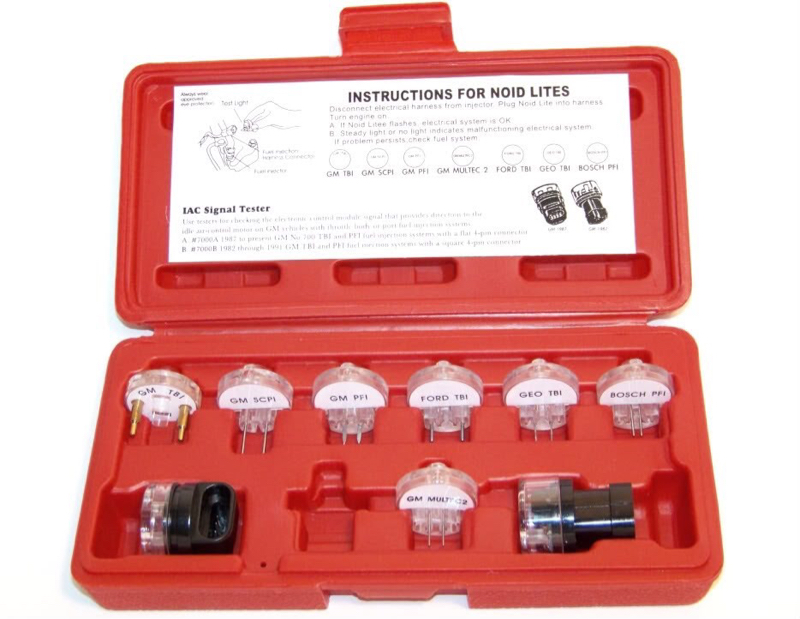

I gotta say again, check that the injectors are getting a signal with the noid light set. That will give you a good lead on which way to go with your diagnosis next.
Join Date: Jun 2016
Location: North Highlands, CA.
Posts: 47
Received 0 Likes
on
0 Posts
Yes. It plugs into the harness and shows the signal to the injector via a flashing bulb. But that will at least tell you if the issue is in the harness or injectors themselves.
