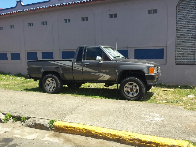

I have this toyota pickup 4x4 1988, have tire 265/70/16 but i feel that tires are too big for truck i dont know, i think change for others less with, need recomedantions of tires

Our trucks came with 2 different sizes either the up sized 31's or 225/75r15's. My door panel says 225/75r15 but it came from the factory with 31's. speedo is spot on.

Its just the 16 inch rims throwing you off.
I like a 15 inch rim on the older trucks myself.

265/70/16 equals about a 30.6 inch tire. A 225/75/15 as the stock smaller tire on these trucks was a 28.3 inch tire. So you are right in the middle of the factory sizes.

there is something wrong with you. that truck looks great!!

X2 - Only issue I see is typical saggy butt syndrome that older yotas are plagued with. Tires look fine. Too small if anything

Id say go BIGGER! I think like HighLux said... Its the size of the RIMS that make it look like they are big on it... But they arent. jejeje

unless they're rubbing then there not to big lol, even if they're rubbing you just didnt cut enough fender out lol

Yeah, fix the saggy rear end and then reassess. Tire size looks great on the front to me, but everybody is entitled to their opinion I suppose...
