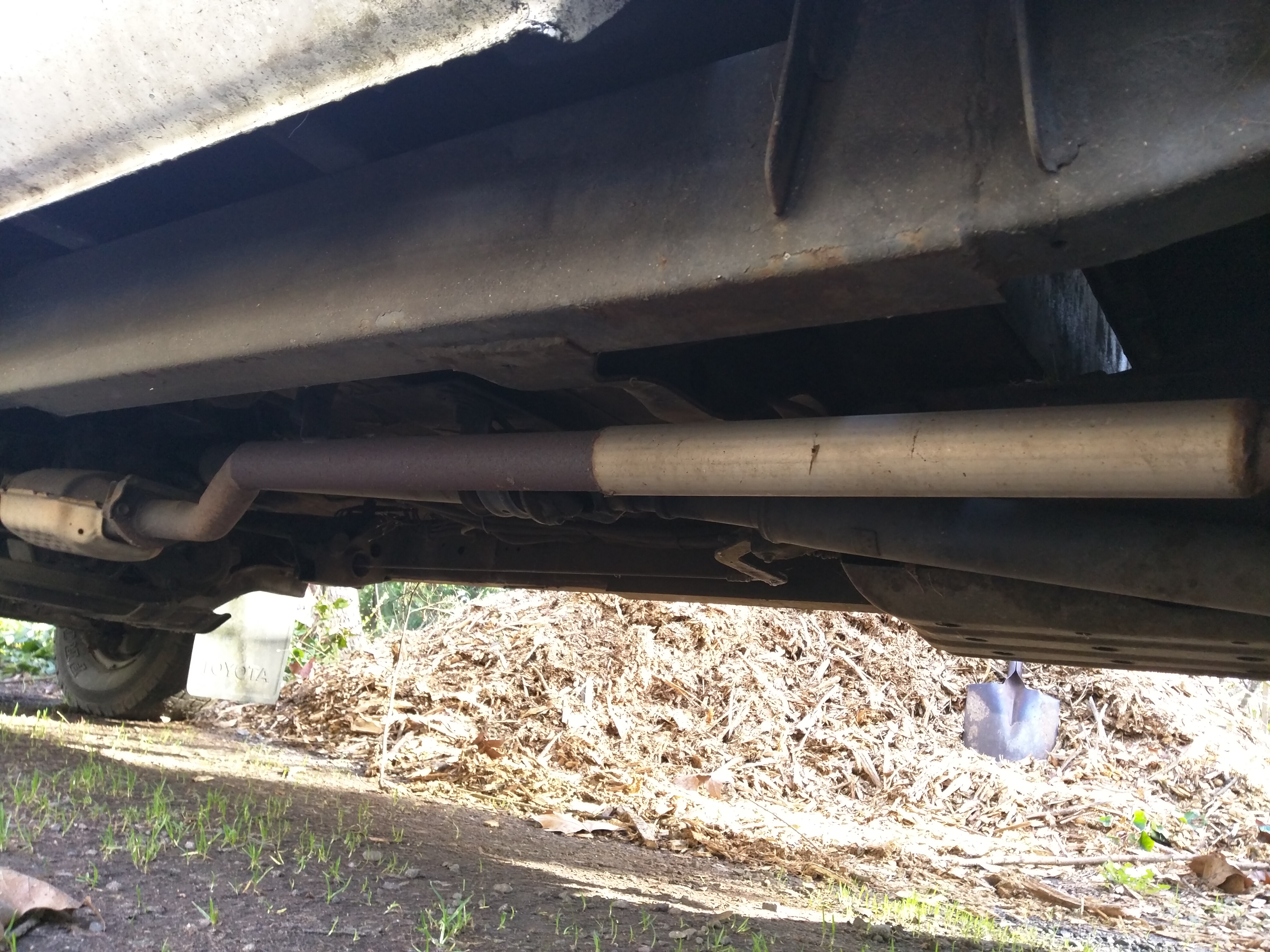

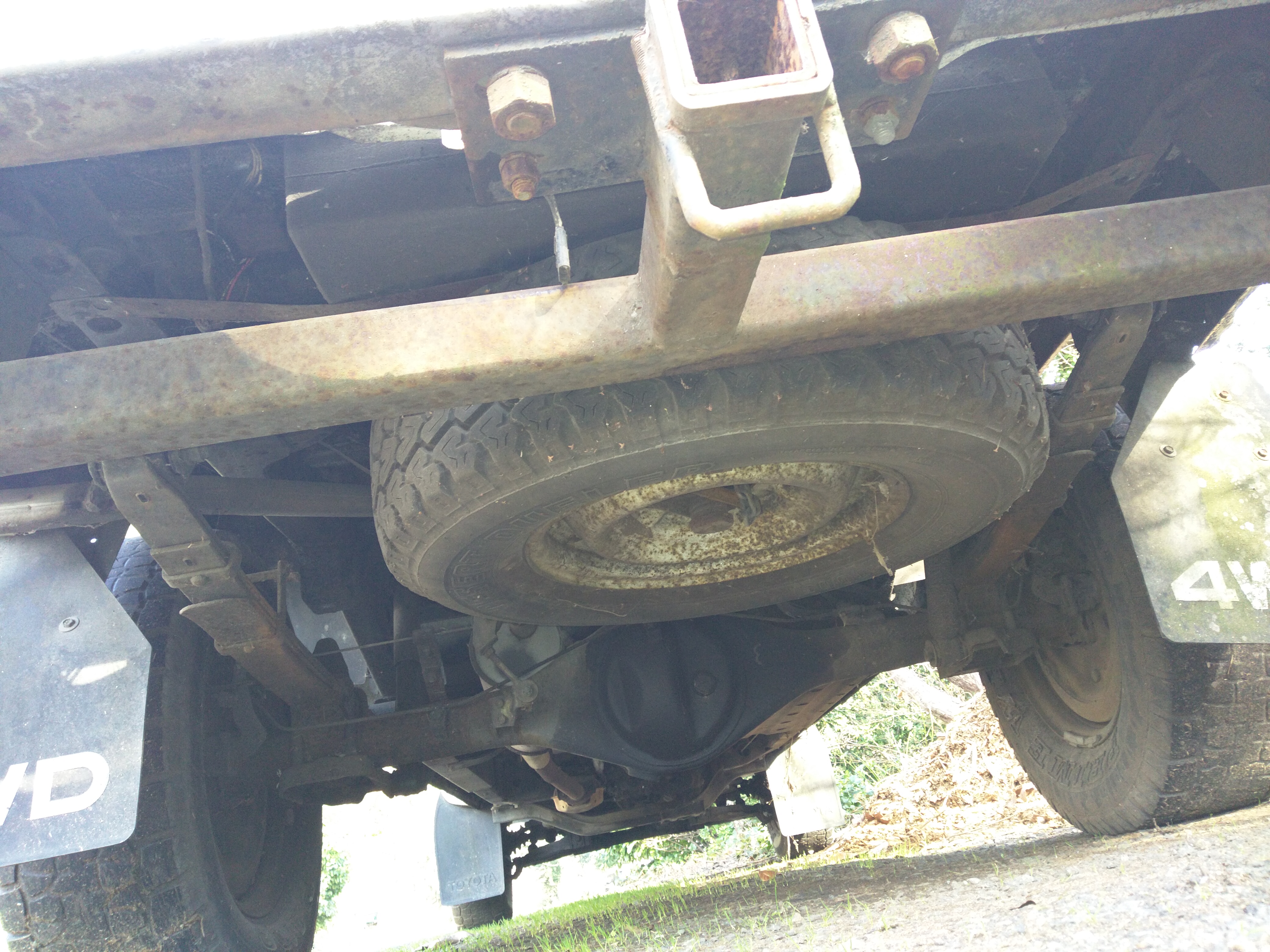

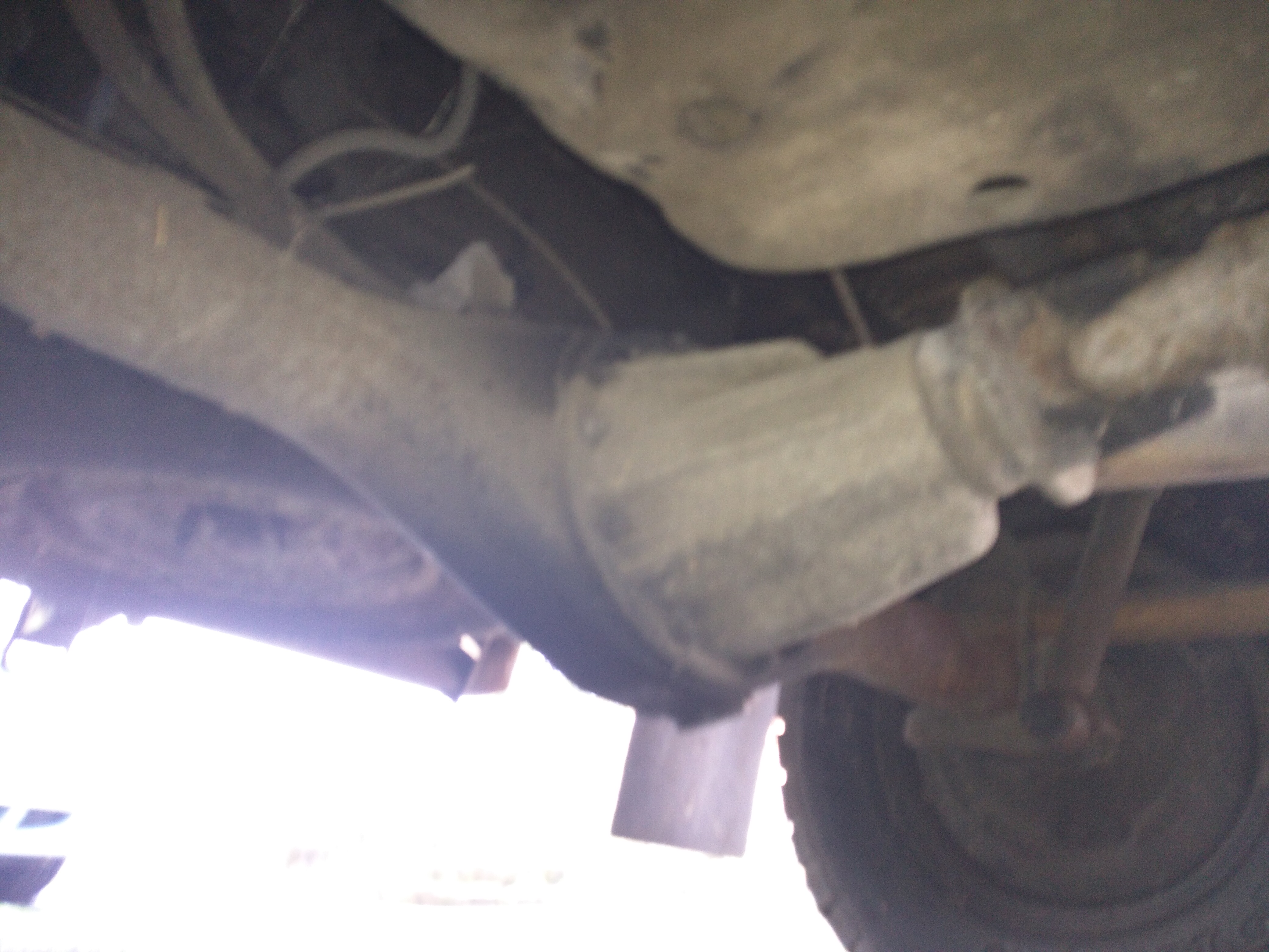

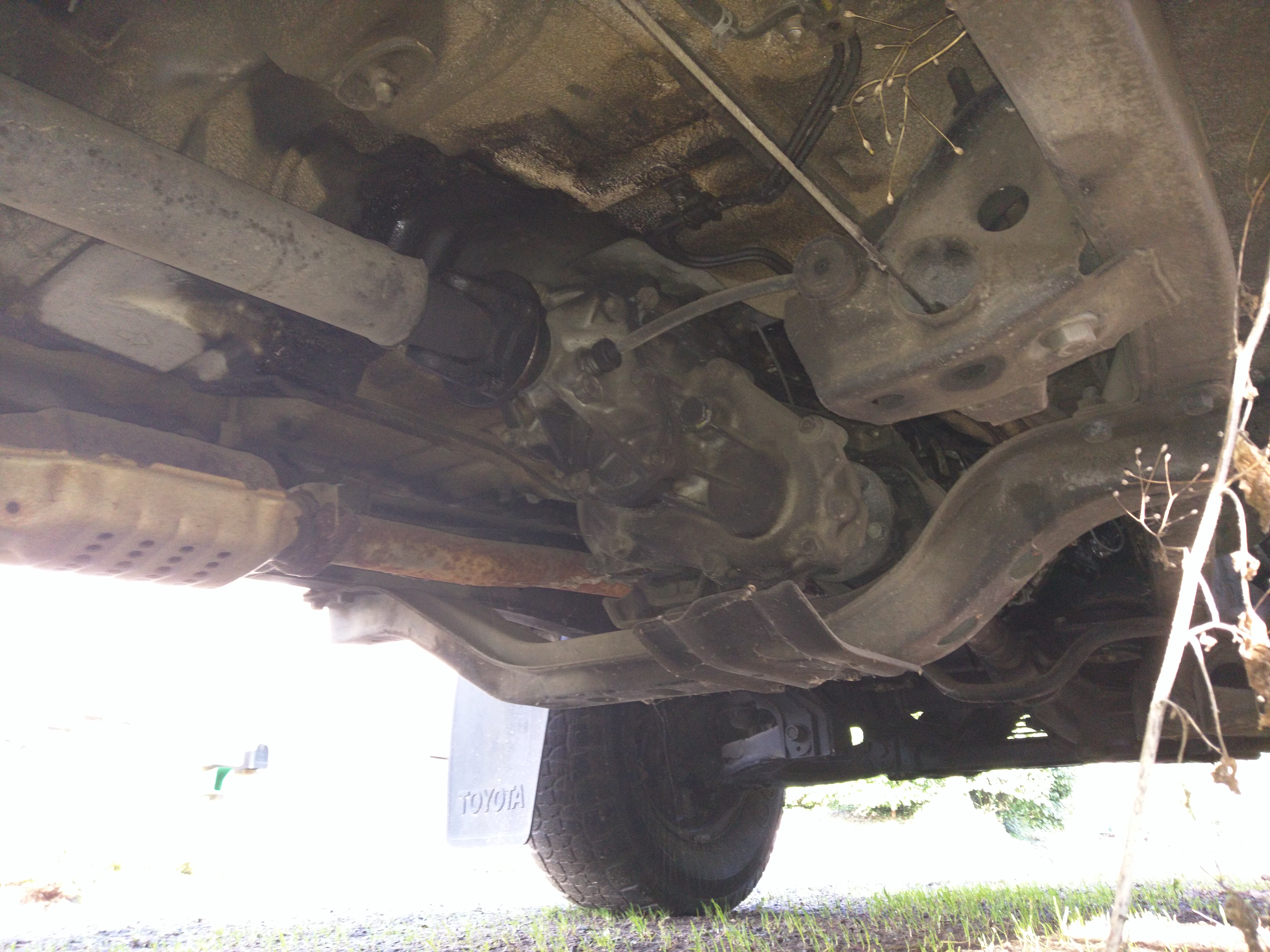

The 3rd picture looks like that is where frames were combined, I'd expect to see some sort of plating to re-enforce area.

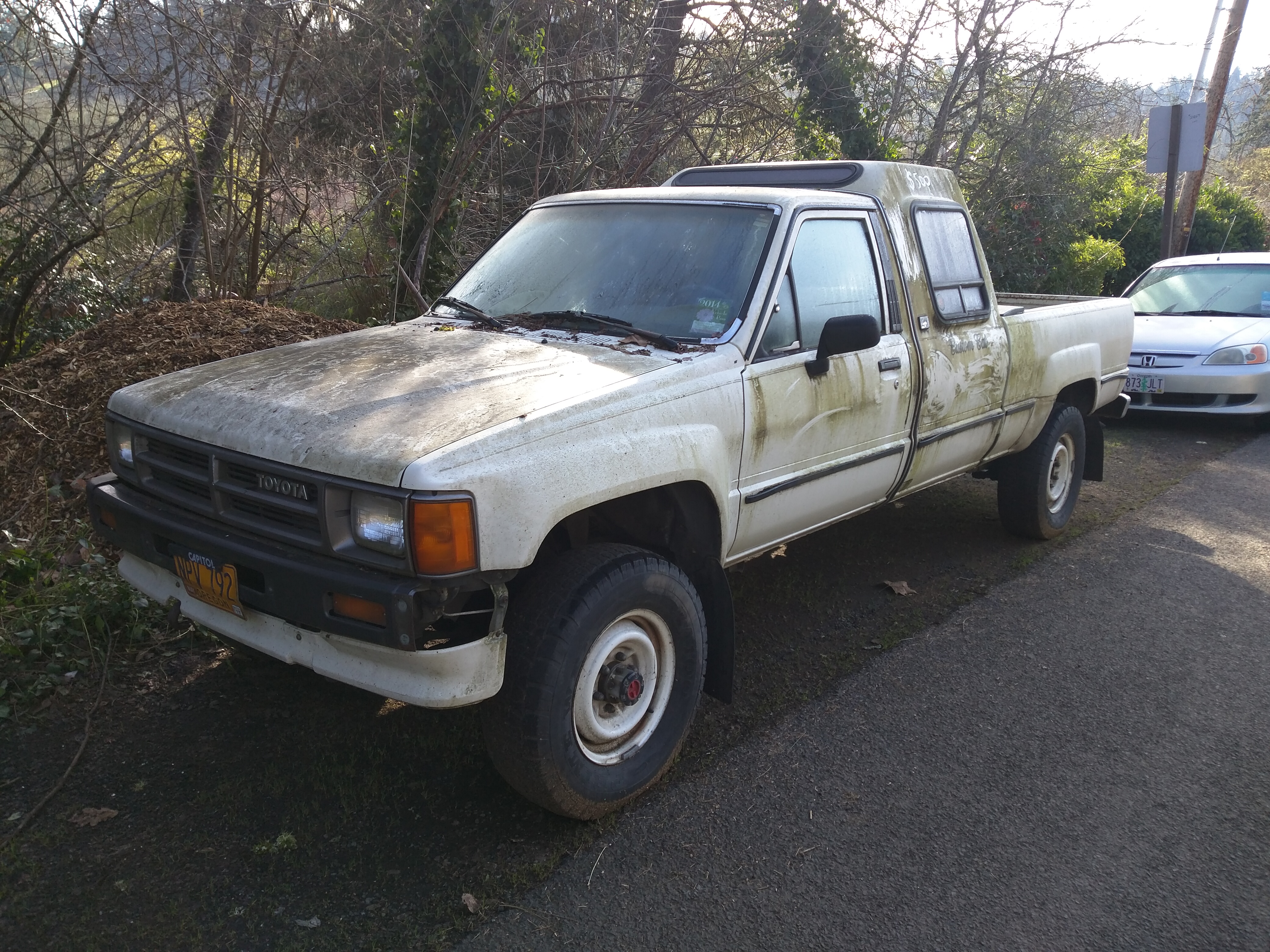

Every project needs both: time and money. Is it rare? YES! If it's actually a turbo and running the mtor alone is worth more than $500. BUT, yes there is a but... How much do you plan on investing into it and what are your plans for it?

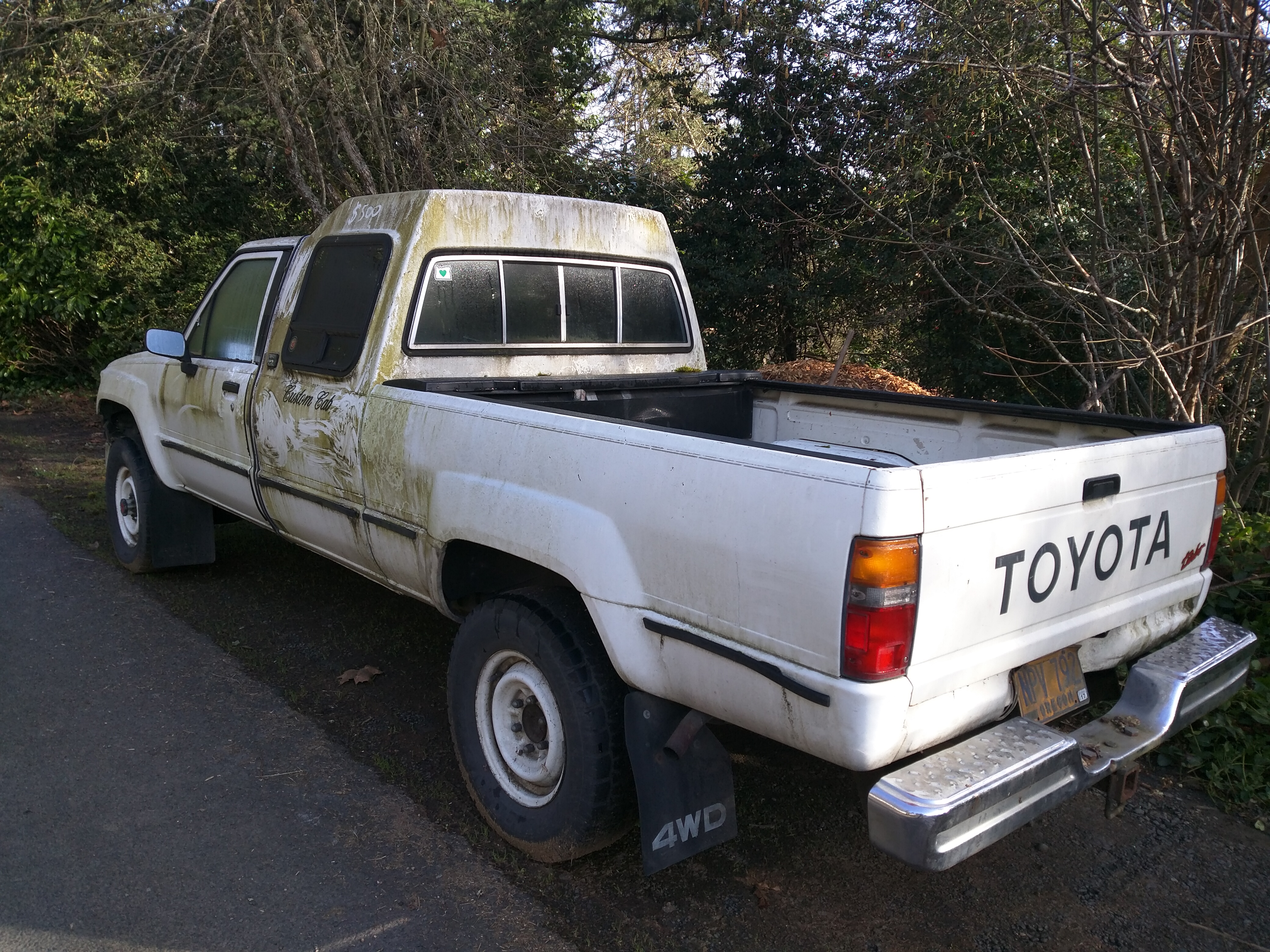

These were produced by an aftermarket, I want to say Winnebago but I don't really remember who did the custom cab stretch. So it's semi legit but I don't have any information on the failure rate or quirks.
The 22-ret is pretty much a money pit, you are going to have to love it for what it is and not what you expect it could be (its far from a turbo charged LS/V8). The factory turbo is unobtainable, there are on occasion recasting ones from Asia that run in the 800-1000 for the exhaust side (impeller) housing. More readily available is the LT1(diesel) or celica (CT26) turbos which will need some fabrication to get into place. Off the shelf you can get the LCE stuff (a Garrett turbo) but it's going to cost your whole budget right from the start.
