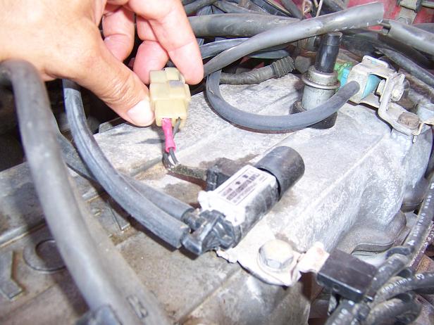

Alright fixed the gas leak. Moved the copper washer from one side, to the other haha. Worked great. I think I put it on the wrong side to begin with haha. Ok onward with other issues!! Where does this plug go? I cant seem to find where it goes
And another part I cannot figure out where it goes. As Abe says: "That is the idle air valve. On later model vehicles, from approximately 89 on, it's part of the throttle body." On the 86-88's ( I believe ) It is located under the Throttle body/ intake manifold
So I need to figure out where #4 goes. #1 goes to the TB. #2 & 3 are for coolant. and #4 goes over by the fuel filter to nothing. HELP!! Thanks!!

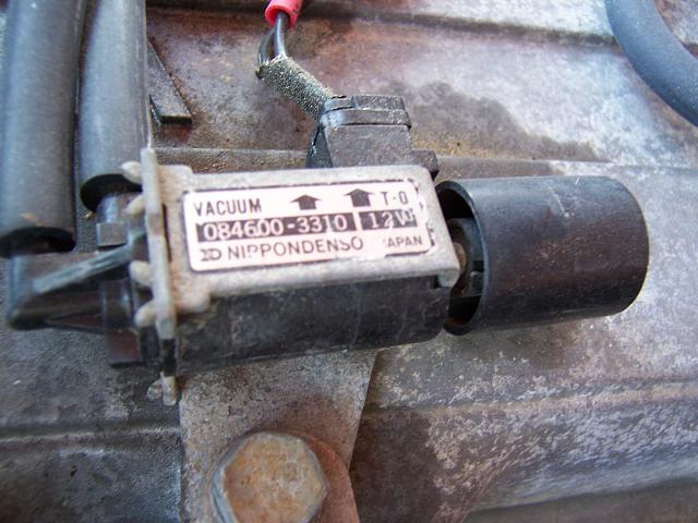

Old Jul 24, 2009 | 04:04 PM
desertcamper67's Avatar
Posts: 1,145
From: San Diego
It goes to this thing.
Attached Thumbnails Need pictures of Vaccum lines and such.-100_2770.jpg   Need pictures of Vaccum lines and such.-100_2774.jpg
Old Jul 24, 2009 | 04:17 PM
iamsuperbleeder's Avatar
Joined: Feb 2008
Posts: 12,248
Likes: 33
From: Lake City, Fl
this "thing"? lol
that would be the AC idle-up solenoid, but you'll only have a need to connect it if you're running AC. If no AC, then just twist-tie it up outta the way
Old Jul 24, 2009 | 04:59 PM
Posts: 1,145
From: San Diego
Ha ha ha ha
I was expecting that.
A mouse ate through one of the wires on mine and I had a code until I repaired it.

HA! Oh yes. Here in this AZ heat AC is a must ( though ive never used it in all my other cars haha ) Can Any one comment on the hose that seems to go to no where?? haha
