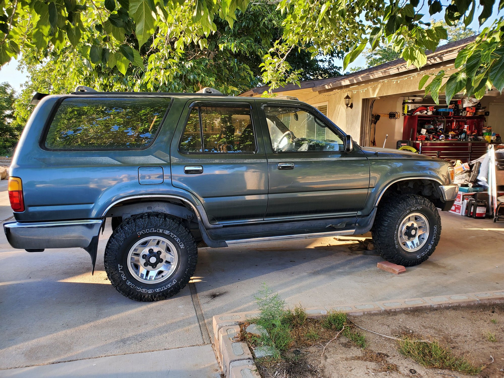

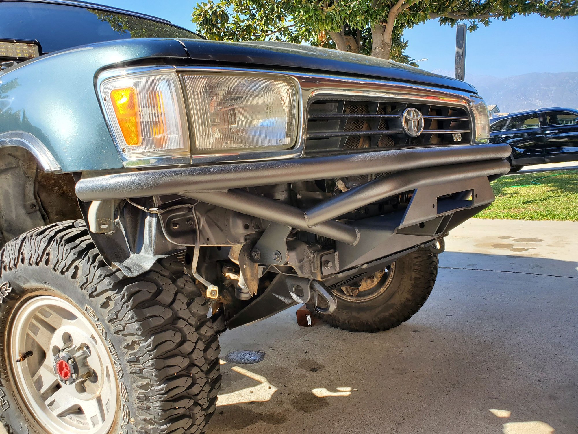

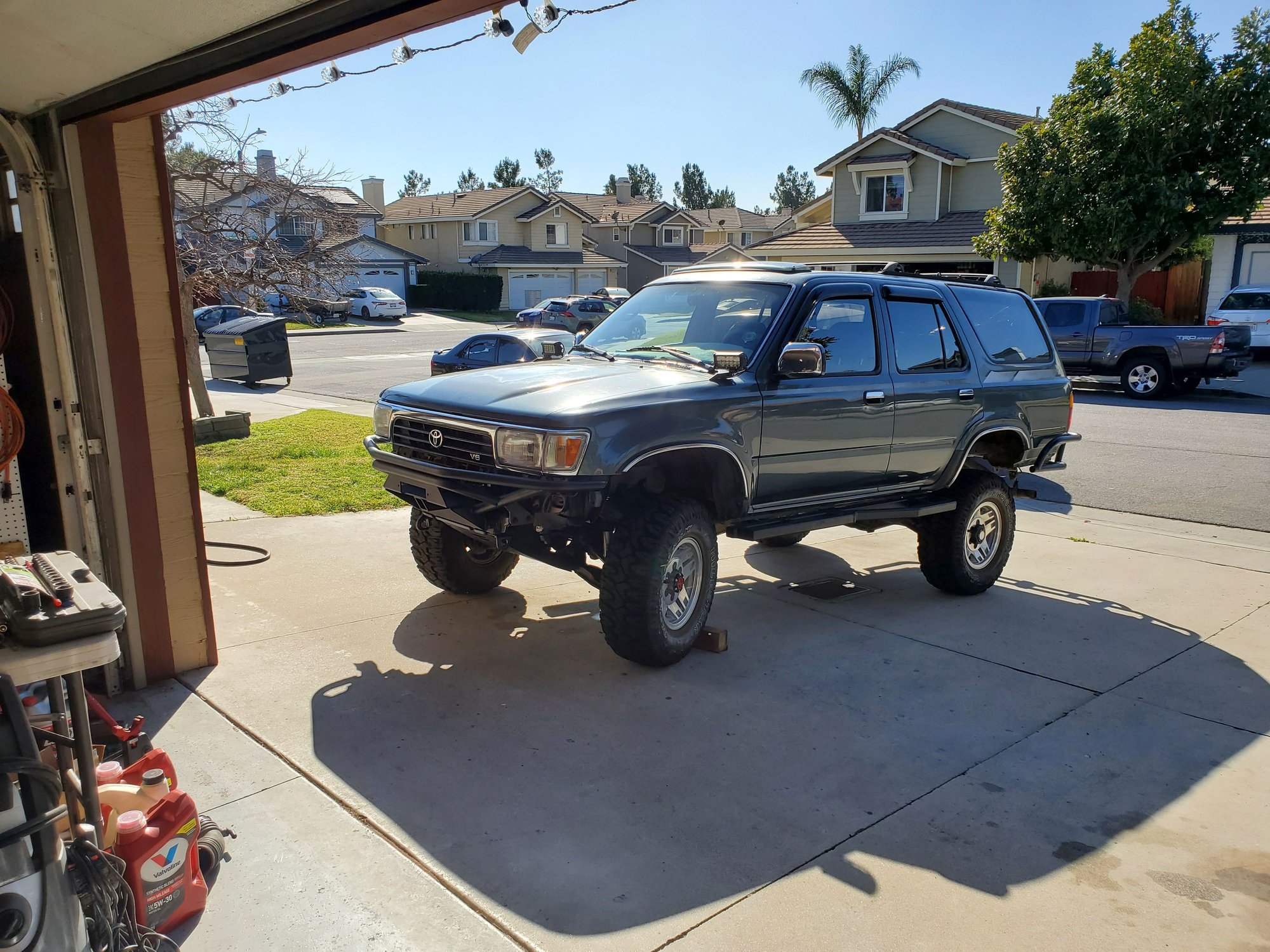

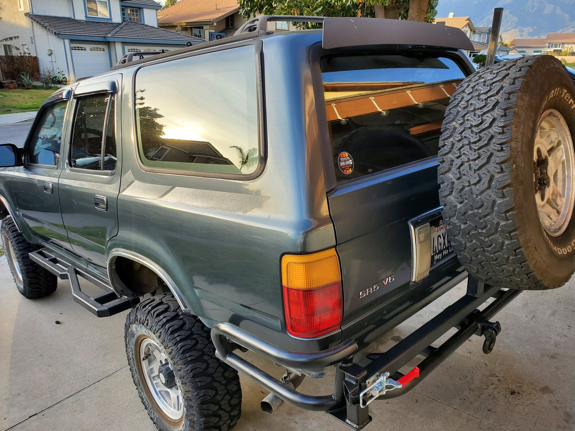

Hey there toyota fam, 2nd post ever. The point of this thread is to get ideas for where I should be with my 4runner to make it as capable as I can and hopefully give others ideas and motivation to work on theirs. I welcome everyone's feedback, experience and criticism. So some background. . . I bought my 1993 4runner 4x4 1 1/2 years ago. I almost like tinkering as much as I like wheeling. I don't have alot of mechanical/fabrication experience but I get by. (With the help of my brother in law) So far I have installed front and rear trail gear bumpers, a xbull 13,000 lb winch, rebuilt the head gasket and up, replaced all the vacuum hoses, replaced all the coolant hoses, installed ball joint spacers, hd ome springs, bilstein 5100s front and rear, panhard drop bracket, extended brake lines, extended rear break bracket, rocker switch box to control my floods, spots and light bar, Catalytic converter, built a spare tire swing out, built some rock sliders, ideler arm, and Milestar Patagonia 31x10.5 tires. I'm installing a front spartan locker within a month. I may have forgot to mention some things but we can get to that later. What else can I do to beef this guy up or just to add on for convenience or fun? And yes, eventually I would like to do a SAS.
Here is after I put tires on it. . . When I planned on not doing much to it besides wheeling it.

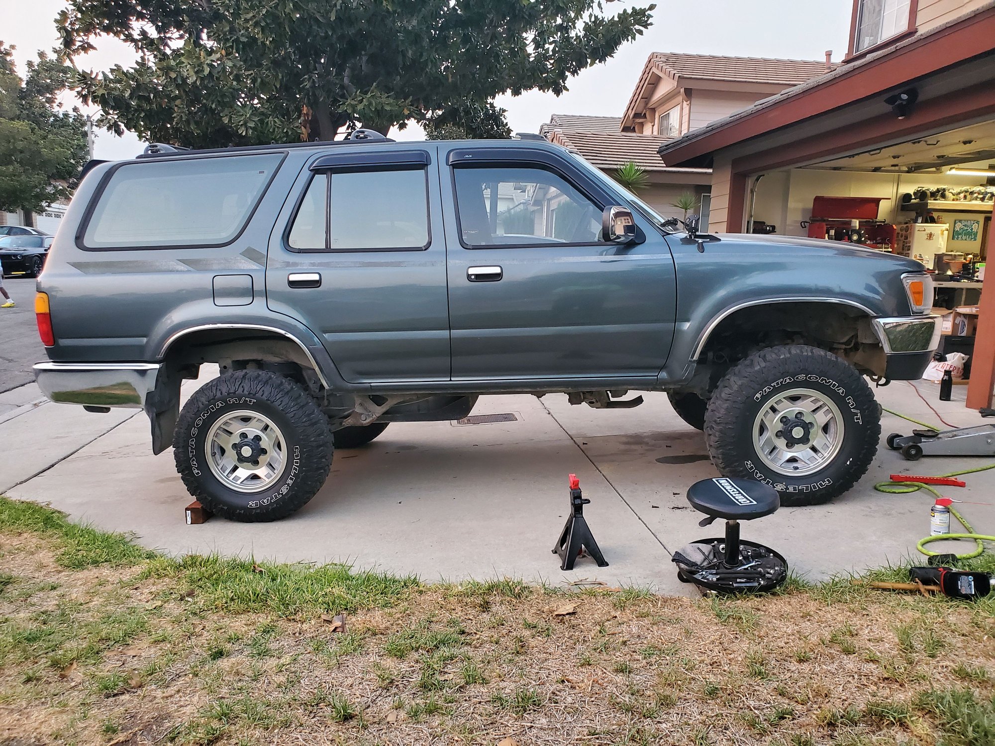

Here it is after the lift, shocks and rear bumper.

What size lift is that in total?
Old Apr 5, 2021 | 10:02 AM
bmask714's Avatar
Joined: Sep 2020
Posts: 8
Likes: 5
From: Fontana
@GrimWolf the lift is suposed to be a 2.5" rear and front. I never did measure a before and after. Its still about 3" in the rear because I don't have 350lbs on it to compress the HD coils.
