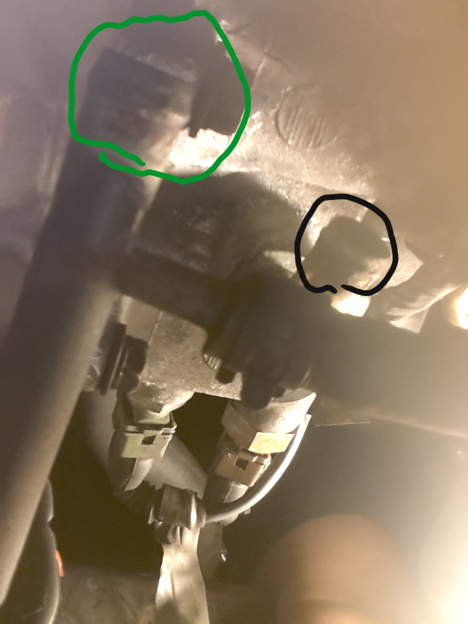

Anybody no where these two ports go

Forgot to mark these two during rebuild and guess what no idea where they go now

You also forgot to mark pictures to show what you're talking about

The green is outta the timing chain cover black is outta the intake

What type and model & year truck? EFI? turbo? Carb?

86 pickup 22re

I think they hook together as a intake coolant line maybe

Is this on the lower left side of the engine?
If so you need another coolant hose.

Yea lower left side so I guess just need to get a hose and connect them

Bypass hose 1/2 " gates part number 18400
