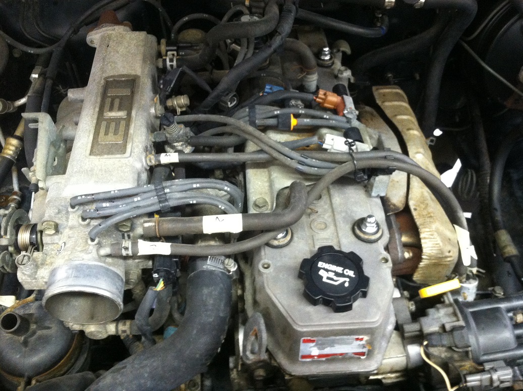

In my haste, I broke a couple of sensors which I am replacing, knock & cold start injector thermal switch. The engine runs but surges really bad. While I am waiting for a replacement cold start sensor there are a couple of items in which I didn't document well enough to re connect properly. Some help would be greatly appreciated identifying the parts and proper plumbing.

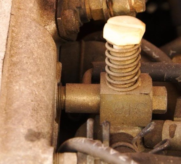

For the life of me I cant find this in the manual. It's located right next to the cold start injector. I have two hoses on the bottom that aren't connected to anything. Whats it do?

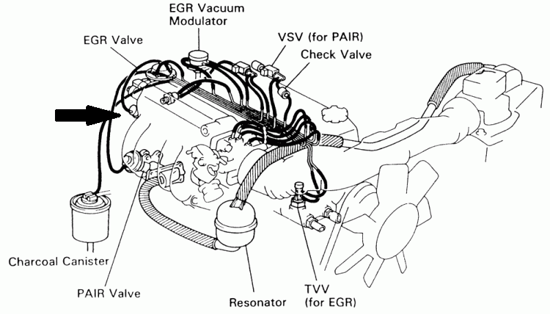

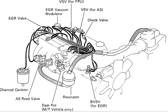

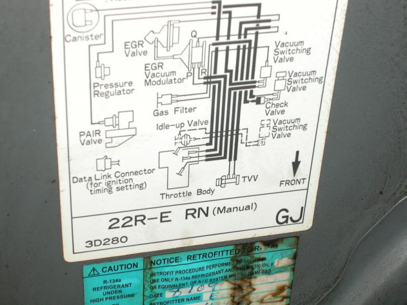

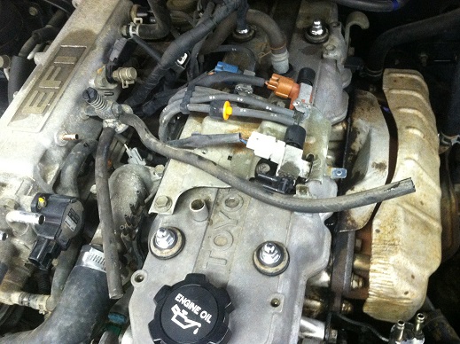

On my fuel pressure regulator, the vacuum hoses, where do they connect. I assume the only place I am missing one which is on the hard vac lines by the EGR stuff but I hate guessing. The diagram I have found is kind of tough to read.

Thank you. I am confused on the Fast Idle Speed Adjustment as I have before and after pictures and I don't think it was ever really plumed into anything.
