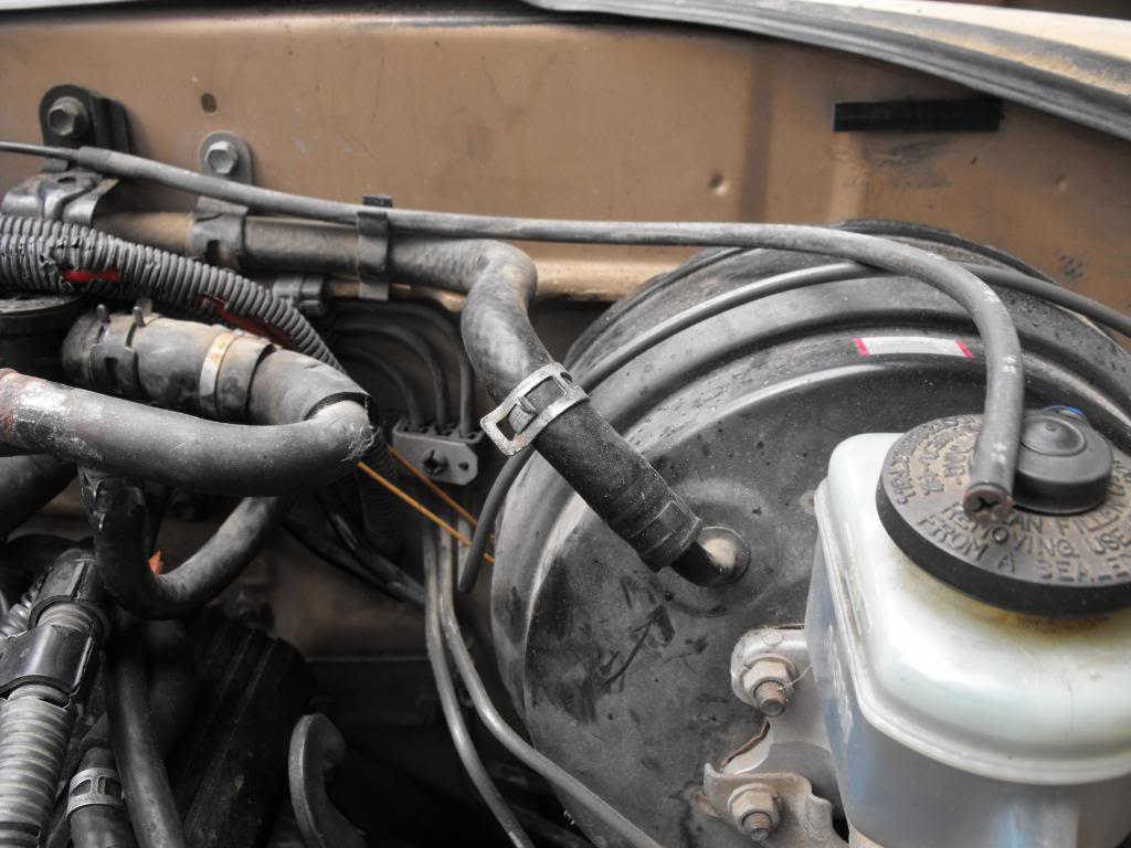

Found this hose tucked behind the brake booster, nice drywall screw.

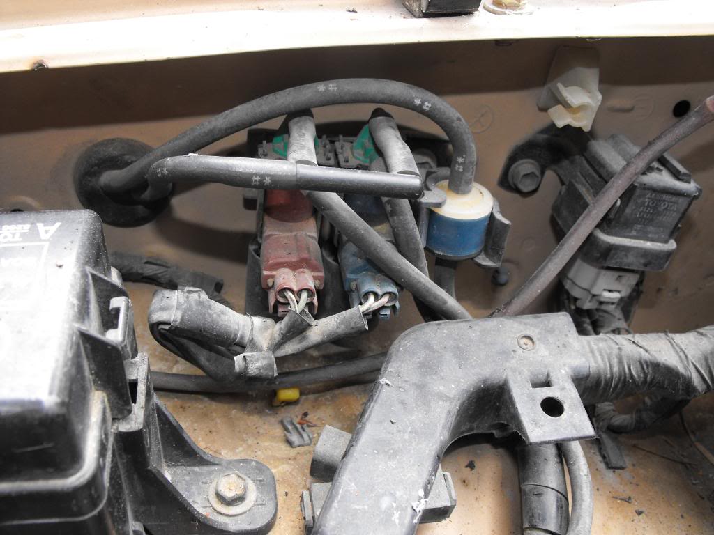

It runs along the firewall, connects to a tee, then into this blue thing and continues though the wheel well.

Haynes manual doesn't show this hose, or a tee.

You can see the tee in this pic, left center.

I think that line is for the cruise control.
Old Jul 25, 2013 | 11:55 AM
big bear's Avatar
Joined: Jul 2013
Posts: 294
From: Big Bear Lake, Cali
Thanks.
Is that what is missing between the coil and brake booster ??
There are a couple connectors there that IDK what they are for.
Old Jul 25, 2013 | 12:58 PM
scope103's Avatar
Joined: Sep 2007
Posts: 8,381
Likes: 873
From: San Francisco East Bay
Cruise Control.
Does your throttle body have an extra cable attachment?

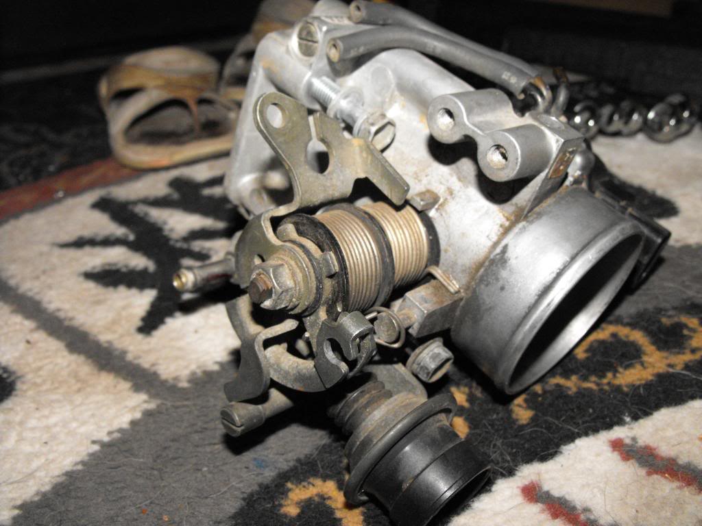

I'd say it used to have a CC.
Old Jul 25, 2013 | 04:03 PM
jener8tionx's Avatar
Joined: Oct 2008
Posts: 98
The cruise control linkage goes to the top part of the throttle body. The connectors you find by the brake booster went to the cruise control actuator and pump.
