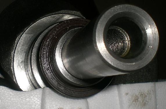

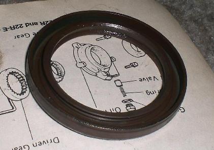

I am of course going to replace the front main seal, but I still question the source of the leak considering the condition of the removed seal:
(the second pic is the old seal on a new crank)
Seems to be in pretty fantastic condition despite its age
