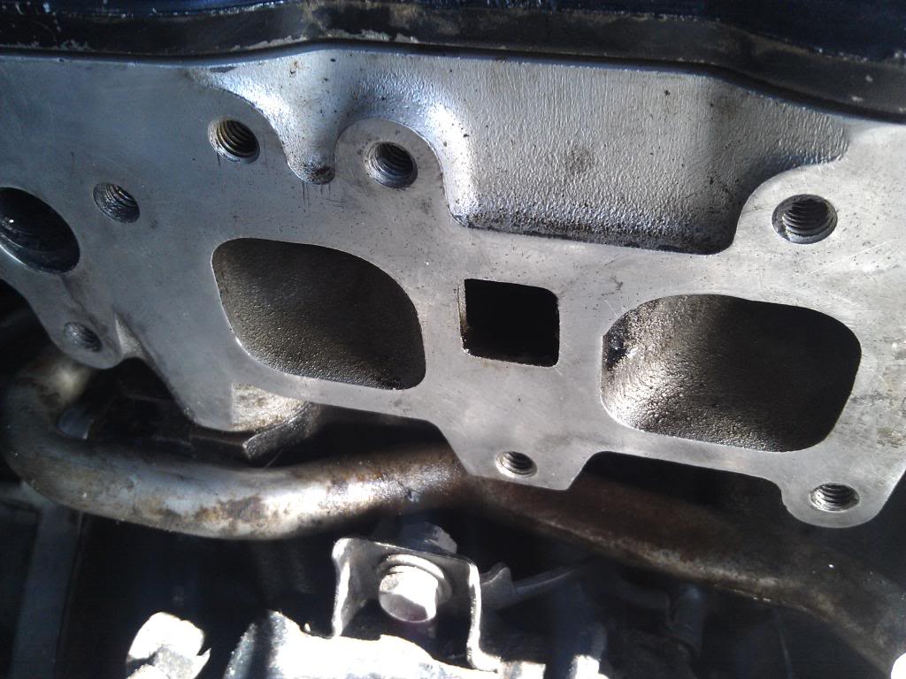

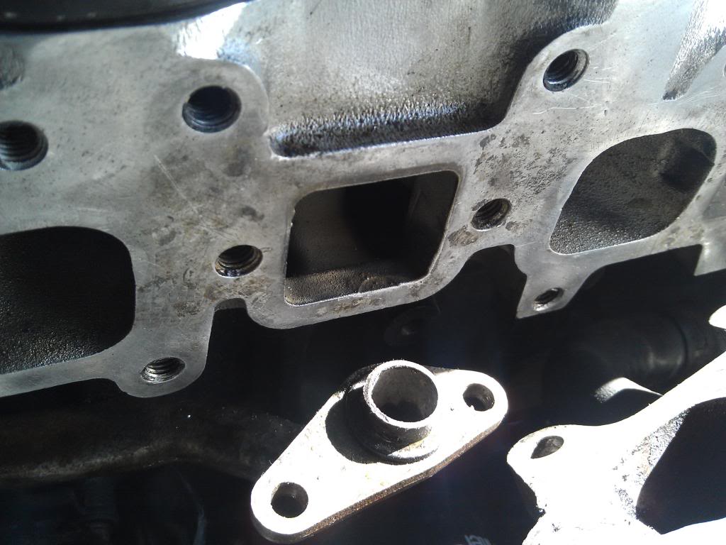

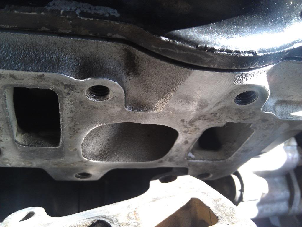

Well, i just replaced the intake gaskets, didn't see anything that immediately looked like it was leaking, but there was some pitting and corrosion around the water passages on the head. So maybe it was leaking under the gasket through those. I put some copper RTV on this time, so maybe that will fix it. Time will tell.

Some minor pitting around intake/ coolant ports on head. I seriously doubt this is the problem, but i put some RTV on it anyway.

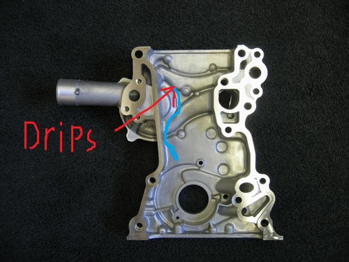

[SIZE=7]I FOUND THE LEAK!!!!!!!!
[SIZE=2][SIZE=3]So i went to check my oil yesterday and noticed that the oil looked slightly milky despite only having about 200 miles on it. "That's odd" I thought to myself. Losing coolant, no external leaks, milky oil. Sounds like head gasket, right? Well, no, it wasn't. I had already tested the head gasket and it was fine. There was no oil in the coolant. So i started to think about where else coolant could be getting in the oil from. It had to be somewhere where the coolant pressure was more than the oil pressure by a considerable amount. Cracked block/ head? I didn't think that was super likely as the motor has never been frozen, overheated, etc. Then it came to me. The timing cover. There's a gasket between the block and timing cover where coolant passes through to the water pump. That has to be it! So i popped off the valve cover, pressurized the cooling system, shined a flashlight down the length of the chain, and voila! Saw water dripping. However, it doesnt appear to be coming from that gasket. It seems to be coming from right smack dab in the middle of the timing cover on the back side. Now i have to figure out exactly where it's leaking from. There's no way to really see without removing the cover, which i would like to avoid, since it involves taking the head off (if you're doing it right). Here's a picture of where i see water dripping. Any ideas where it could be coming from? It's about 1 drop of water per second under normal cooling system pressure.

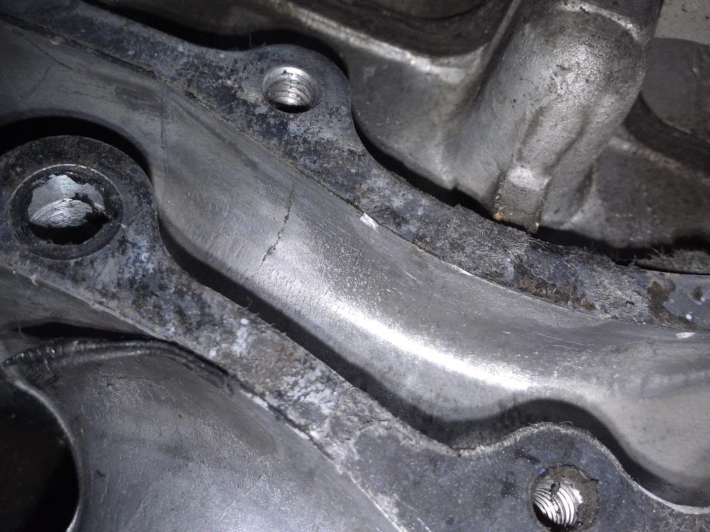

Well, i pulled the water pump and saw what looked like lots of little cracks in the timing cover, so i'm calling it low quality, crappy casting. Here's what i'm seeing:
There are lots of little cracks like that all through the channels in front for the water pump. They could be just casting lines, but they correspond to about where the water is coming from on the backside, so i put a skim coat of JB weld on the water channels under the water pump and i guess we'll see. It's been curing for a couple days and i'm about to go test now.
