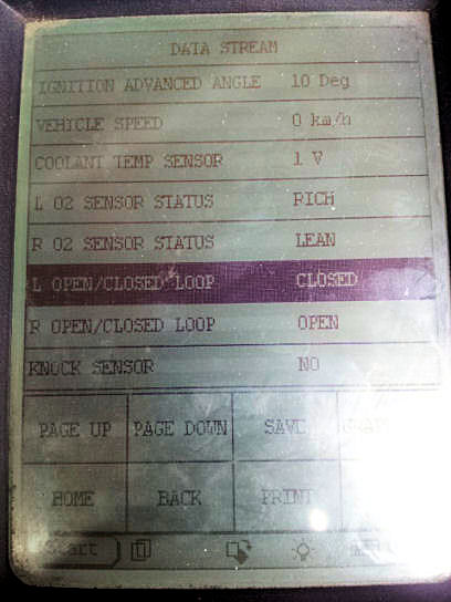

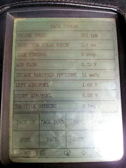

Hi all, i went to scan my 93 runner for faults, the scanner showed NO FAULTS but when the mechanic opened the Data stream while engine is turned on it showed differences between left and right (which i suppose are the left and right cylinders).
Please see attached photos.
Pic 1- Left Air/Fuel and Right Air/Fuel
Pic 2- L O2 sensor status Rich / R O2 sensor status Lean
L open/closed Loop CLOSED / R open/closed Loop OPEN
Does these readings mean that i have a dead Oxygen sensor? and does runners have 2 or just 1 like other vehicles?
Note that the mechanic moved the angle of the ignition distributor just a nudge and finally my runner is accelerating when i push on the throttle.

Your live data looks like your sensor is dead or disconnected but then again if you only have 1 sensor it would show 0 voltage since you dont have another one. As for how many i dont know i have a carbed 4 cylinder.I dont know what voltage toyota o2 sensors run at but usally over 1 volt is running rich

Your friend's scanner just isn't reading the data stream correctly. (Don't be shocked; OBD1 is not exactly standardized, and the fact he can read anything at all is pretty good.)
Unless your truck came from California, it only has one O2 Sensor (and in California it's upstream/downstream, not left/right). So the scanner is displaying "Right" but has no data for it.
So whatever problem you're having (are you having a problem?), it's not because of your non-existant "right O2 sensor."

Honestly my friend, i don't know if i have a problem or not, i read everywhere that the runners are slow, but i really think that a 6 cylinder 3L engine should deliver more and mine isn't, so that's why i took it for a scan.
Note that i bought it second hand and dunno where it came from, i live in Lebanon and was told it came from Europe.
