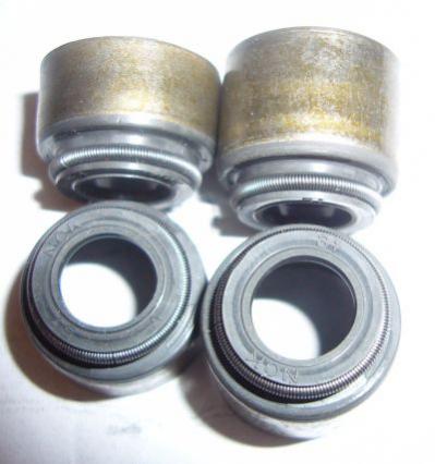

Hi Yota fans, school's out and I'm working on this again. I've been checking the head myself (don't want to pay the machine shop), and it's pretty much done: cleaned up, magnafluxed, cams + bearings measured, valve stems + guides measured, lifters + bores measured, valves lapped, etc. The head's in good enough shape, and any problems aren't things that the machine shop will fix anyway.
Question: the FSM says intake valve guide seals are gray, exhaust are brown. The Toyota seals I got are the same color, but some are deeper than others. Can anyone tell me which are which? Here's a pic.
Old 05-27-2010, 08:00 AM
betelnut's Avatar
Join Date: Dec 2009
Location: Austin, TX
Posts: 268
Received 0 Likes on 0 Posts
Deep ones are the intake seals.
