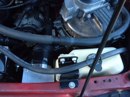

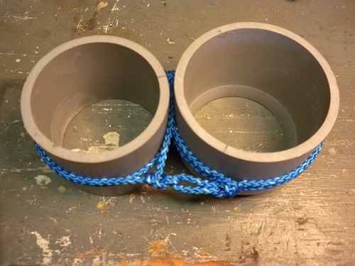

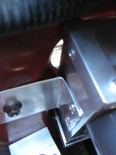

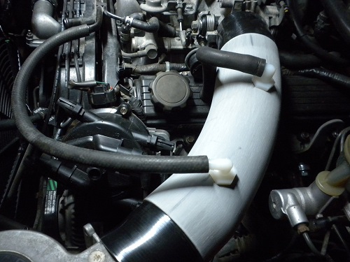

Just wanted to show some pictures of my ISR and what I did for cold air. The ISR I made was fairly standard. The only thing different I did over others I've seen is to sleeve the outside pipe itself with 3" exhaust pipe on the inside. That way I could buy an 3-2.5" adapter from the parts store that was nice and tight and avoid loose fitting plumbing adapters.
For the cold air part I noticed that if I removed the overflow bottle there were two large holes in the front clip. I then built a custom box to go over those holes. On one side I used one of the bolts for the radiator and on the other side one of the nuts that holds the receiver/dryer in place. There were some gaps I had around the box, and I accomplished sealing those by removing the grille and using a duct sealer from the inside. At one spot on the upper round hole I closed in with some gorilla tape.
I modified the lower section of the factory air box by adding a 3" port at the 8 o'clock position. I also plugged the original 3" port with a plastic cap. Note all the little holes I plugged, which was a previous effort. (And yes, it's white, but 100% silicone) I then used an expandable intake kit from the parts store to connect the new port in the air box to the custom box at the front clip.

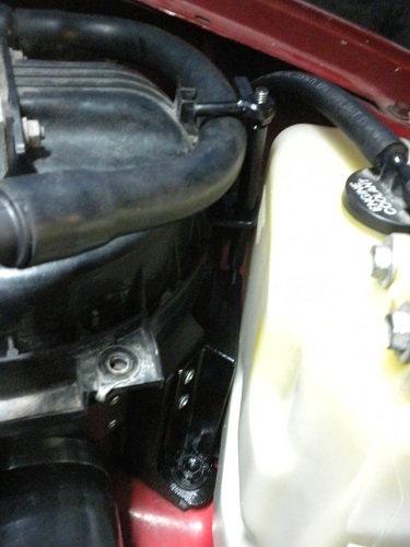

The coolant bottle was simply flipped around. I built a small bracket at the bottom to hold the post and grommet from the tank. It lines up well with the lower nut to the receiver/dryer. On top I also built a custom bracket out of 1" angle iron. So the coolant bottle is held using the same points as the factory.
I'm happy with how it came out. I think it looks relatively clean and I know for sure I'm getting air from outside of the engine bay. Two things I've noticed however... One the dipstick is a little tight, not impossible to get to but tight. Second, you have to pull the coolant bottle to service the air filter. This is because the new position of the coolant bottle traps one of the clips for the air box. That's it tough, otherwise no issues.
Let me post this up and then I'll add some more pictures for you guys.
Attached Thumbnails My ISR and Cold Intake, yeah another one...-intake2.jpg   My ISR and Cold Intake, yeah another one...-intake10.jpg   My ISR and Cold Intake, yeah another one...-intake4.jpg

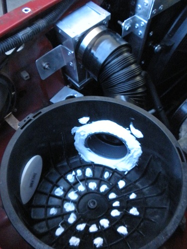

Here you can see the large holes that, for some reason, Toyota decided not to use but rather decided to pull air from behind the headlight. The box I built goes over these two large holes. you can see the gap at the aluminum box that I couldn't cover, that was the spot where I used the gorilla tape, the rest of it I sealed from the inside using duct sealer.
Also the ugly inside of the lower section of the factory air box. This is particularly ugly because I had to re-cut the hole. At first I didn't have the hole low enough in the housing for the filter to fit, so I had to lower it right at the bottom to accommodate the filter.

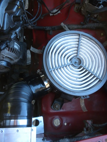

Factory filter fits easily. If you look carefully in this first picture you can see the bracket with the big hole in the lower left of the photo. That holds the grommet and post from the coolant bottle. In the second picture you can see the bracket I built for the top of the coolant bottle. This was made using 1" angle iron just in steps and then welded in place. I did also have to extend the hose from the radiator to the bottle and the exit hose from the bottle itself. There's no hood clearance issue at all. My hood closes easily and doesn't hit the new position of the coolant bottle.
Attached Thumbnails My ISR and Cold Intake, yeah another one...-intake7.jpg   My ISR and Cold Intake, yeah another one...-intake9.jpg   My ISR and Cold Intake, yeah another one...-intake12.jpg

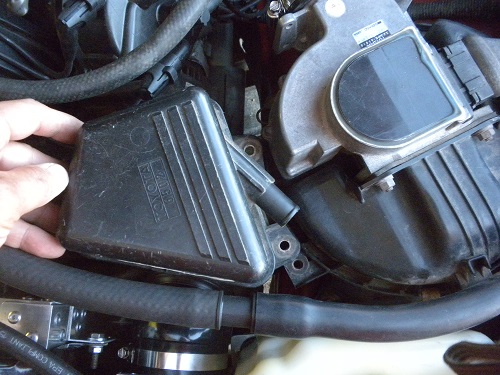

Were you unable to keep the PAIR resonator box, or did you not try?

Hey thanks guys, I appreciate the kind words. Let me see if I can fill in some of the gaps. And please let me know if I washed over something that needs more detail.
On the ISR mod:
- One 3" i.d. Electrical sweep
- Two pieces of 3" exhaust pipe, 2" long
- Two 3"-2.5/3" Spectre silicone adapters
- One 3/8" right angle hose barb
- One 1/2" right angle hose barb
Cut the sweep and fitted the exhaust pipe pieces on each end using silicone to glue them in place. Dry fitted to figure out where to locate the barbs and their orientation. Shortened the barb so it wouldn't stick so far into the tube, glued with silicone. I wanted to use the Spectre adapters because I wasn't satisfied with what I found at the hardware store. These are super tight, and they allow for future upgrades if I want to go with a 3" i.d. throttle body in the future.
For the cold air intake mod:
- One 8' section of 1/16th" 2"x2" aluminum angle
- One 4' section of 1/16" thick 1/2" aluminum angle
- Two Spectre 3" plastic mounts/plates
- 3/16" and 1/8" pop rivets
- One Spectre 3" flexible intake hose
To build the box I cut two pieces of the 2x2 angle roughly 5-3/4" long for the sides and to fit over the two holes. The bottom of the box is about 3" wide. I drilled one rivet at the bottom and used this as a pivot point to figure out how wide to made the top by simply holding it over the two holes and figuring out the best fit. Once I did that I simply capped the top, ran the 1/2" angle around the edges, cut the 3" hole for the mount, and sealed up everything from the inside with some silicone.
For the air box I basically just cut the hole and siliconed the plate from the inside. Note that in both cases I had to trim the crap out of the plate to make it work. Not knowing if things are going to work out as planned I am always hesitant to cut into the body, but honestly if I were doing it again, the easy thing to do would be to make a 3" hole in the front clip and then install the plastic mount. I'd make a steel reinforcement plate to strengthen everything and seal it all up with silicone. That would have been way easier and less time consuming than building the aluminum box. More importantly it would have eased the bend from the front clip to the new entry into the air box. It was tight and at maximum flex to get it to fit.
I also would have done the hole into the air box differently. Instead of using the plastic mount I would simply use a chunk of metal exhaust pipe. It would have allowed a slightly longer protrusion of the fitting outside of the air box. This is because the plastic mount is flat and the inside of the air box is curved. Using a piece of metal pipe would have allowed cutting custom length tabs on the pipe end and simply gluing those in place from the inside.
The coolant bottle was easy, just flip it around. An L-bracket at the bottom held by the lower nut on the receiver/dryer with a big hole on top to accept the post and grommet from the bottle. On top I used some 1" steel angle and just created steps down to meet the front clip. Of course I had to extend the hoses too.
Concerning performance... I honestly haven't had it on there even one full tank of gas. So I can't give you any true stats. It does "feel" better to me as far as throttle response. I mainly did the ISR mod to get the piping away from the headers. The cold air set up I did because I never liked the restricted intake from behind the headlight. Not only that, but I felt any time you had your headlights on you would invariably draw in air that was higher than ambient temperatures.
It's strange looking at those big holes, it's seems like such an obvious place to draw air from, at least for the 3.0. And it's perfectly protected as the grille itself has more plastic at the ends and is open in the center. I thought about drilling holes in the grille too, but felt it wasn't needed and that would only increase the bugs and rain and stuff getting into the air box.
I was looking at the PAIR resonator and I think I can hook it back up. A simple plate to shift the mounts back would allow this to be reinstalled, so there is space for it. I'm also working on a way to get around having to remove the coolant bottle to service the air filter. Should be pretty easy, I just need to create a clip to hold that side of the top and simply remove the factory clip. I'll add a picture of that when I get around to it.
I hope this answers some questions. If you have others, again, feel free to ask for clarification or specifics.

Is that electrical sweep hard PVC or a flexible material? I've thought about trying a silicone hose primarily for heat protection over the exhuast pipe but hadn't thought of that. Was thinking that a high temp ceramic exhaust temp paint was easiest, but your project has me rethinking. And it looks good too!
For the barbs, you drilled/cut through both sweep and exhaust? Some silicone shop makes connections that runs into their silicone connectors/couplers that I thought about using instead of drilling into an exhaust and disrupting airflow...

RSR, the electrical sweep is a hard plastic. The metal exhaust pipe is only right at the ends. I cut a 2" piece off and tapped it in 1" on both ends. They were snug fitting, but I used silicone to glue them in and take care of any air leaks. So in answer to your question when I tapped in for the barbs I was only going through plastic.
High temp paints aren't needed. This intake tube will never get hot enough for the paint to become a factor. And after a while the tube will become the same temperature as the rest of the engine bay. The best thing one could do would be to add a heat shield over the manifold/headers or a heat shield for the intake tube itself. Alternatively a wrap of some sort... anything to insulate it. But the electrical sweep is pretty thick. I myself, doubt any additional shielding or insulation would be of much value. I'm not sure of the silicone connectors you're talking about, so if you've got a link throw it up.

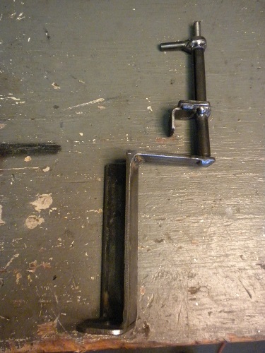

I think RSR asked earlier about the little resonator box there. I added a picture. It would be super easy to reinstall. All one would have to do is rotate it back slightly as you can see in my picture. This problem might be overcome if the aluminum box wasn't there too as that would ease the bend and allow more space over the tube so it didn't contact the bottom of the resonator. We'll find out when someone does this mod without the aluminum box.
Today I took care of the air box filter change problem I encountered earlier in the design. The problem being that with relocating the coolant bottle you can't unclip the strap that holds down the top of the air box on that side. So to change the air filter I'd have to unbolt one 10m bolt and remove the coolant bottle. And while this is no big deal, I decided that I didn't like that flaw. So I built a crazy bracket clamp that could be accessed from above, and hence allow the air filter change without having to fuss with the coolant bottle.
Attached Thumbnails My ISR and Cold Intake, yeah another one...-air-box-2.jpg   My ISR and Cold Intake, yeah another one...-air-box-1.jpg   My ISR and Cold Intake, yeah another one...-air-box-6.jpg

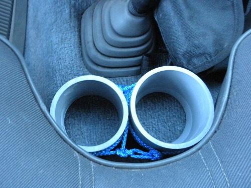

Here you can see it all painted and installed. I basically just worked some angle over, plug welded a piece of all-thread and then built the clamping mechanism. The tubes you see are actually roll pins. On the foot of the clamp itself I welded the roll pin to the bottom so when you clamped down from above it stayed aligned with the rod and pressed down straight. The roll pin on top just serves as a spacer. The wing nut I made was just a couple of nuts welded together with a small piece of rod welded on one side. You can also see where I added a couple of 3/16" rivets to stabilize the lateral movement. One rivet would have been fine actually but I'd already drilled two holes in the bracket.

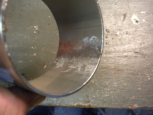

When I was cleaning up today I noticed the left over chunks from cutting the electrical sweep. I cut them to the same height and then lashed then together like you'd lash two poles. One is actually slightly bigger since it's made as the female end that you cut off to make the intake tube. Anyway, lashed together and they sit almost perfectly on the space behind the shifter and in front of the seat. And now I have holders for those bigger cups.
Attached Thumbnails My ISR and Cold Intake, yeah another one...-air-box-7.jpg   My ISR and Cold Intake, yeah another one...-cupholder-1.jpg   My ISR and Cold Intake, yeah another one...-cupholder-2.jpg

Just one more picture of it with the coolant bottle back in position. Clearance is tight. But honestly this whole crazy bracket is probably a little much. There's probably a simpler way to clamp that edge of the air box... I'm sure there's a store bought latch you could find and add to the air box in just a few minutes. But I wanted something custom and I wanted a hold-down in the exact same spot where it was held before.

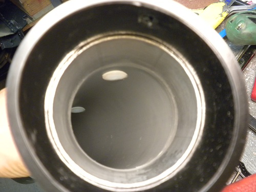

You mentioned flow, so I've added a picture of the inside of my pipe. You can see I trimmed the barbs as flat as I could. When making the holes in the pipe for the barbs I was super careful to get a very tight fit. They're pretty much a press fit into the pipe with the silicone just taking care of any air leakage. Nothing to ever come loose or fall down into the pipe. I also smoothed the seam of the exhaust pipe... and while I could argue this was for air flow, really it was to prevent cutting my fingers up while servicing later. Anyway, it's pretty smooth in there. I'd say pretty darn close to a mandrel bent pipe.
Attached Thumbnails My ISR and Cold Intake, yeah another one...-pipe-1.jpg   My ISR and Cold Intake, yeah another one...-pipe-2.jpg
