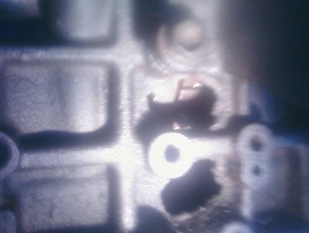

pictures this is passenger side under motor mount
Originally Posted by toyota4x4907
Here she is I am now frantically looking and thing about the 3.4 upgrade but don't want to get into to much but robd says it is pretty easy... Mmm? I will need motor and tranny right?
Old Jan 10, 2009 | 01:46 PM
desconhecido's Avatar
Joined: Dec 2008
Posts: 200
Wow, that's impressive. Did you lose oil pressure?

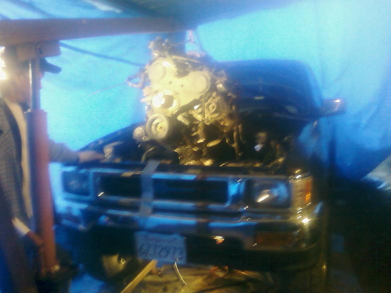

Here is another pic
Here is a picture of my truck and my dad giving a hand in the engine pull. Also notice I am doing this in my "Tarped" off carport... Ha looks like some tweeker outfit, but hey I don't have a garage and I wanted to do it my self. Ha At least it was heated room... oh and this is before I knew engine block had see Through inspection whole.... and I was still excited Ha Ha he he
Attached Thumbnails My holy 3.0 I guess this changes everything-pic-0075.jpg
I got truck from my friend that did an quick engine swap from junk yard and the thing blown up after about 6 months I got it with blown motor... I was hoping for a rebuildable motor

From: Chico Republic, NOR*CAL
wow that's pretty intense.... nice sized whole, i guess it doesn't run like that 22re on youtube haha.

Posts: 200
Yeah, doesn't look like that block's going to work out. Hazards of buying a used engine I guess.
