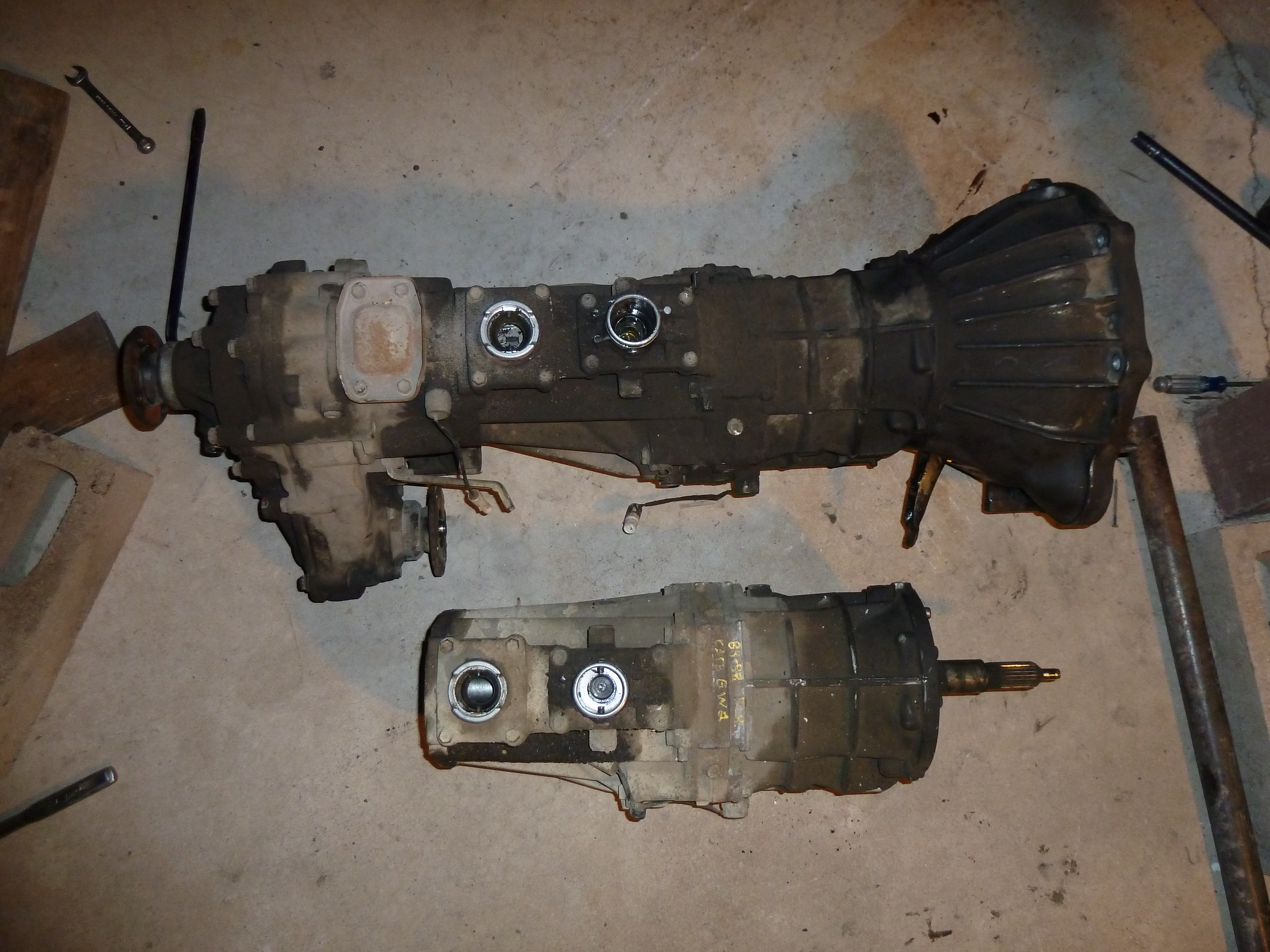

Well, I'm back at it! I ordered my new to me tranny and got it here. My biggest complaint at this point is my carpet was glued down from door threshold to threshold from fire wall to the seat. I had to rip it completely out to remove my shifters. I pray it will lay down well enough to put it back together w/o gluing it down.
I pulled the tranny w/ bell housing and transfer case out of my "gem." Upon draining the gear oil out of the tranny the drain plug had a thick and so very smooth metallic paste on the magnet. Mind you I changed the tranny oil when I started driving the truck 18 - 24 months ago. I cleaned off the magnet at that time so this metallic paste is new. The oil looked good for whatever that is worth. Here is a picture of the new tranny on the ground next to what I just drug out of my truck.
I do seem to be having a problem getting my transfer case into neutral. Twice I have put it into what I believed was neutral only to have the front drive shaft turn when I turned the rear dive flange.

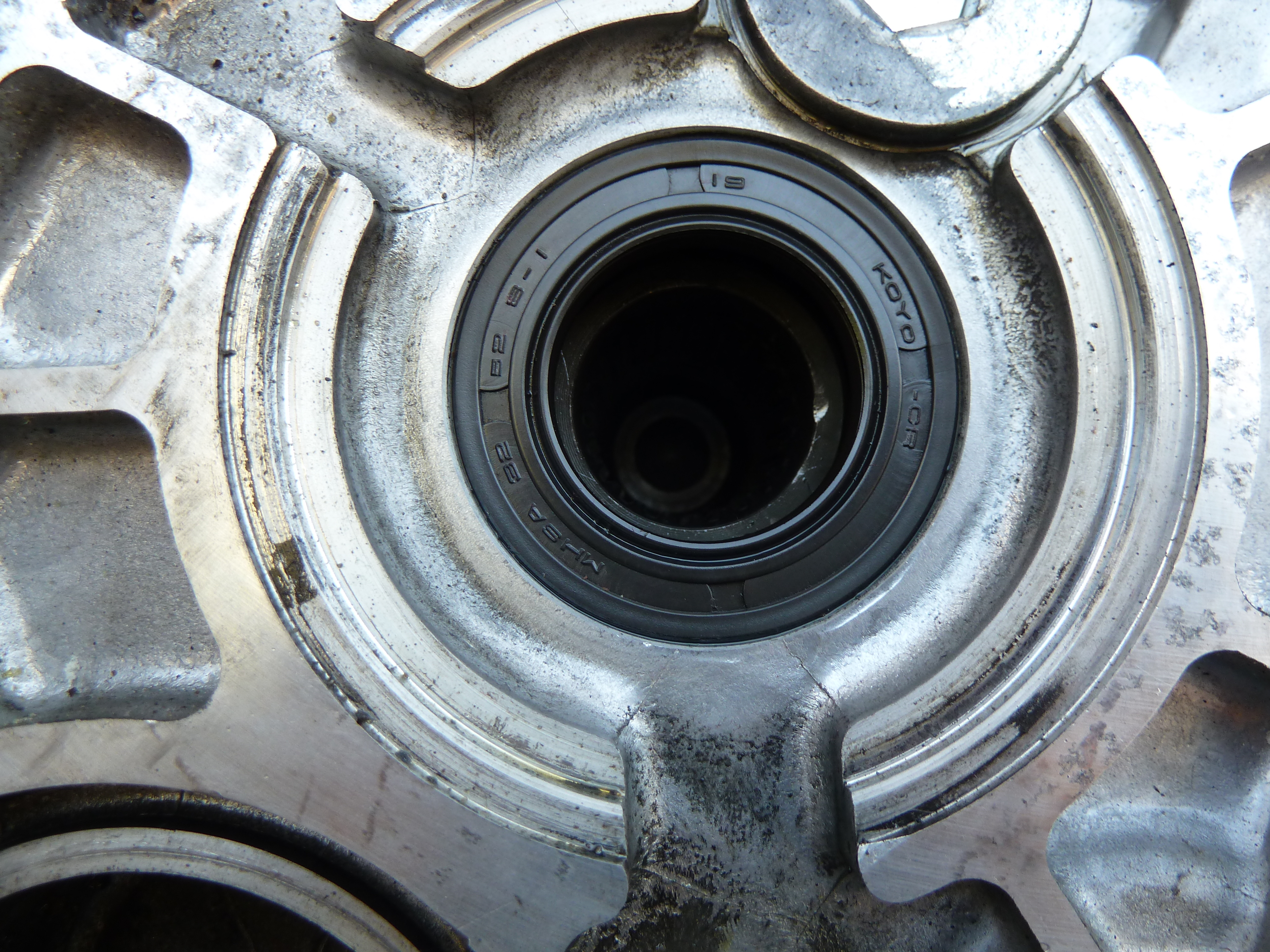

Well I got the transmission in, but had a few instances.
1.) If you are putting your transfer case on a junkyard transmission make sure you order a new oil seal that goes between them. I spoke to the Koyo Dealer in town and he did not have that seal, he could order it, but it would have taken him longer to get it. Whilee you are there buy the boots that broke when you removed them. Factory boots will last 20+ years compared to the 2 - 3 years you might get with after market seals.

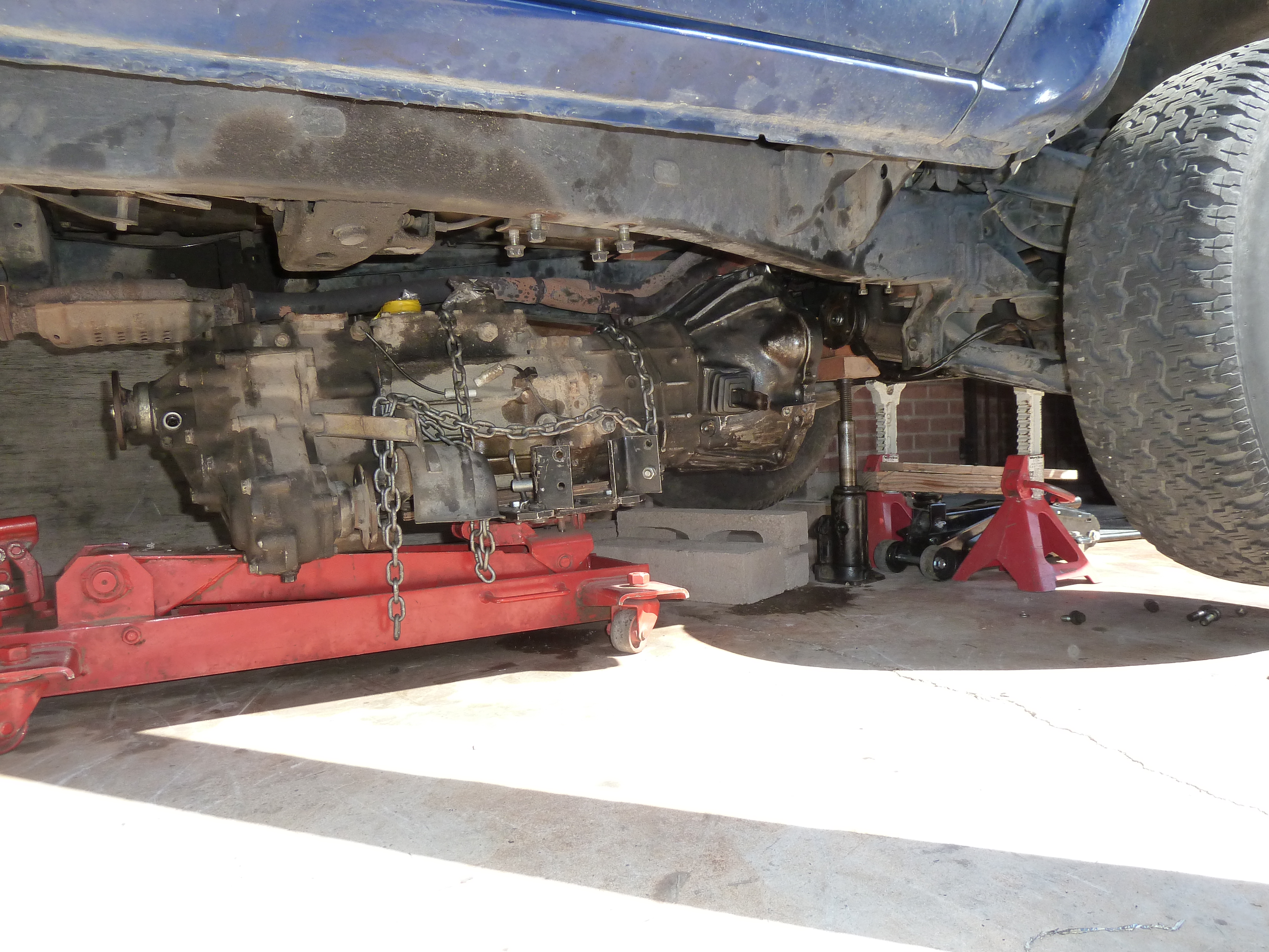

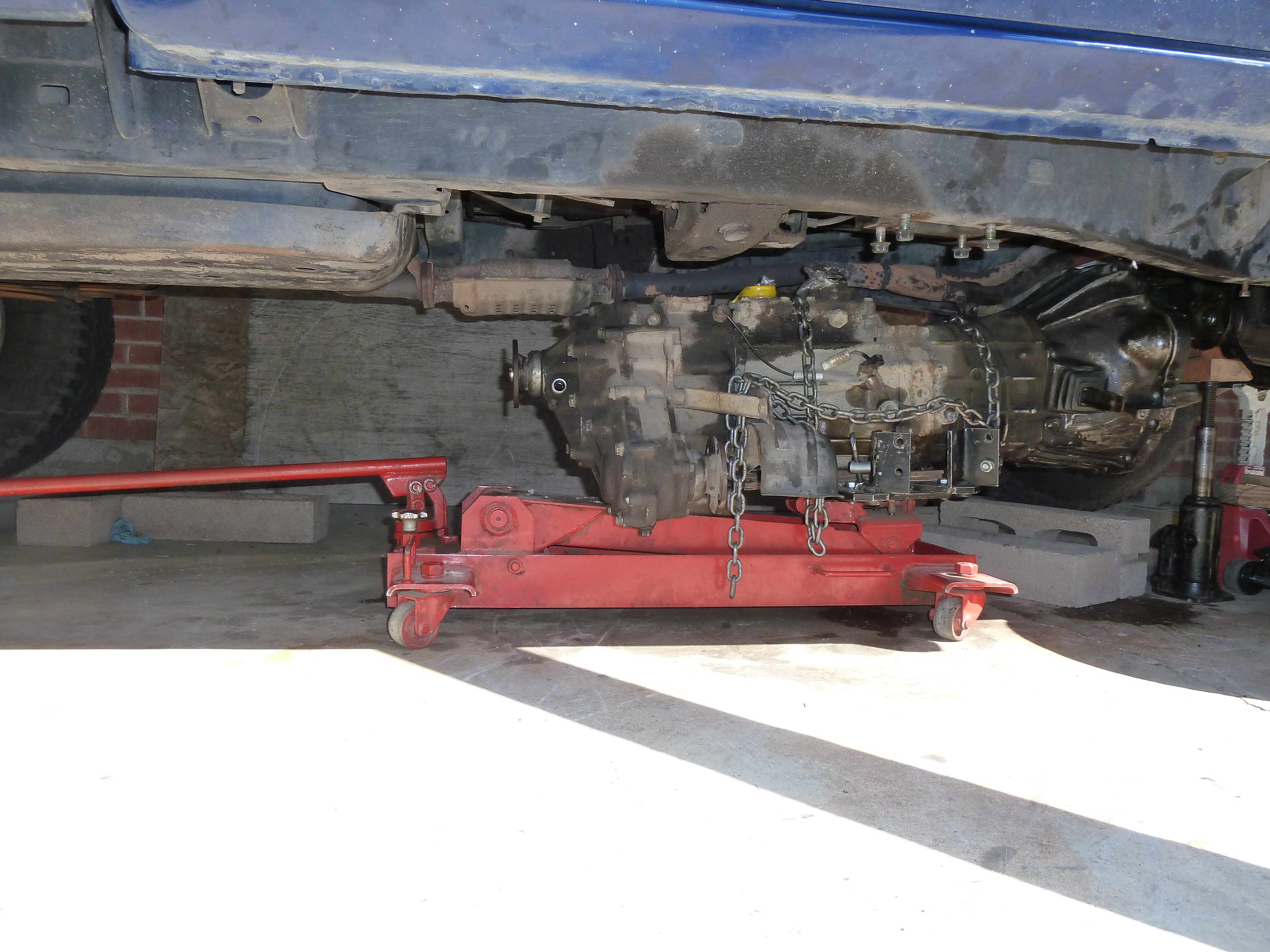

I rented a transmission jack, it was a beast and really too big for what I needed, as you can see I had to put the truck on jack stands to get the jack and tranny under the the truck. If you look closer you will see that the transmission actually sits taller then the frame of the truck. I had to jack the front of the truck up even higher. I topped out my jack, even with a block of wood on it, and it still wasn't quit high enough. I was able to push the jack with my feet and the tranny rolled just a little allowing it to slide under the truck... Thank God for the transmission jack, I don't think I would have got the tranny in without it. But it still took a lot of work getting everything lined up and it together.
