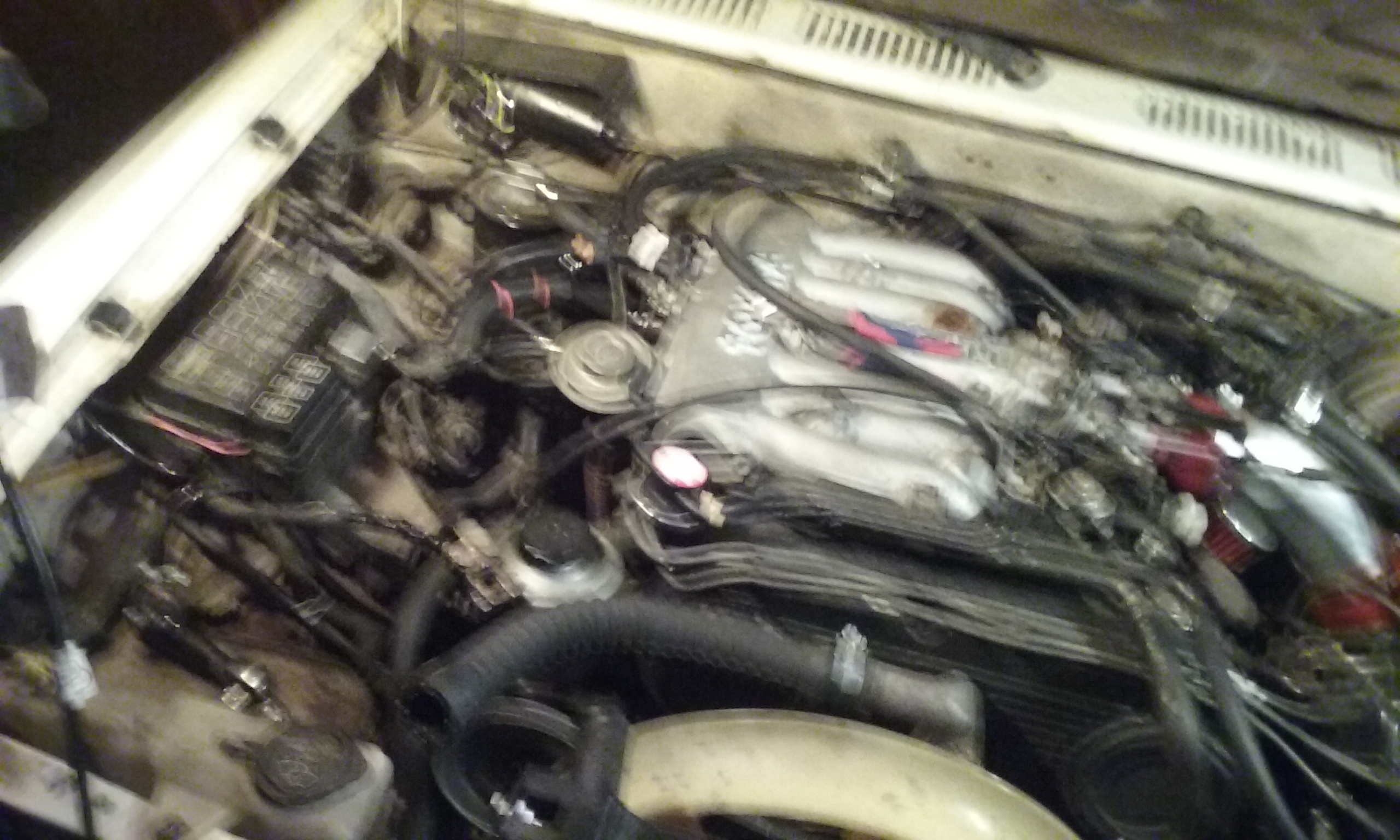

What's up my fellow 4runner Fanatics?!?! I'm making this thread as a sort of "show N tell", to show everyone else the past 4 months of Mods and rebuilding work that I've put in on my 1993 4runner 4x4.
I began this lengthy project on 10/15/2015, and have finally finished all the custom and oem work today, 3/07/2016. The work has been tough, frustrating, and pricey; but it has been soooo worth it. I now have peace of mind while rolling on & off-road.
When I started, my 4runner ran perfectly fine, but had a few fixes and issues that needed to be taken care of, of which included; my alternator was going out, I needed new Water Pump, Thermostat, crankshaft/camshaft seals, valve cover gaskets, radiator, power steering pump seals, a few auto transmission problems, etc..etc.
I ordered most, if not all my replacement parts from www.rockauto.com, and about half the parts I got were aftermarket/high performance.
Anyways, I started off by replacing my Catalytic Converter, o2 sensor, Drained ATF FROM A/T & Transfer case, A/T shift control solenoids, ATF pan filter/gasket.
Then I Replaced/Rebuilt/Modified:---->

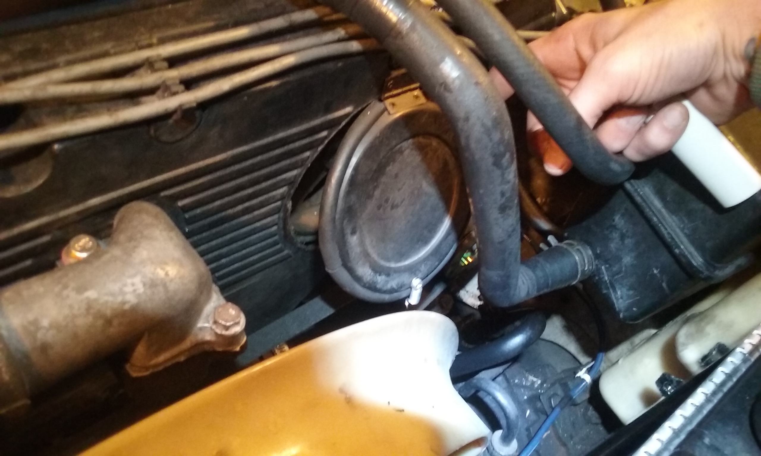

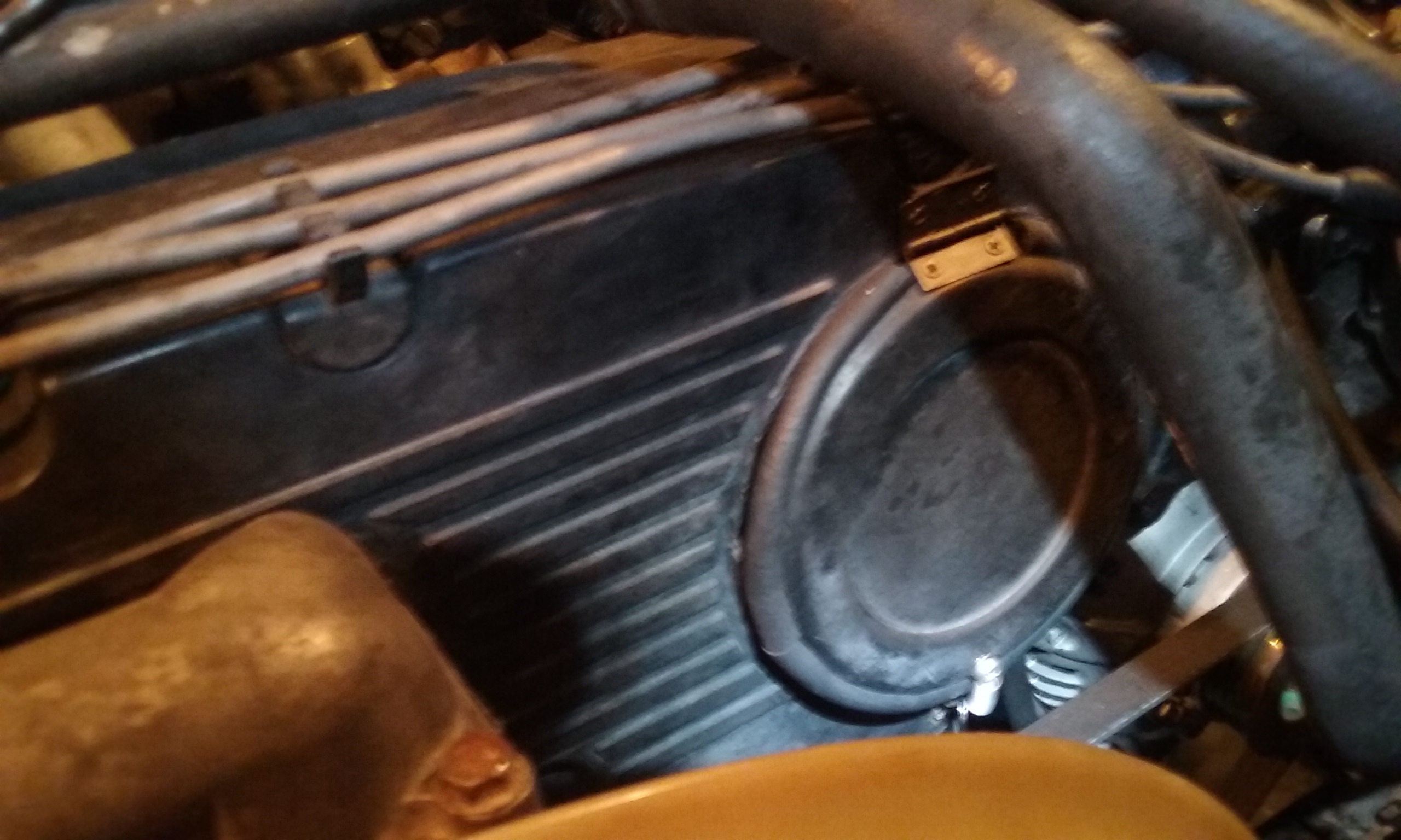

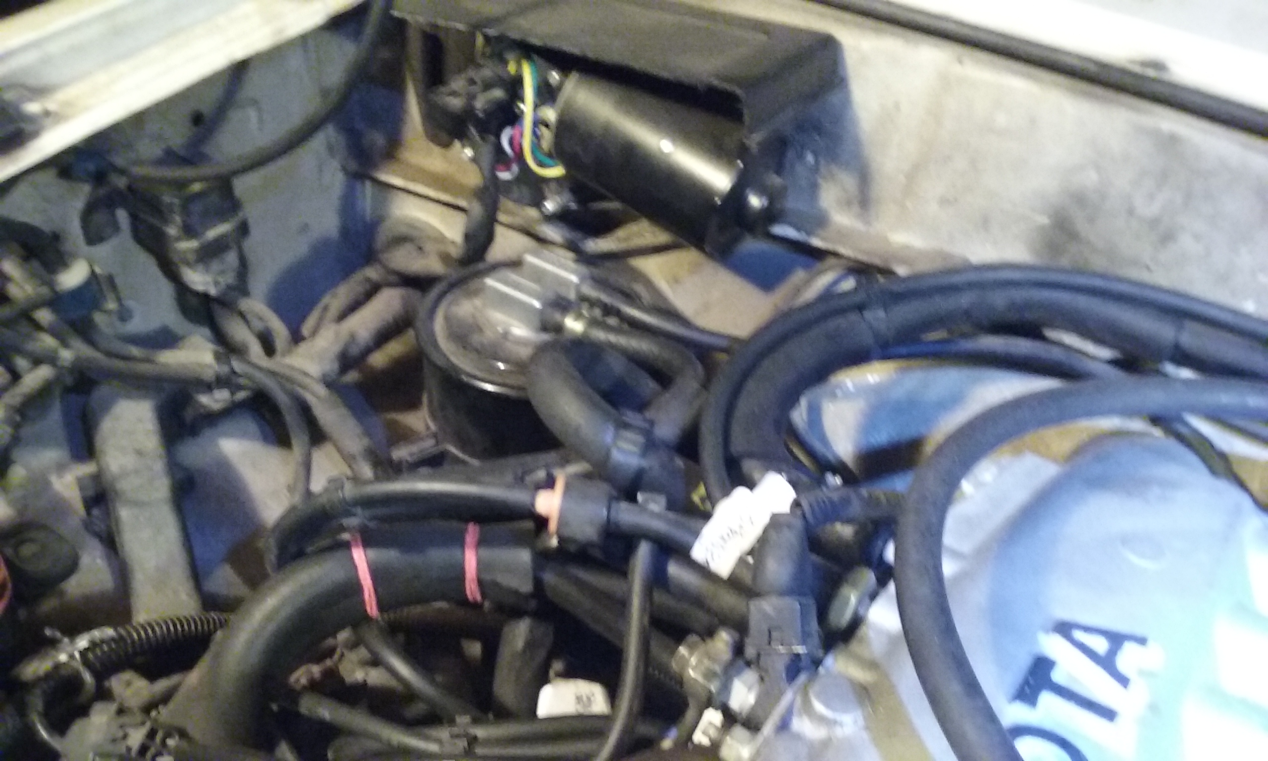

☆Custom rain shield for windshield wiper motor.
☆Rebuilt power steering pump with new seals & gaskets.
☆Replaced Water pump & Thermostat.
☆Replaced idler pulleys.
☆Replaced Timing belt & drive belts.
☆Custom Ported Hinged Doors for camshaft/timing cover.

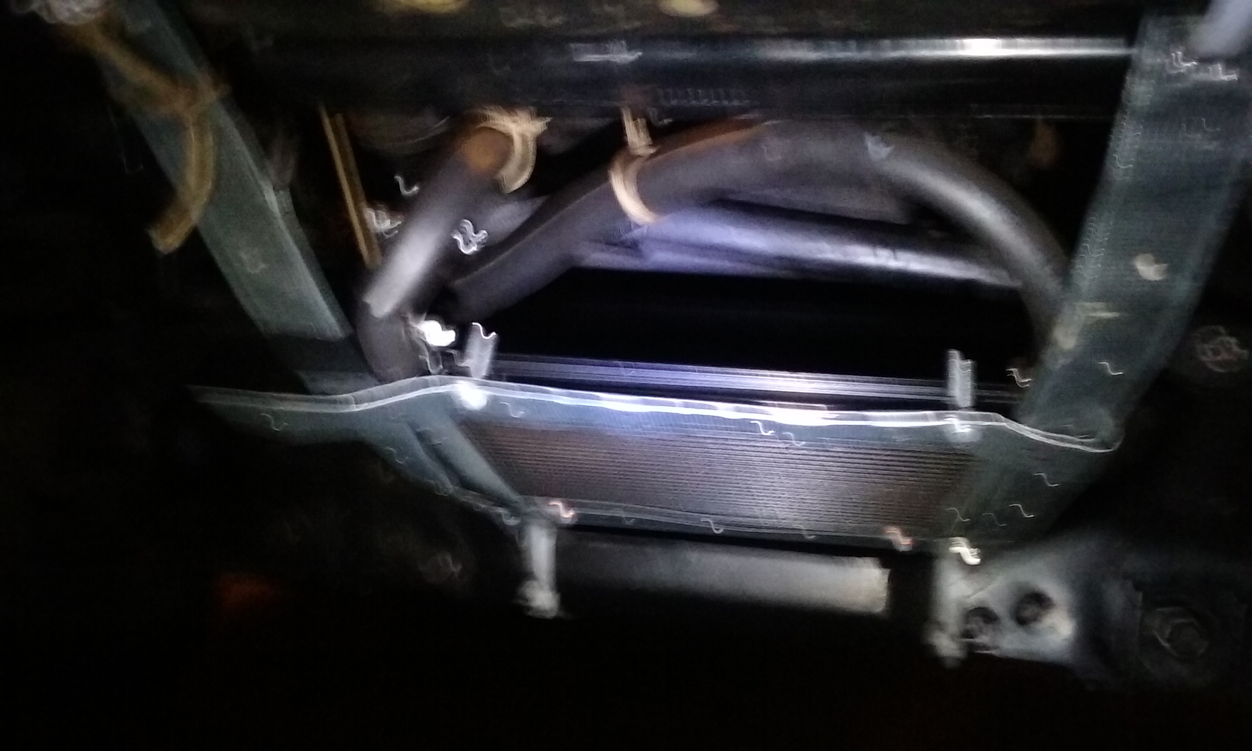

☆Custom install of Hayden ATF oil cooler:
☆Bypassed stock Radiator AT oil cooler (NO MORE STRAWBERRY MILKSHAKE 4 ME! :] )

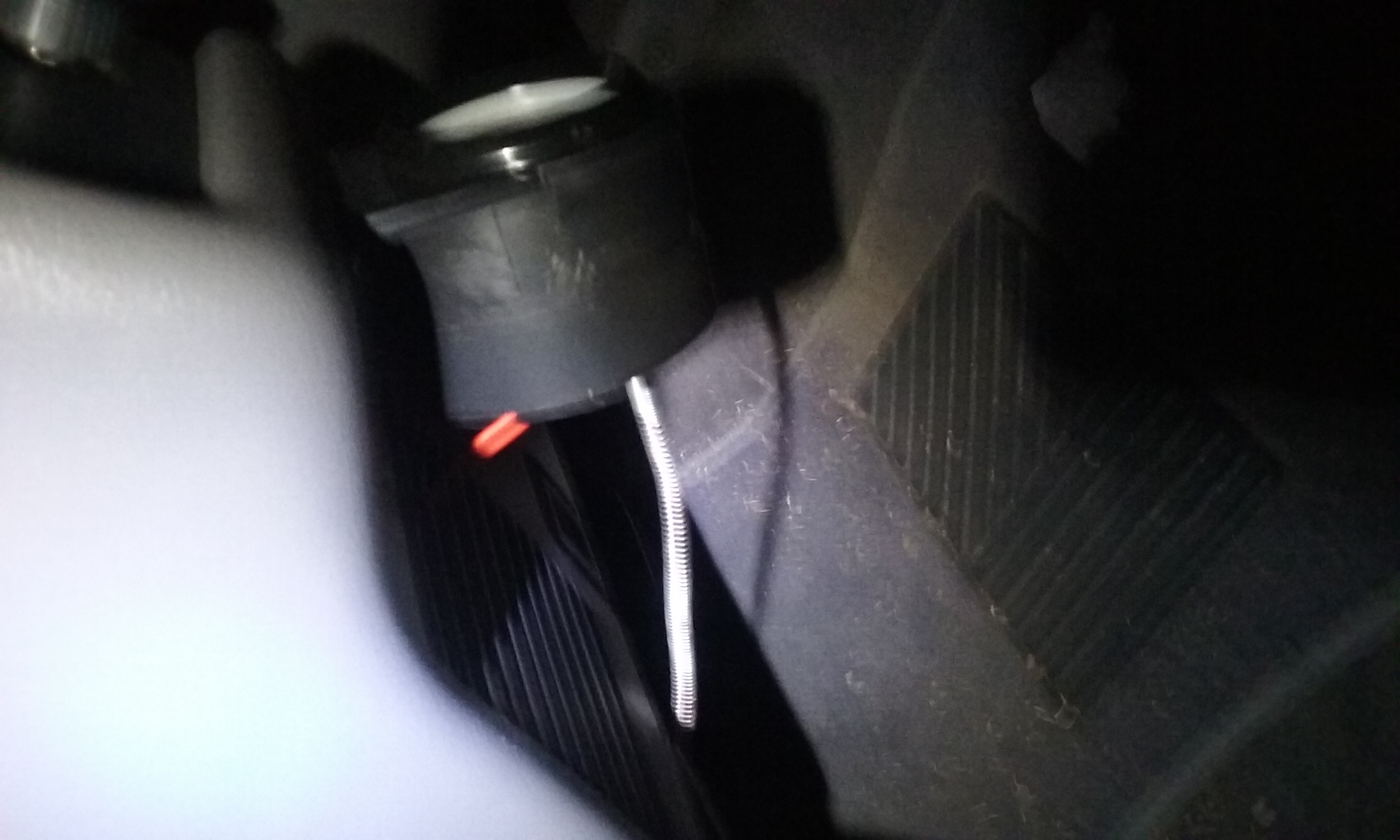

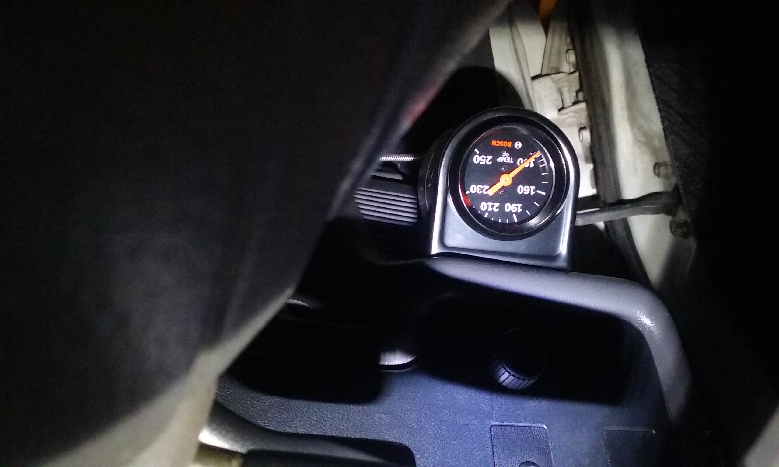

☆Custom AT Oil Temp Guage install just under left driver side of dash/cluster.
☆Rebuilt windshield cleaner motors & reservoir (front & rear)

Attached Thumbnails My 1993 4runner 3vze A340H rebuild/mods show & Tell w/ LOTS OF PICS!-20160304_013241.jpg   My 1993 4runner 3vze A340H rebuild/mods show & Tell w/ LOTS OF PICS!-20160304_013131.jpg   My 1993 4runner 3vze A340H rebuild/mods show & Tell w/ LOTS OF PICS!-20160304_013037.jpg   My 1993 4runner 3vze A340H rebuild/mods show & Tell w/ LOTS OF PICS!-20160304_013023.jpg   My 1993 4runner 3vze A340H rebuild/mods show & Tell w/ LOTS OF PICS!-20160304_012902.jpg
My 1993 4runner 3vze A340H rebuild/mods show & Tell w/ LOTS OF PICS!-20160304_012747.jpg   My 1993 4runner 3vze A340H rebuild/mods show & Tell w/ LOTS OF PICS!-20160304_012511.jpg   My 1993 4runner 3vze A340H rebuild/mods show & Tell w/ LOTS OF PICS!-20160304_012427.jpg
