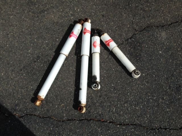

AND, I have a complete set of KYB gas-a-just shocks that are in good condition off my rig on Craigslist right now.
i swapped them out because I thought they were too stiff when I had the same brand on my 67 Camaro.

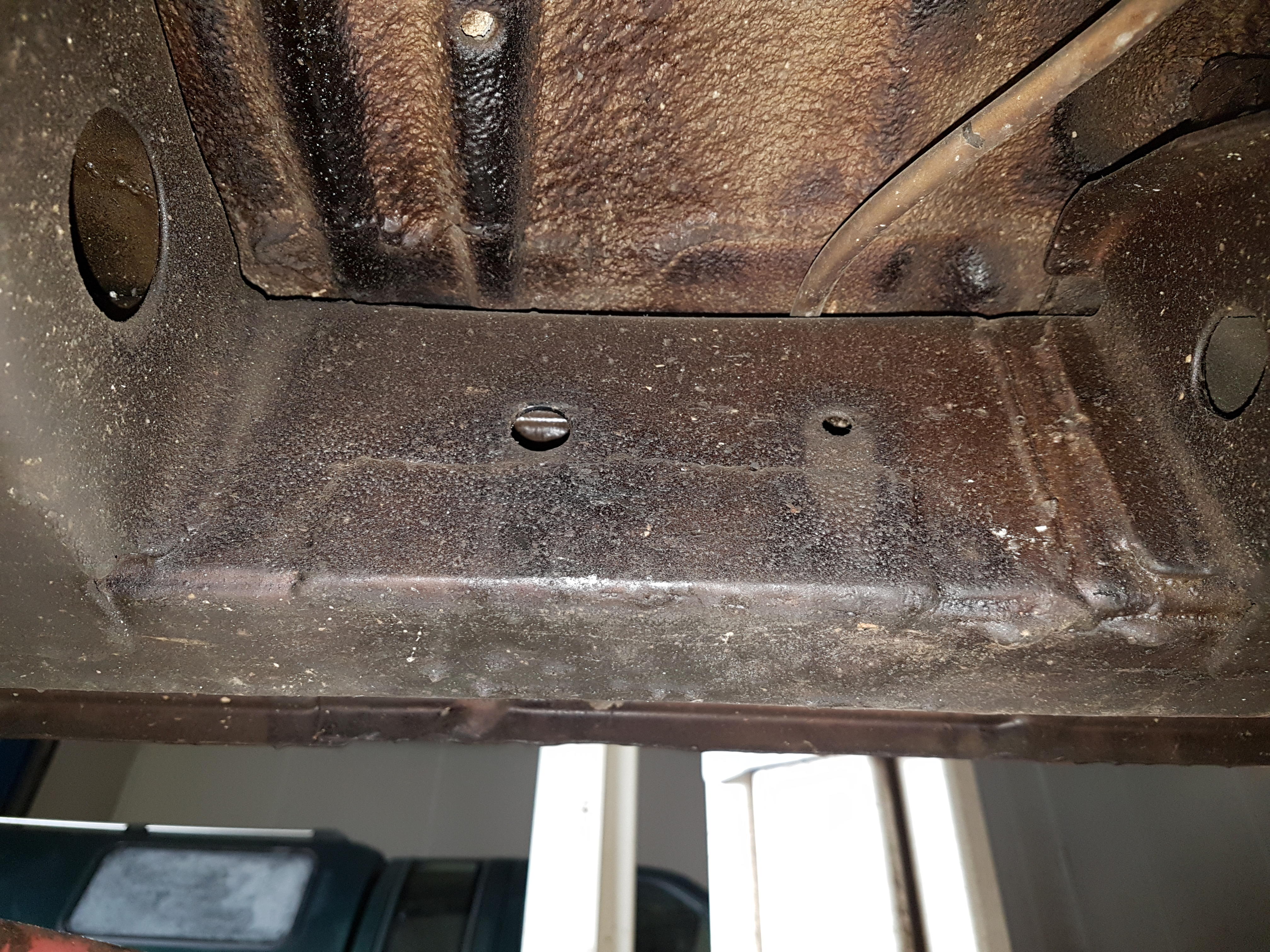

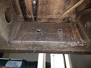

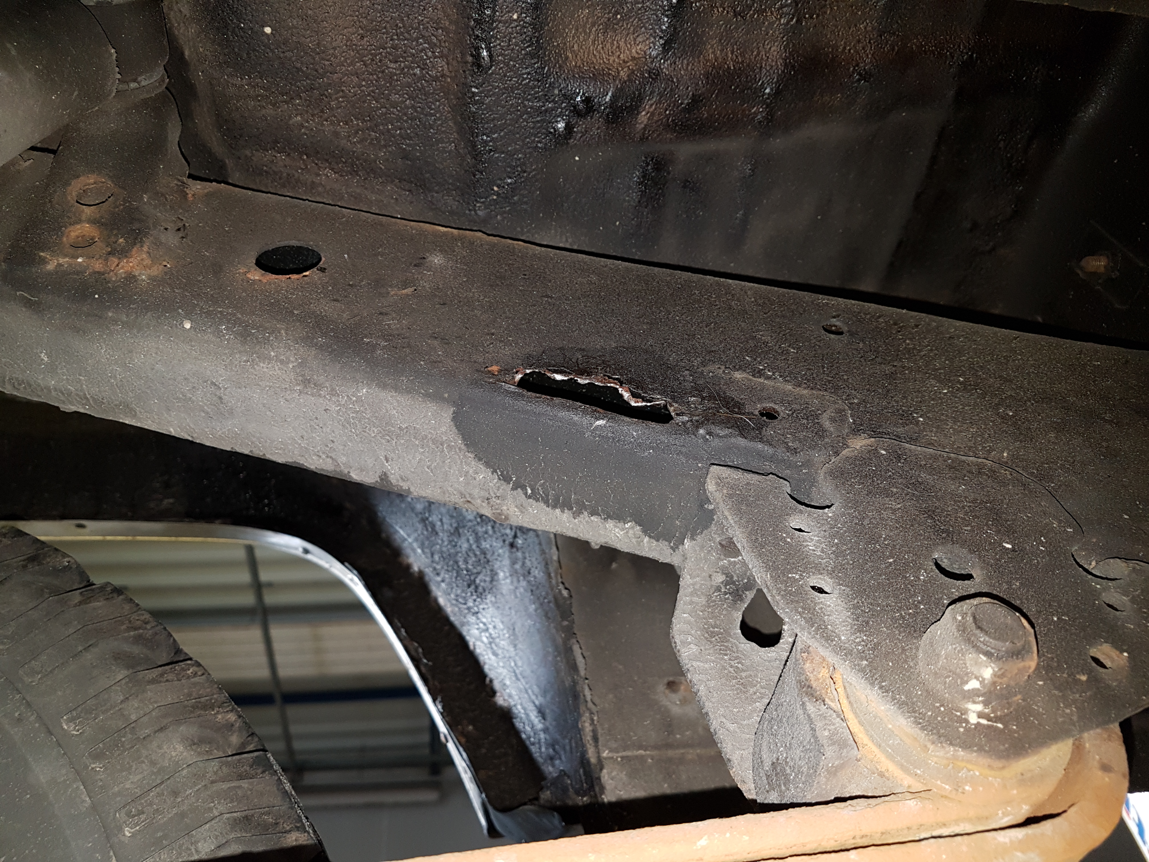

You'll want to poke at the dogleg sections of the frame also, this is the hump over the rear tire where dirt collects and then holds moisture, the lower bend will rust thru if not attended to in damp and dirty condition the upper bend is the high stress pont that tends to collapse when the truck has been "jumped or abused".
This is an example of what Co_94_PU says. I went to see a 30 years old Toyota truck a few months ago. It was for sale, original paint, clean, shiny, around 100000 miles on the clock, in good shape, the owner took care of it, it had some sort of wax oil or fluid fim in the interior panels (I could see that when I removed the back seat pockets) and underneath. I went under the truck and I saw a suspicious patch in the frame (you can see it in the first photo attached). I took a little hammer I had with me and what you see in the second photo it's the damage I did, I could break the frame very easly, that truck was a time bomb, rotting from inside out.

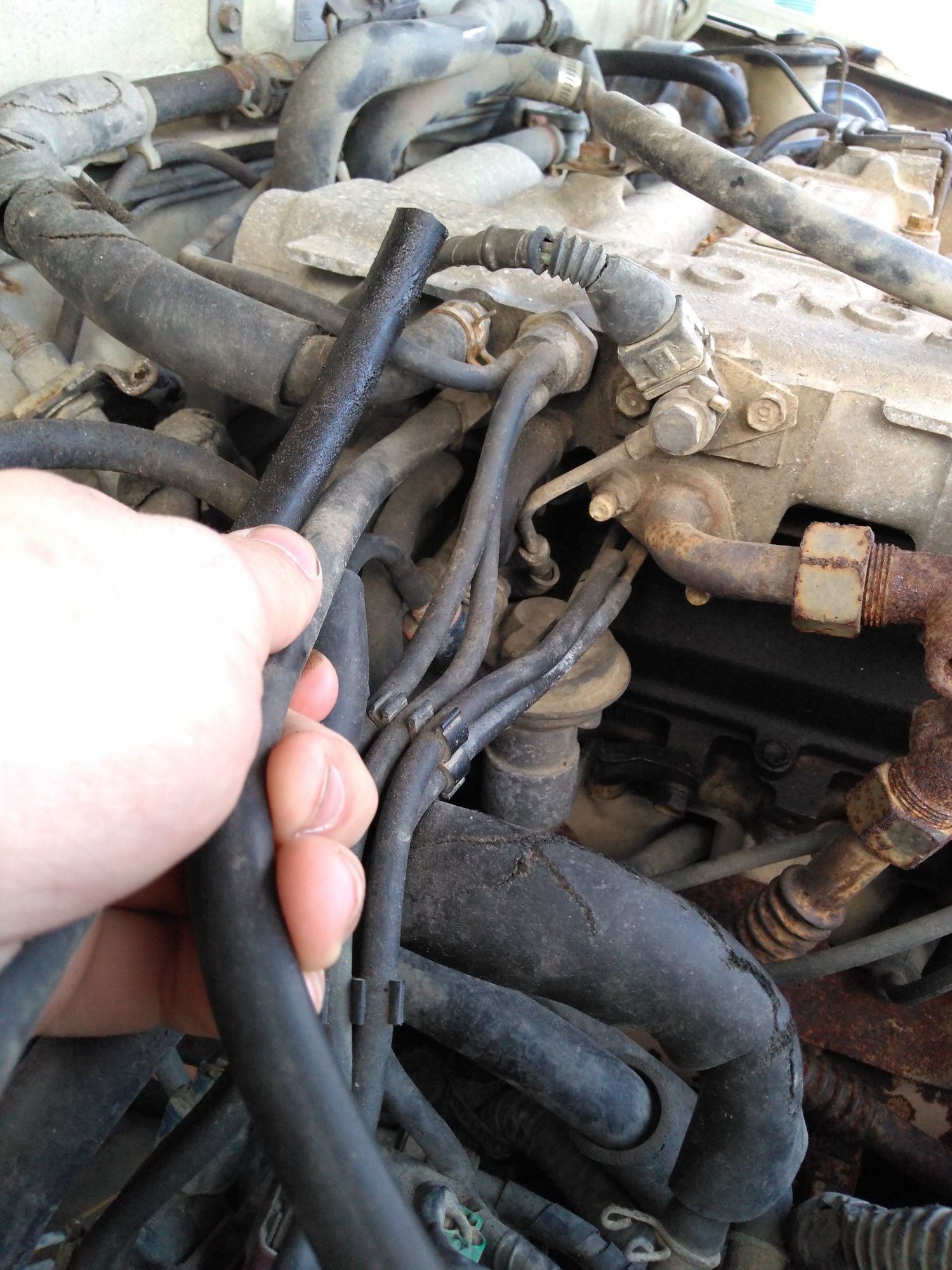

On another note this was the loose hose in the video I linked in an earlier post. If anyone could tell me what this goes to I'd be quite grateful and they may or may not get first dibs on parts that I don't need.
