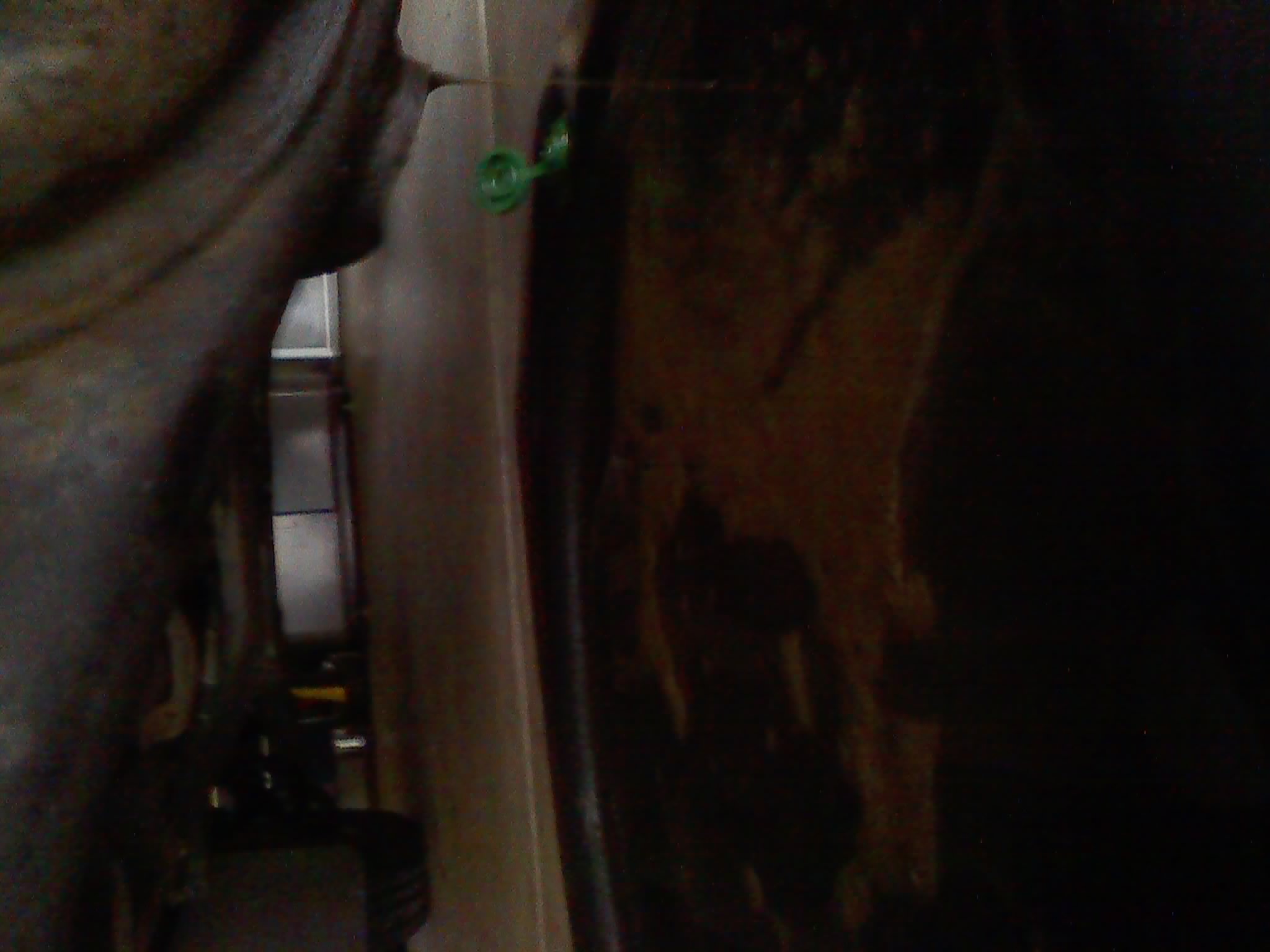

So ran down to the store and grabbed some lucus synthetic 75w-90 draining the diff now..... here was the condition of the oil and what came of the magnet on the drain plug.... its basically all black and the drain plug was overflowing with metal sorry for my terrible camera

So, let the diff drain for a couple of hours, went to check if the bottle would fit in the hole and the cap fell in. needless to say a vacuum and airlines couldn't get it out. so i will be out of commission until i can call a mechanic with a snake that will make a house call... and whoever had this diff before me welded the cover on the non drive-shaft side... thanks for that :ugh:
so overall dont put the bottle in with the cap on to check fitmint... foolish mistake on my part.

Well that's sucky. Just plastic, though. All these rear diffs are that way. They're a third member design, so the access is thru the front, by removing the differential carrier. Waaaaay easier to regear, just swap in a third with the ratio of choice. Like an old ford 8 or 9 inch, way better than integral carriers. May be a good bet to run some cheap gear oil for a few hundred miles before putting in the good stuff. Just so you're not draining out your brand new oil in 300 miles... And yeah. As long as its from an 89-95 truck/4runner, it fits.
