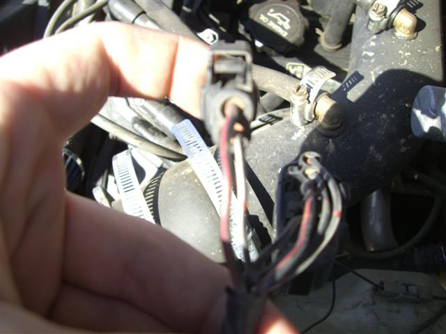

Here is the adapter from the OEM Coil that you will be tieing into.
Attachment 180833
It is the one with only 2 wires going into it. The other plug will be reconnected back to the stock unit.

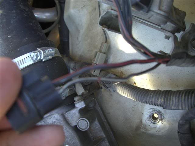

On the OEM Coil I recommend that you peel back the "electrical" tape and expose more of the wires. Since you will need to cut into and splice into these here you want to give yourself plenty of "slack" for the just in case problem.
Here is how much I peeled back to make this easier for myself:

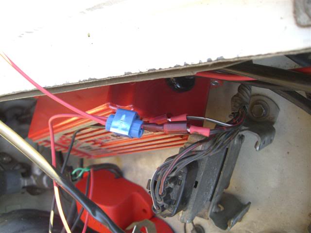

Next on Step #4 I said that you will need to connect the red wire, the red 18ga from the MSD-6A and your OEM coils power wire together. Here is how I did mine.
Attachment 180836
As you can see I simply joined the 2 red wires from the MSD equipment and connected it to the OEM "Black and Red" wire.
