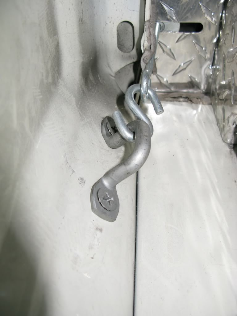

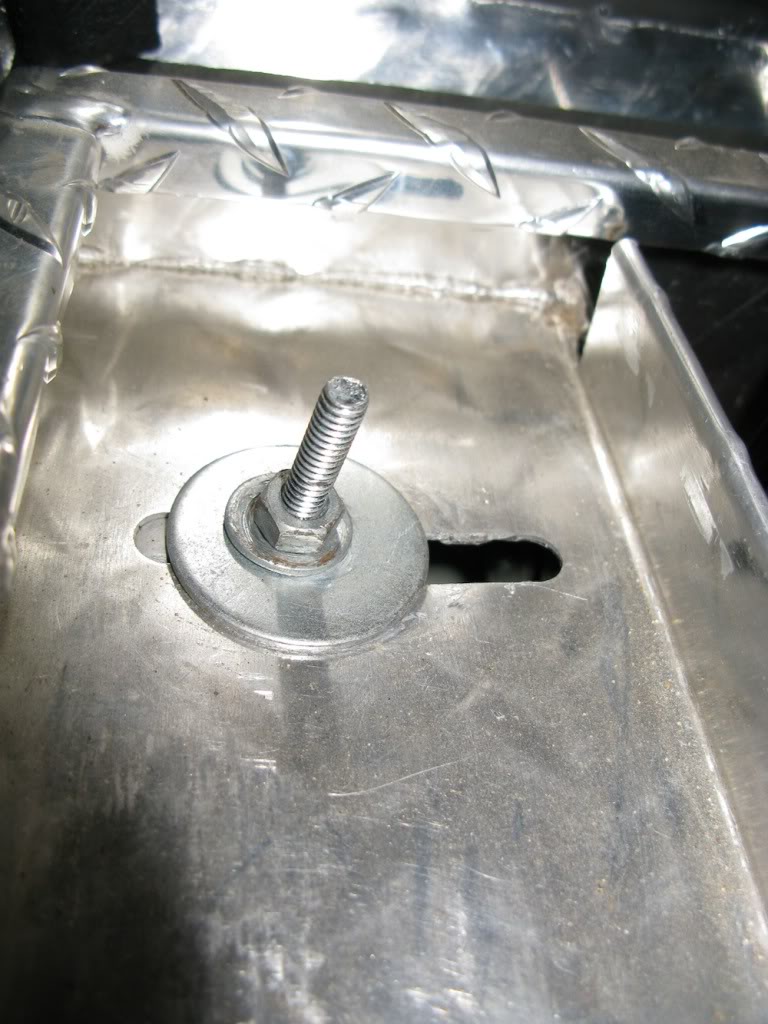

Here's how I did it. Similar Idea.
S hooks (which I had to file a little to make them fit over bed mounting points)
Threaded eye hook.(unsure of actual name)
Also, I used a little bit of foam tape to stop the hardware from rubbing on the inside lip of the truck bed.
Hope that helps.

I like that idea^ I forgot about those u shaped bed mounts in the front of the bed.
Thanks!

haha, now that I look at those pictures, I see that my truck already had holes drilled in the bed. I bought the box used and that's the hardware that came with it. I never really considered mounting it a different way...
