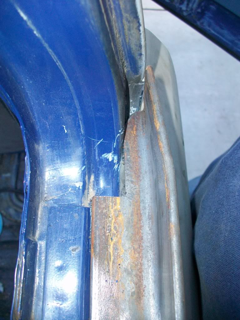

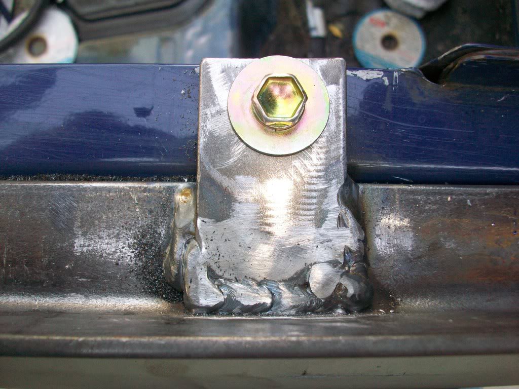

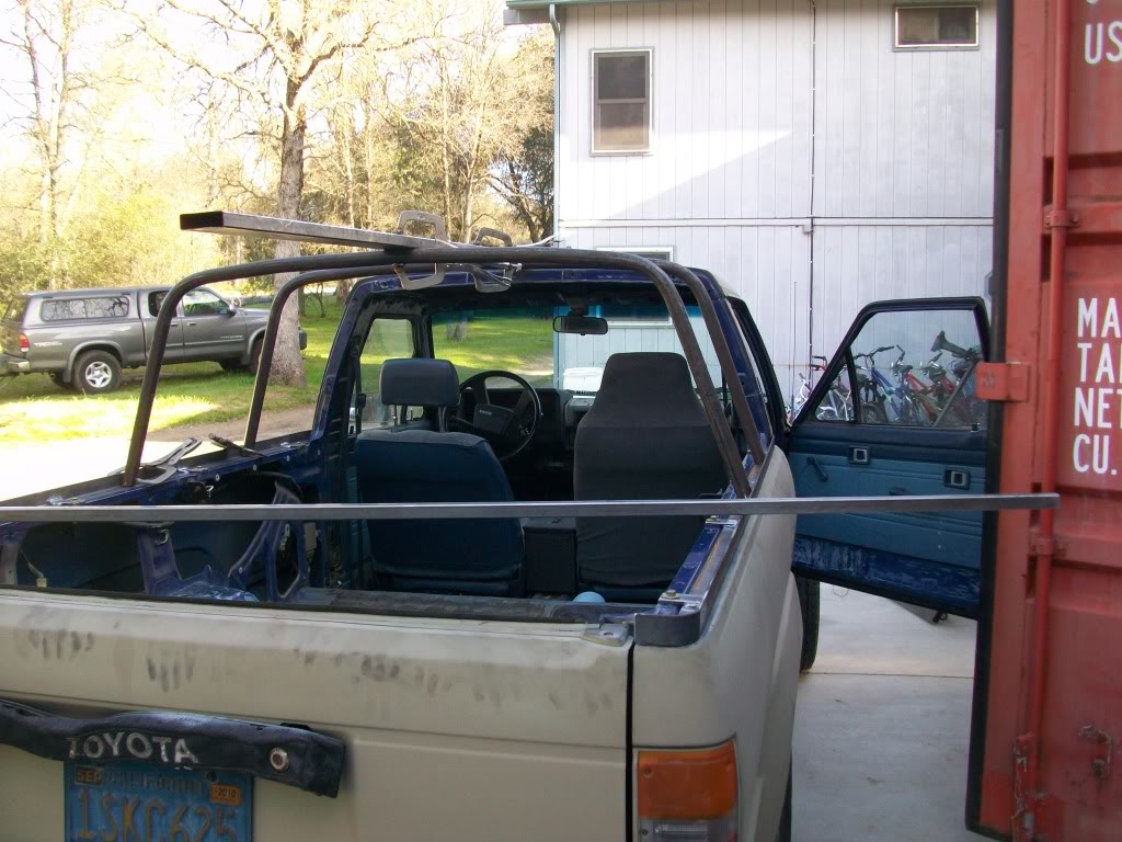

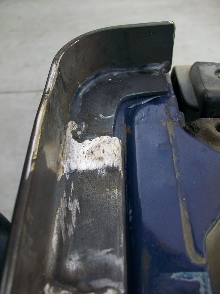

We decided to make the bed rail portions out of 3/16" x 1 1/2" angle iron. We cut and drilled some tabs so that we could mount it to the existing bolt holes.
The angle iron sits just to the outside of the small ridge on top of the bed rail. We cut the it long enough that we could sort of cope in the bottom to fit around the pinch weld at the front of the bed rail. This allowed us to bend the side of the angle in a bit to match the contour of the cab. It should make it a bit more weather resistant.
If I had been doing this myself, the tailgate ends of the angle iron would have been square or perhaps at most would have a couple of bends in them to finish the end. However, my friend who was helping me on the project had other plans (and more skill and imagination than I have). He cut the angle just short of the bend, then massaged in a piece of plate that matched the curve and a piece of flat iron that he bent to match.

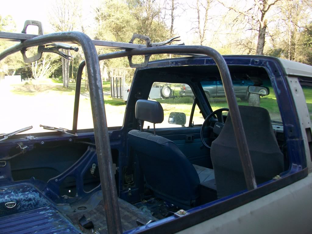

We used Schedule 80 (cut into 92" lengths) pipe for the three upright "hoops". We gave them a little bit of a bend at the mid point, then another bend one foot to either side of the mid point. We didn't measure the distance for the final corner bend, but fit the first piece up to the rear of the cab and simply marked the middle of the bend. We did end up cutting about 2" off each end of each hoop, and cut at about a 30 degree angle to get it close to flat on the inside of the angle. I ground back the outer edge of the corner to fit them in. The second hoop was a copy of the first. We designed the third hoop to lean slightly forward, and as such only ended up cutting about 1" off either end. There was a lot of grinding and test fitting and regrinding and retest fitting, but we didn't want any spring in the hoops to make it a pain to install the top later on.

We also added a piece of 3/16" angle iron to the side of the frame, 16 3/16" up. We cut out notches for the hoops and fitted the angle up such that the vertical side is just outside the hoops, and the horizontal side angles down toward the opposite fender. This will later be drilled for use as a tie down location. The outer portion will be drilled in a few places in anticipation of a later basket or lumber rack addition such as the canback (or Marty4Runner) uses.
I have the bed rails and hoops finished, and the right side angle iron horizontal brace done. Hopefully Thursday I will be able to finish the left brace and get started on the final forward snap portion. My original plan was to have the "snap plate" be independent of the rest of the frame, so that I could remove the rear portion and not worry about removing the front if I wanted to carry something large. Instead, I will just have to undo those bolts as well. We are going to use a piece of 3/16" angle iron for the snap plate. We are planning on notching it and bending it to fit the contour of the rear of the cab, then drilling it for the existing bolt holes. It will be welded to the bed rail and the two horizontal braces, making one very strong, very rigid frame. I will use twist snaps (or "common sense snaps" if you want to pay more for the same thing...) at the corners of each canvas portion, and will make up the difference with conventional snaps. I am planning on using either six or eight straps to tension the top canvas piece (2 at the back, and the remainder along the sides) so that I can pull it taught and snap it. The sides and back will be under a bit less stress, but I will still use a few twist snaps to help in pulling things tight. The only thing I don't really have a complete plan for yet is the back panel. I'm deciding between it being extensions of the sides which will snap together in the middle (allowing me to roll up the sides rather than have to roll up the whole thing) or making it a completely separate piece. The top portion will probably measure about 4' x 6', with the sides being closer to 22" x 6.5'. A couple of 5x7 military canvas tarps should do nicely.

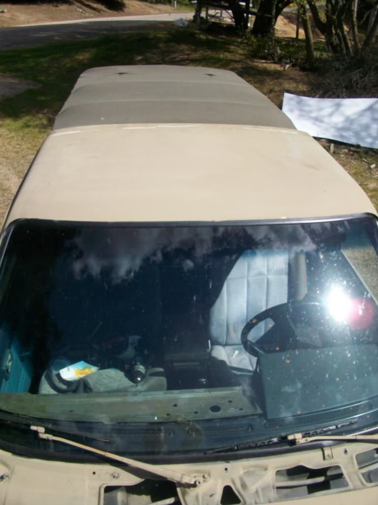

I discovered another bit of serendipity. I'm not certain that I will make use of it, but the thought is now there, tumbling about in my head. It turns out that the rear window, when rolled up, just hits the inside of the canvas. I am considering the possibility of retaining the rear window (though I had previously wanted to remove it and make a storage area in the tailgate), and figuring out a way to semi-seal around it with side portions a bit longer than I had planned.

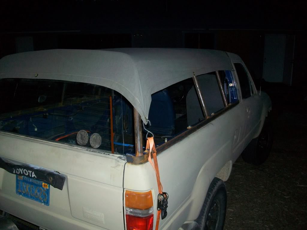

We got the front strap formed and attached today. As usual, pics will have to wait until daylight.
We used 1"x1"x3/16" angle iron. We started by cutting notches for the two middle cab bolts. We bolted the piece in to the middle two, then cut notches for the next two to the outside. We also cut a notch that was just the width of the blade in between the inner and outer bolts on either side. This was followed by a series of about six small notches to allow the corner to be bent. Upon bending and notching for the bottom two cab bolts, we tacked the bend notches and fit the piece with some minimal grinding. We then shaped the bed rail piece of angle iron to the bottom of the front strap and welded that in. After finish welding and grinding, we were able to fit the frame to the truck.
The next step is snaps and canvas. I think I may go heavier than the 10oz stuff I am using now. I also have to get some rubber welting to help seal the frame to the cab and bed.

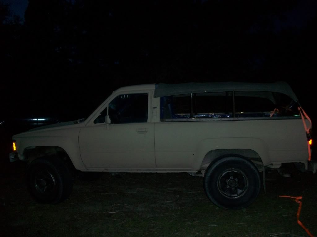

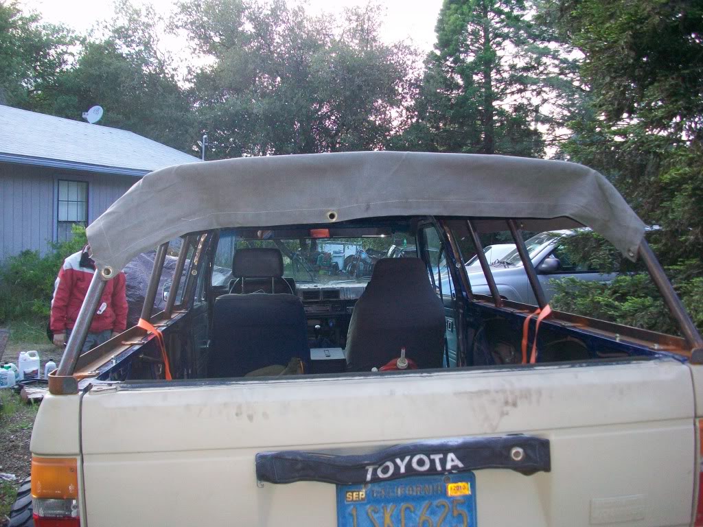

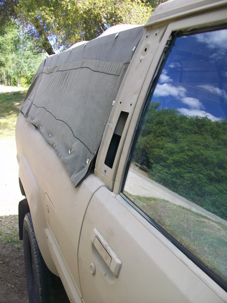

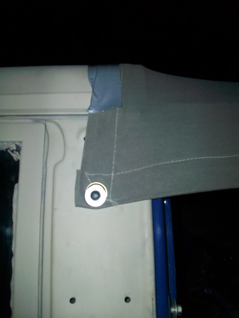

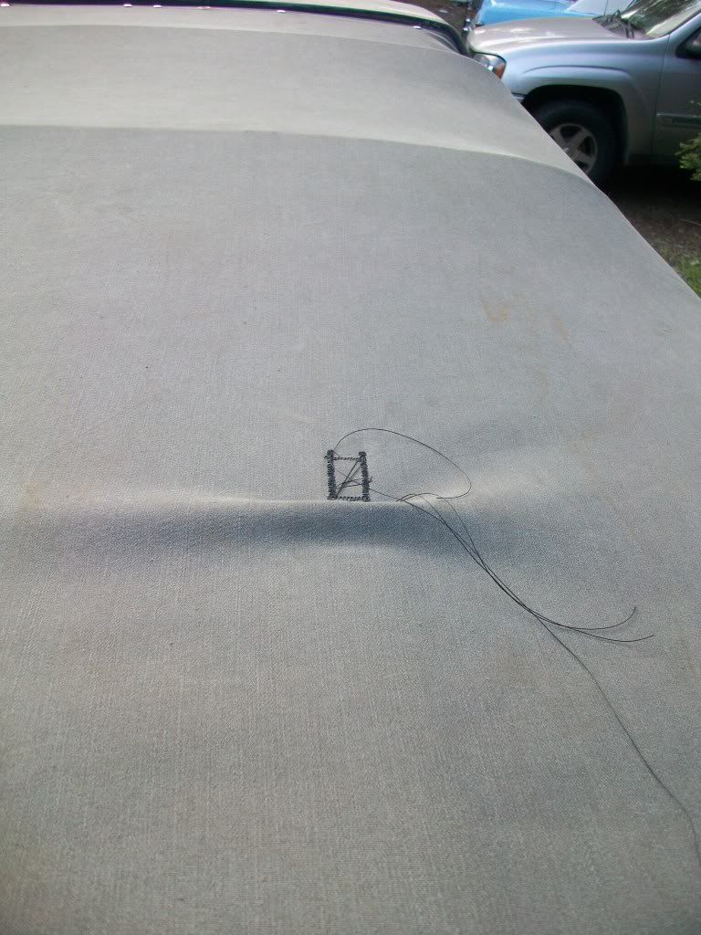

So... I've been slacking on both the 4runner and the soft top builds. This weekend, I actually got a little bit done with a lot of sewing help from my wife.

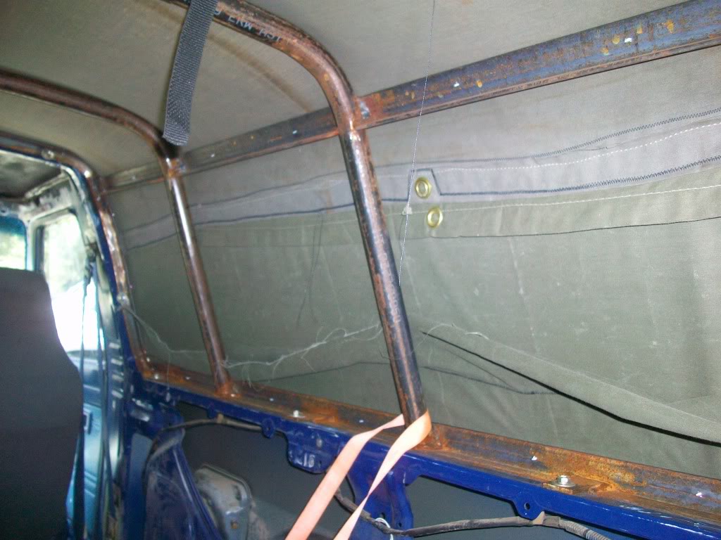

I ditched the idea of making the sides removable. If I ever decide I want to make sides with windows, they can snap inside the current solid canvas sides and the current ones can simply be rolled up.
I drilled 1/8" holes in the flat pieces of steel at the front and at the top and bottom of both sides. I will end up adding a few more, but I have about 25 in it right now. I then used self-tapping 6-32 x 1/2 screws to screw the male portion of a snap assembly into the holes.
I started with the front angle iron "hoop" at the top. I measured to the center of the tarp and used a sharpie to mark the line. I then lined the center line up with the center snap, and marked where I wanted the tarp side snap. I used a leather punch to make the hole. I then used the simple, cheap snap tools that I bought with the snaps to set the center snap.
There are basically three types of snap tool. The most expensive ($200+) is a bench-mounted unit. The $20 range tool is of the plier type. I couldn't find one locally, but I did find the cheap (+/- $3.00) two part tool, which is basically a base and a long punch. You set the snap top upside down in the base, with the stud in the middle through the hole in the canvas. Drop a snap receptacle (female side) over the stud, place the punch on the stud, and tap it down with the hammer. Once you get used to the manipulation of it, it is quite easy, and works surprisingly well. I don't know that the plier style would have saved me much time at all.

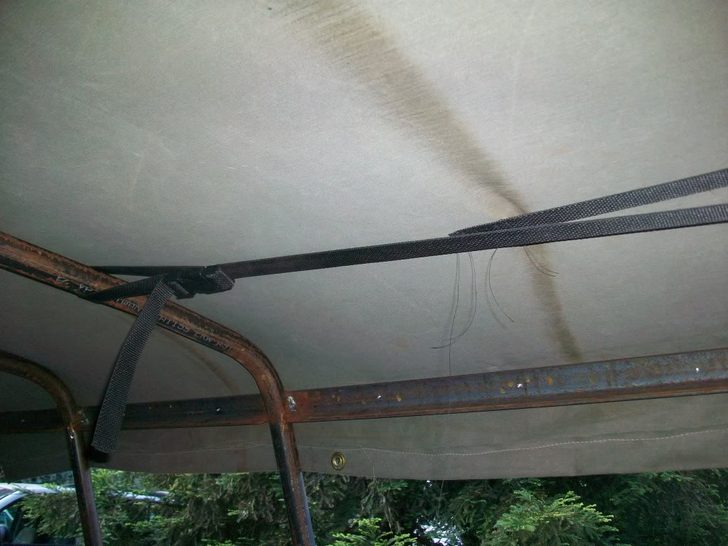

I then worked my way out from the center, stretching the canvas as I went. I would use one hand to stretch the fabric, then mark a dot with my sharpie at the TOP edge of the snap base. This resulted in a reasonably taut fabric. I alternated from side to side down the top strap with the top portion of the canvas. I didn't sew the sides on until I was done with the snaps on the top.
Once the front portion was done, I sewed two 1" straps at the back end of the tarp, about a foot from the edge. The straps are about 5' long. They are used to go over the back frame hoop and then forward to tension the tarp. I used a couple of cheap buckles to adjust tension and make assembly and removal simple.

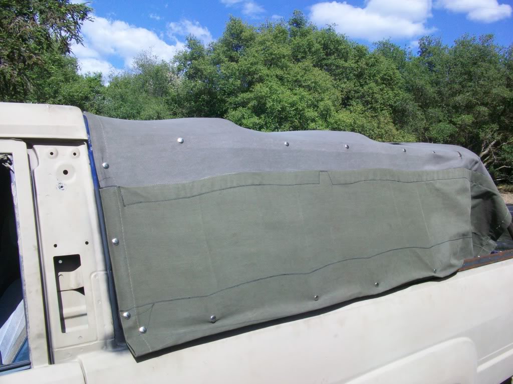

Once the tarp was tight from front to back, I began working my way from front to back along the top horizontal row of snaps. Again, I alternated from side to side and would pull the canvas tight before marking at the top edge of the base snap. This resulted in a a top that is fairly uniform in its tension, other than a couple of ripples behind the point where I sewed the straps on. I plan on resolving this by connecting the straps to the canvas all the way back to the rear hoop.
After the top was complete, we removed it and sewed the sides on.
I used one 5x7 10oz tarp for the top, and cut a second one in half. The halves were sewn to either side of the top piece. This placed the seams on the sides of the truck, rather than the top. The seams are an obvious weak point for weather sealing, so I didn't want to risk any puddling over them.
The sides hung down beyond the frame considerably. We measured them and then folded them up on the inside to fit them to the sides of the frame. We were going to cut the extra off and hem it, but then I figured out that it was in just about the right place on the inside to be turned into a row of pockets. That will be handy, especially while camping.
The bottom row of snaps went on just about the same way that the top row did. The stretching took a little more effort, but the result looks great to me. I ran out of snap bases and screws towards the end, so the last seven snaps aren't on yet. Even so, with the sides down, wind noise is no greater than with the fiberglass top and the back window down.
I haven't completely designed the back panel yet. It will be a little bit complicated, but I have a couple of ideas that should work. Does anyone know what material the pliable Jeep soft top windows are made of? I think it is some type of vinyl, but I don't know what thickness or if there is a certain type.
I still need to fine-tune my design for the straps that will hold up the sides when they are rolled up. I think it will be a small strap with a snap at one end, and proper hardware in line that I can cinch it tight. The snap will snap to the top of the canvas.
