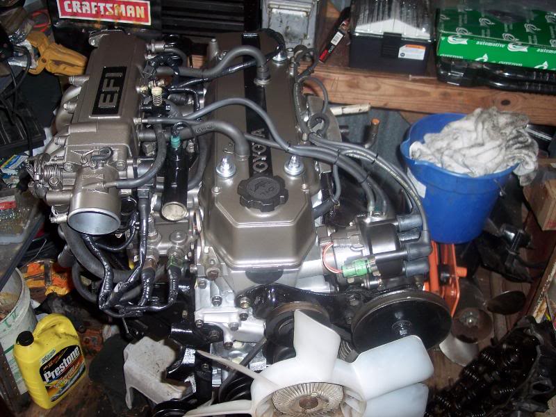

I've built several of these engines. They are not going to be powerful. One of my buddies in Mobile used to work at a shop with a dyno and he put his 92 truck with a 22re on the dyno with a 75hp shot of nos and it hit less than 170 hp.
I just finished this one.
On 33"s with 4.3 gears I can get to 70 decently, 75-80 on a good day with a tailwind.

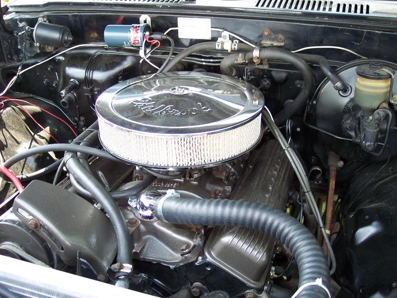

My ext. cab. though...
Will do a 3 wheel burn out on 35" boggers...
Funny thing is it costs less to build a decent 350 than it does a 22re!
