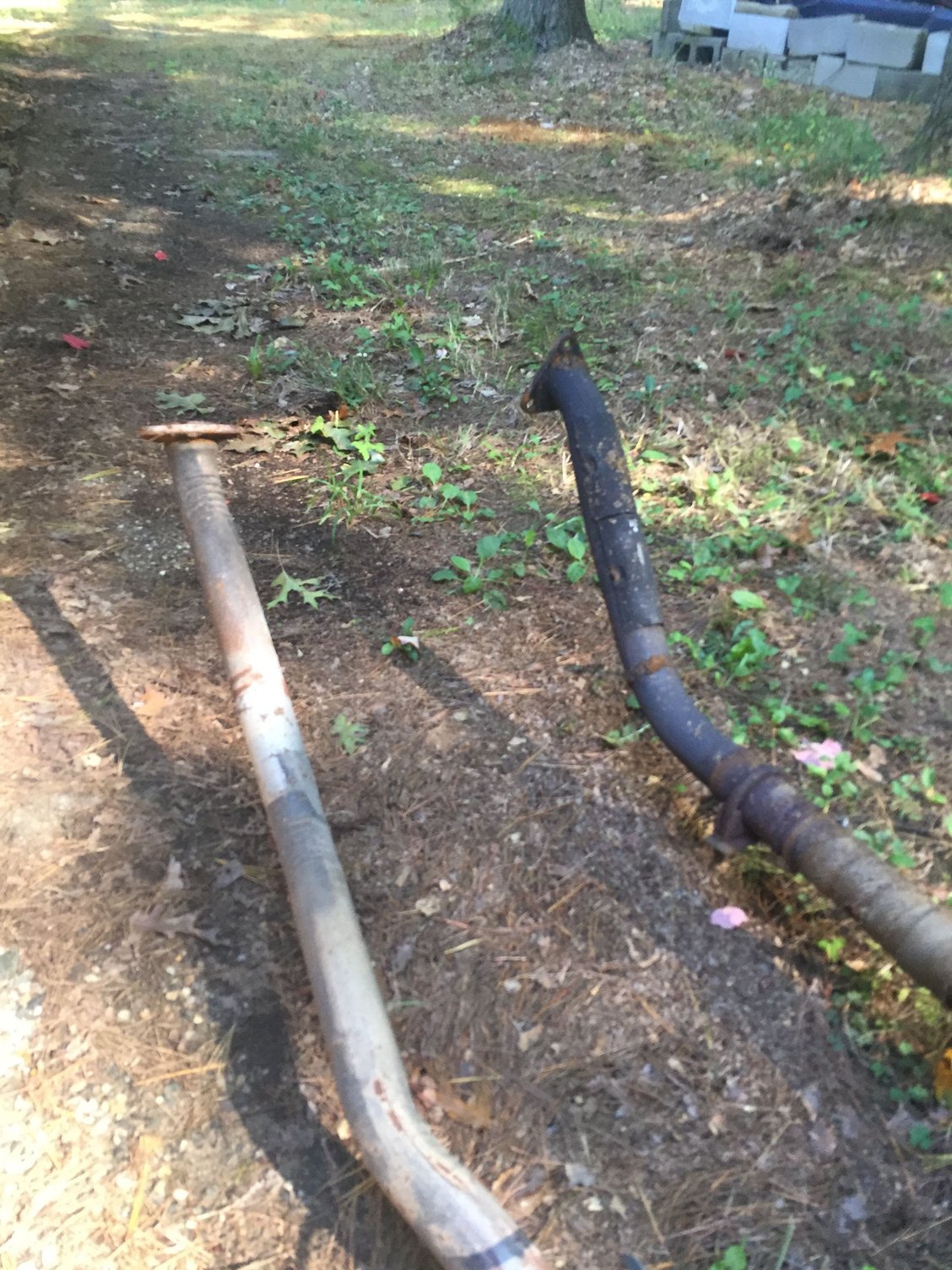

I made a custom exhaust for my 3.0 I went down the passenger side went all the way back and went behind the t-case under the drive shaft right the the flange. And went back and h piped it and ran duals the rest of the way back. Right now currently the exhaust is out of my truck but it is all still together I can take a pick and post it if you want

I won't be able to get the pic up for your till Wednesday

Sorry I haven't posted a pic of mine been really busy with work and working on my truck
