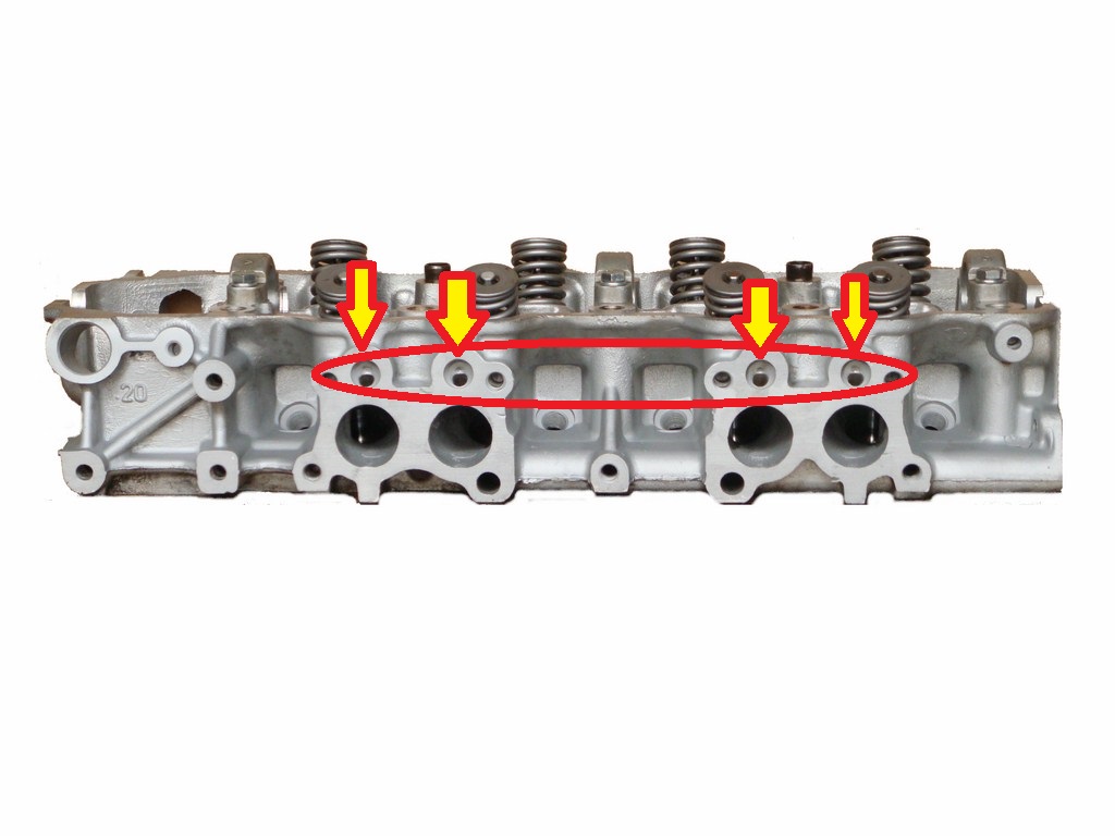

I have an 87 4Runner with a fresh rebuild. Block and head.
The block is a 22r with dome pistons and with an early efi R head.
The exhaust ports are circles with what looks like air intake ports on top.
I have a header and am not sure what to do with those ports and if that's even what's causing the glow.
The sparks are most likely caused by a misaligned belt tensioner so that's one things im going to look into.
Cylinder #1 seems to misfire and there is spark from the plug.
Any suggestions?

Those Ports are for air injection. Smog stuff. As far as the glowing header...id start by checking the timing. Seen tractors do this

Are the air injector ports supposed to be blocked off or open? If they are yo be blocked, how? It doesn't look like my pacesetter header will cover them. If I put a good gasket on there I think it will still leak through.
I will adjust the timing today.

I don't know if the pacesetter will or not. My lce header did tho. And you will need air injection block off plates.

I got a header gasket and I do have the block off plates.
I'm not certain that the header is glowing anymore or not, but it sure is running a lot better now that it has the back pressure back.

Not having block off plates for your head's emission ports will allow in unmetered air, allowing it to run lean. Running lean means excessive air, which has a tendency to burn holes in your pistons and fry your valves...

There are plates.

As far as the red hot header, I would first of all properly block the air injection holes. Get it all fixed and check it again. And I wouldn't be too concerned if it runs well, the timing is correct, and there's no pinging. It is a header and exhaust is hot. Steel will start to glow around 900° or so. Not out of the range of normal.

Also, I have not seen the header glow since I put the new header hasket on with the block off plates as well.
