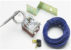

the controller i use is a hayden imperial thermostatic controller whit adjustable temp dial.when using this controller make sure the probe is mounted behind the upper water inlet,when testing the switch select first at 1/4 turn clockwise then make the adjustment until your desire fan kick point.cover the part that will pass the radiator fins to prevent false readings it can be cober with a dap of silicone or a rubber plug.
the controller is availabe in advance auto parts
part number . 226203
price $18.69
Attached Thumbnails mercury villager electric fan swap-hayden-imperial-226203.png
