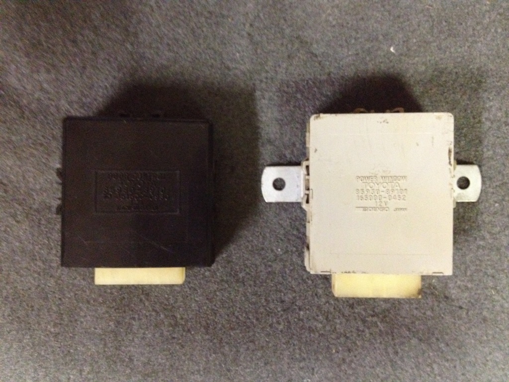

Don't forget the Door Lock Control Relay. http://web.archive.org/web/201106261.../8powerdoo.pdf You could probably hook up something without the Control Relay, but it does a lot of stuff you'll probably want.

The link I gave you gives all the lock wiring. The window wiring is all inside the door: http://web.archive.org/web/201102052.../7powerwin.pdf (the door lock relay provides the time delay so you can roll up the windows with key-off).
I will say that this wiring is not for the faint-of-heart. The Control Relay alone connects with a 14-pin connector, and each of those wires has to end up in the right place.

You can do a "basic" wiring, but you lose convenience items like the time delay after key-off to roll up the windows. You could, for instance, keep the windows powered all the time.
But you'd want to be better than average at wiring to do this, particularly since you'll be making up a bunch of connectors (and no, you don't want ScotchLoks for that). It's good to know your own limitations, but don't be afraid to stretch a little.

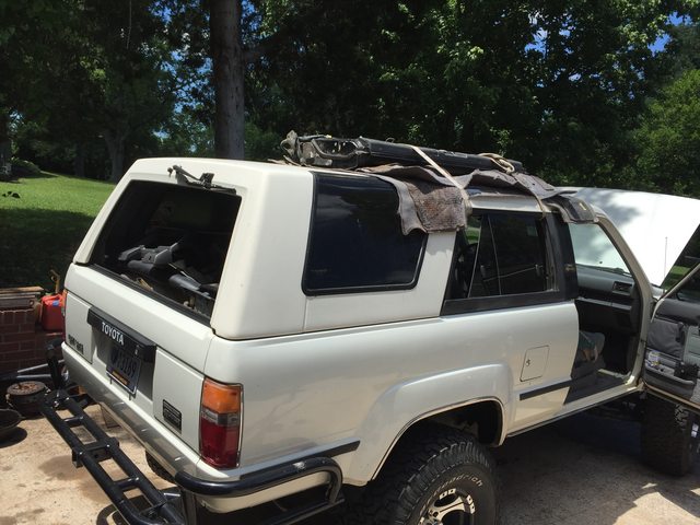

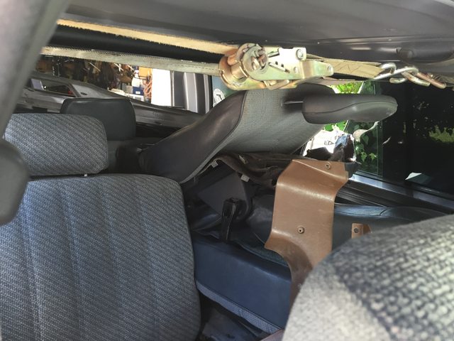

I got everything, and i mean everything out of the donor truck. I tried getting the entire wiring harness, but couldnt get it out of the dash. So I just cut the wires that come out of the main harness, so I would have some room to work with, and the male and female plugs on the driver and passenger door. I also got the grommets for sealing the doors. I also got the door control relay box and the male plug for it too.

He had a fully furnished 1988 SR5 with all available options, my buddy and I came and stripped the entire interior (his truck is bare with no panels carpets or seats.) I kept the fancy multi adjustable SR5 seats, gave my buddy my seats and now hes got a fully furnished truck. Im going to swap to auto windows and locks and he will get my front panels too.

I stripped down a parts truck a couple years ago (88 SR5) and I ended up with both a door lock controller and a power window controller. Not sure if you are going to need both or if the window controller I have is the one for the back window.

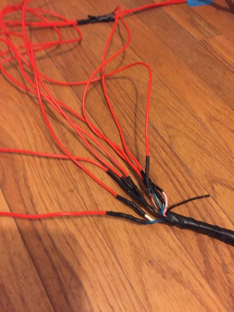

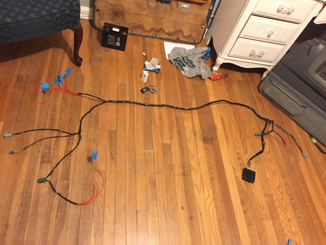

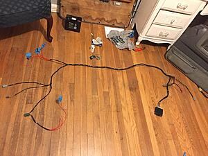

It actually went pretty well. I created my own wiring harness using the power window control box. I got the male and female ends of each plug and the entire wiring harness except what was behind the dash. Once I made the harness, I pulled my dash and then ran the wires.
After that I had to dril holes in my doors and my 4runner to run the wires, and then hook it all up. I could not figure out how to get to the "power window CB" and Ignition fuse, and i dont have the power lock CB to begin with, so I ended up running those three power wires into a 20 AMP circuit breaker. I dont think the windows or locks draw all too much power to begin with. Heres some photos:
yeah i used all red wire...
I didnt take any pics of ripping my dash apart, its pretty self explanitory. Eventually Ill need to figure out a better way to power it, but it works now.
Heres it all working
Nice work! The red wire is fine. You can drop $200,000 on a new Peterbilt and every wire in it will be white. They shouldn't draw all that much current. I know that the pre 1988 GM trucks had theirs wired straight through the switches. As years went on most of them got weak due to corrosion and wear so at least one company produced a kit to wire them up through relays. My boss just installed one of these kits in his 87 the other day and he said it took him about an hour to do it. The windows work a whole lot better now. Not sure what it costs. He wouldn't have done it if it was much but that might be something to google search if you have trouble with yours.

DO make a clear diagram of how you hooked everything up. It all seems pretty straight-forward now, but you made some decisions and you will forget them very quickly.
The door/window fuse is 30amps. That probably covers running both windows at the same time, so you may be okay with a 20amp breaker. But no need to guess: just stick your ammeter in the circuit and let us all know! (Oh -- your multimeter only goes up to 10amps? Well, maybe this will help: http://www.harborfreight.com/30-amp-...ter-67724.html)

Basically all of the wiring is completely wired stock, with the exception of these wires here all going to the same power wire, protected by a 20 amp CB.
