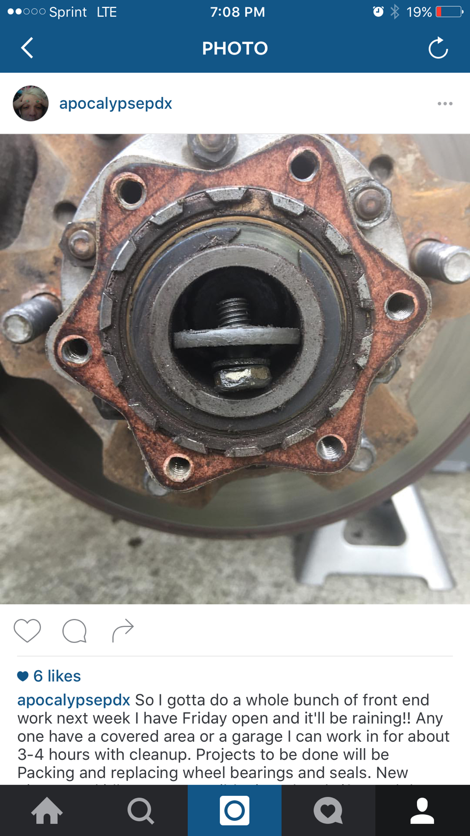

Originally Posted by punks_is_4x4
My 54 mm but was torqued down hard took a big breaker bar but the little 12 mm but was just sittin in the hub assembly I have a pic somewhere
ive heard that about one of the nuts is a bitch and the other one is just loose. hummmm
i have a 1/2 breaker bar probably need something else for the 54mm
Old Apr 19, 2016 | 06:10 PM
  #22
punks_is_4x4's Avatar
Joined: Apr 2014
Posts: 396
From: Portland Oregon
hehehehehehehehehehe
Old Apr 19, 2016 | 06:13 PM
  #24
Joined: Apr 2014
Posts: 396
The 1/2 will be fine I just had to get a ton of leverage on of my breaker bar is like 2 feet log and I had to put a piece of 2" tubing on it to get more leverage

If your wheel is moving up and down that's probably ball joints. Side to side could be a loose axle nut (54mm) or tierod end. Your cv should have some play I believe. Do you have Locking hubs or auto?
manual locking
Old Apr 19, 2016 | 06:19 PM
  #28
an1176's Avatar
Joined: Apr 2015
Posts: 135
Do you know how to take your hub apart?
Yes i took them apart enough to repack grease and replace a bent gear.
Old Apr 19, 2016 | 06:27 PM
  #31
an1176's Avatar
Joined: Apr 2015
Posts: 135
When you take the hub apart there is 12mm bolt to take off just past that is a 54mm nut. It should be held on by a locking washer that'll have tabs that you can bend. If that nut is loose it can cause your side to side movement of the wheel.
Old Apr 19, 2016 | 06:28 PM
  #32
an1176's Avatar
Joined: Apr 2015
Posts: 135
You want the 54 mm nut tight as long as you can spin the wheel freely.
