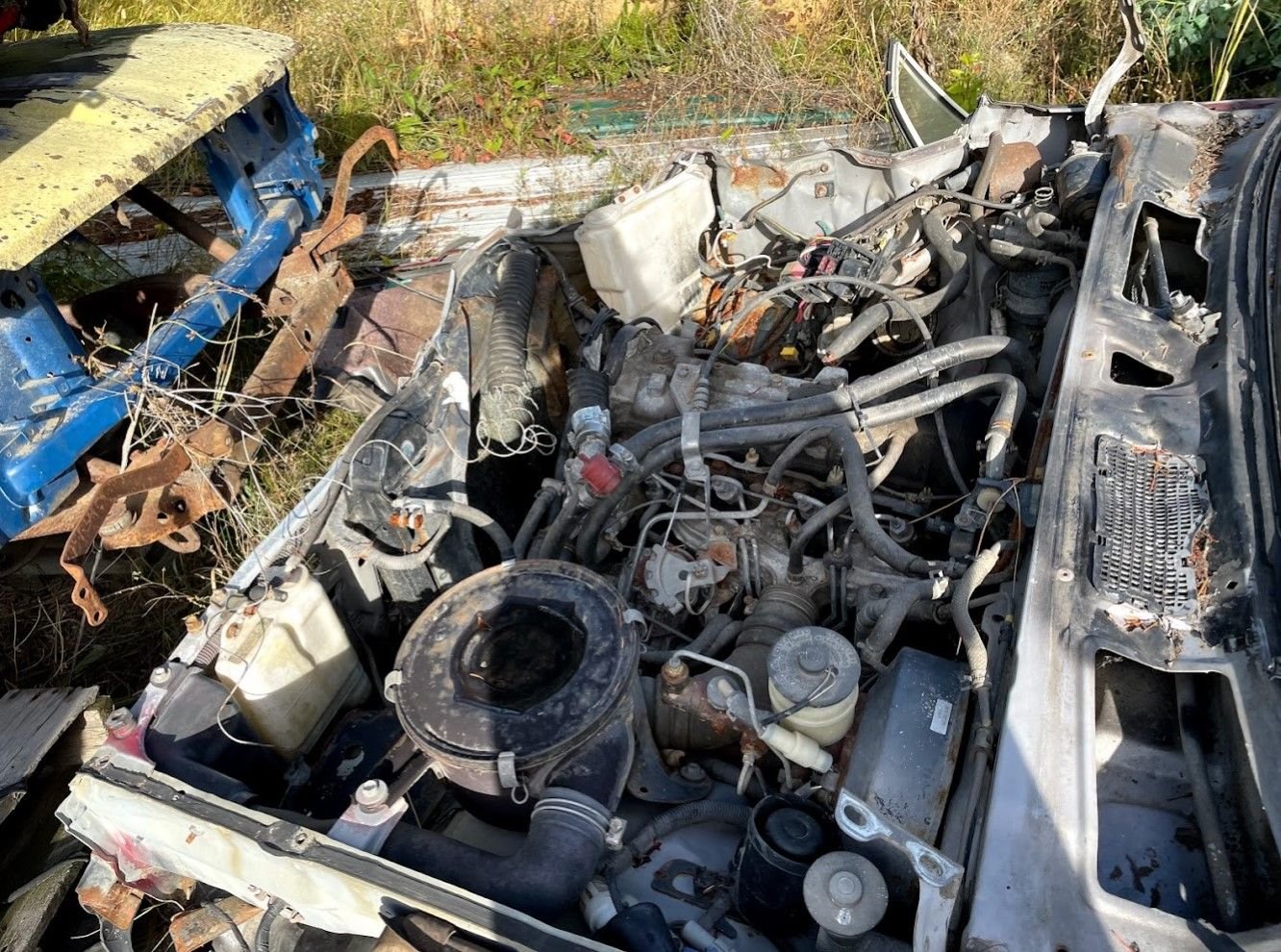

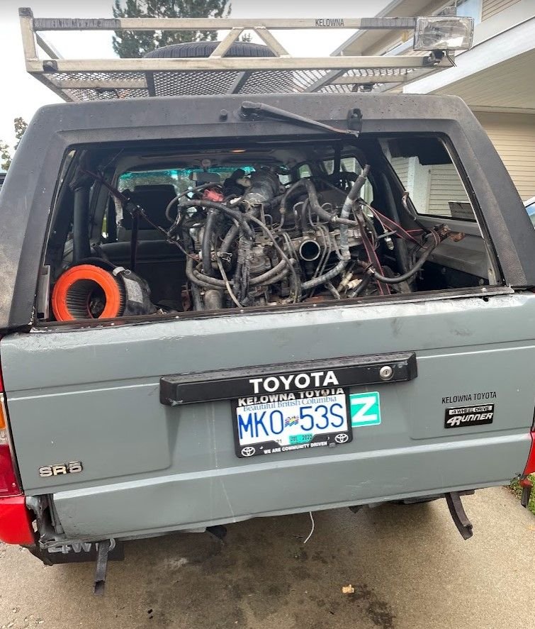

I just picked up a 2.4 2L (non turbo) diesel out of an '84ish 2WD toyota truck. I plan on swapping it into my '86 4runner to replace my worn out 22r.
I was able to pull everything in the engine bay including the fuel filter and what looks to be an external oil filter. I also got the entire truck wiring harness and the bellhousing. I don't know very much about diesels and am looking for any information I can. The truck was running and crashed into a tree, so I know the engine is fine, but I will be pulling the head and taking it to a machine shop.
I am also not sure how I will get the power steering to work as the diesel has the pump and reservoir on the passenger side. Also there is a weird looking pump on the back of the alternator I am also unsure of but it has hoses going into the block like it's some sort of oil pump. Any rebuilding material and diagrams would be nice.

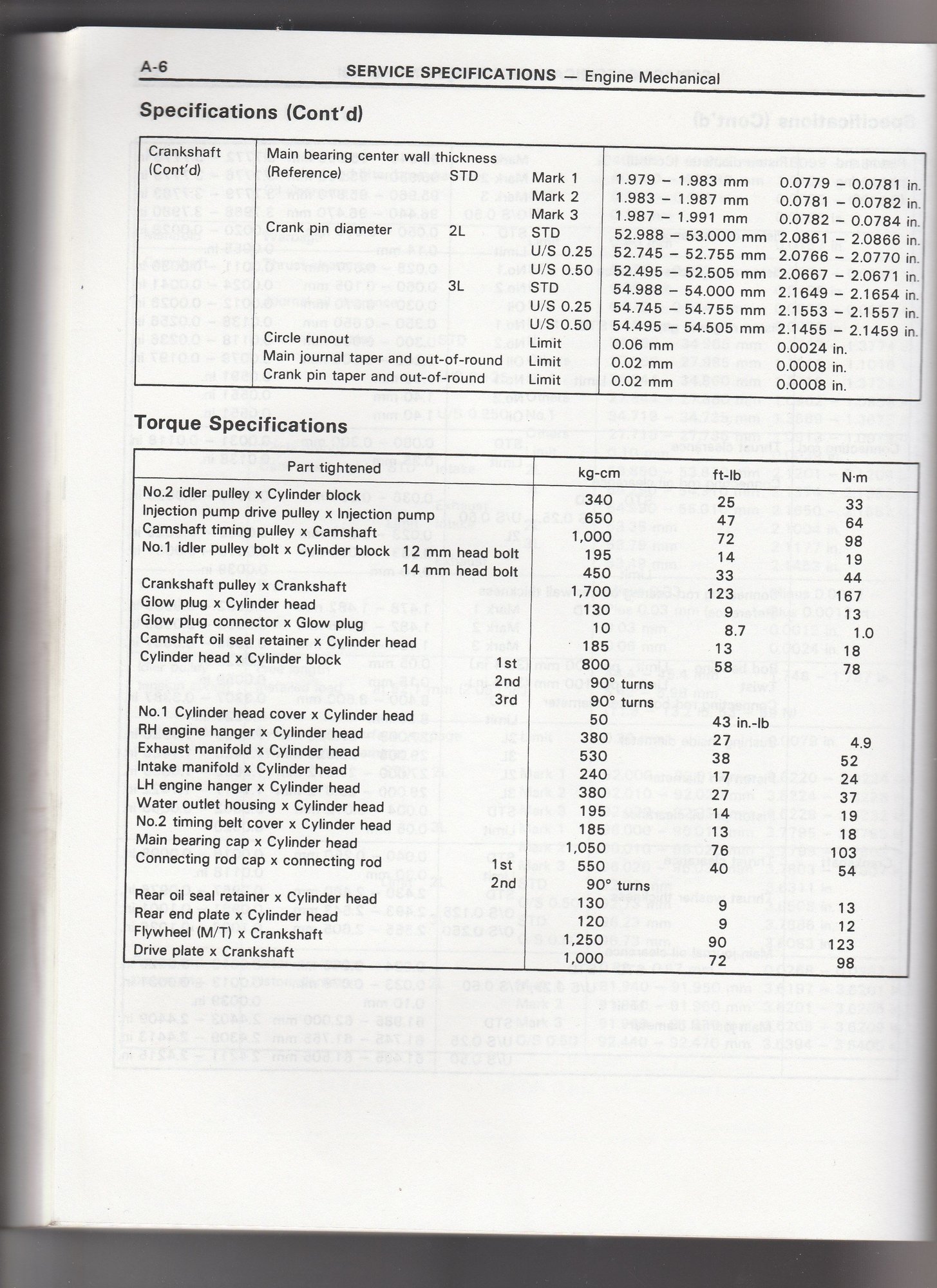

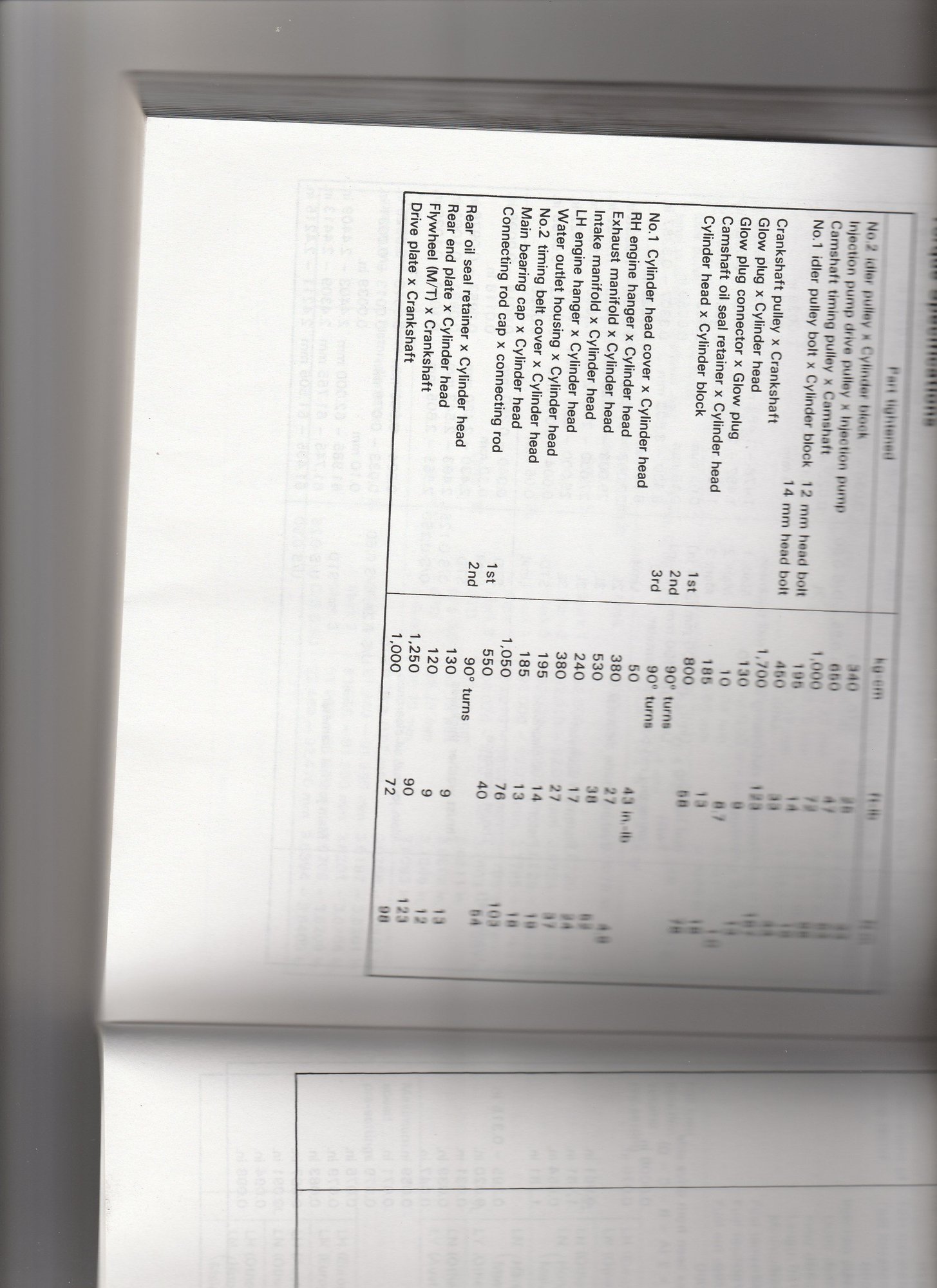

Sweet yeah I was just looking for the diesel line diagram and bolt torque specs for the head and crank and such.

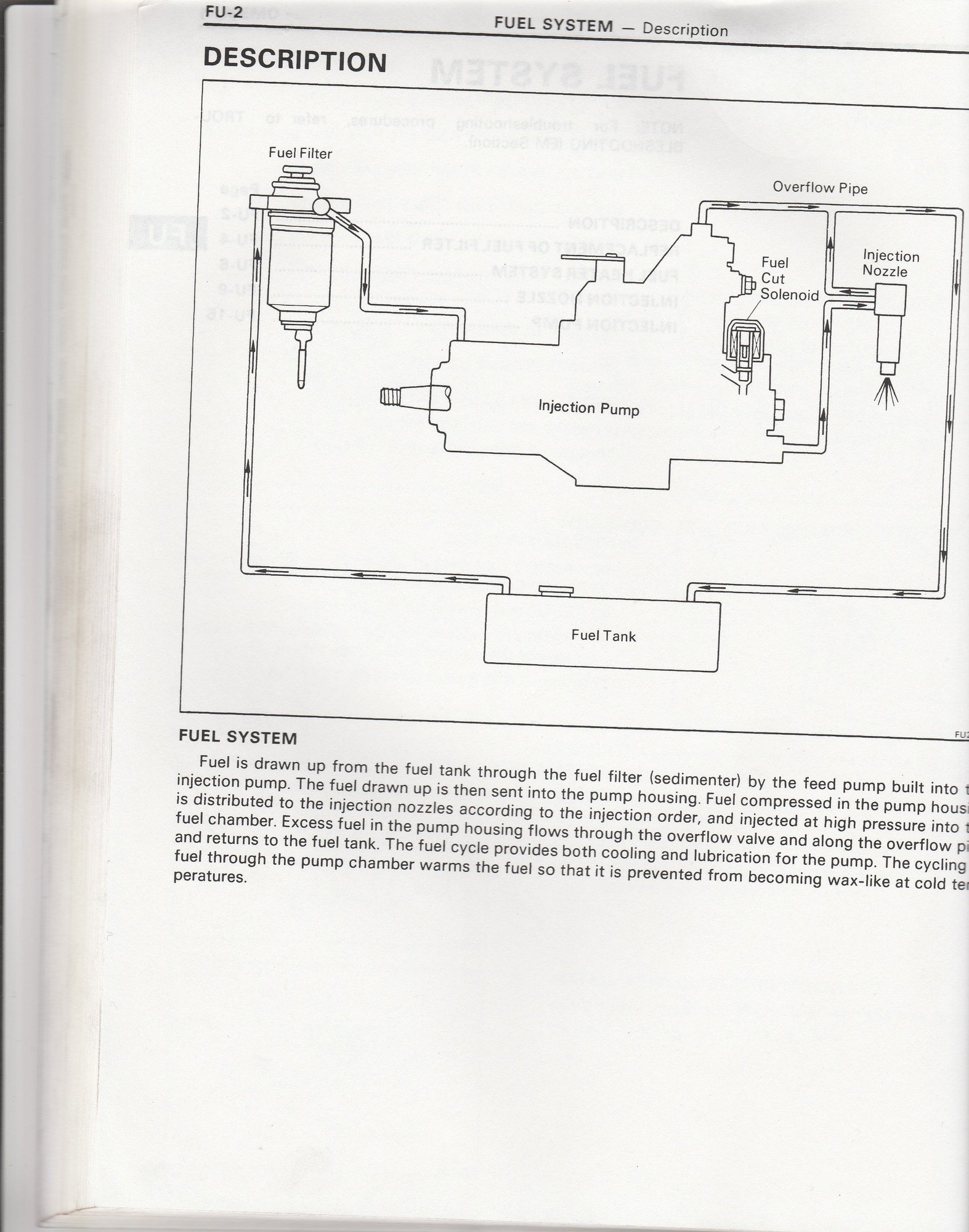

theres 2 lines going into the injector pump and I’m not sure which ones the input and which ones the output. Also would I need a lifter pump for the tank?

fuel line ?
and specs
File Type: pdf

fuel line ?
and specs
awesome thanks. Yes the fuel line. On the injector pump there is a line going into the back of the pump, as well as one on the front.
